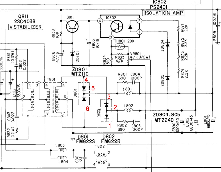

Okay, the diodes tested fine when removed (no shorts)... however the board still has shorts. Been are the readings at the pads of the diodes:
Pads 1-3: 0.4 ohms
Pads 2-3: 0.0 ohms
Pads 1-4: 0.4 ohms
Pads 4-6: 0.4 ohms
Pads 5-6: 0.0 ohms
(Pads X-Y is a pair)
2-3 and 5-6 shouldn't be shorted. Clean the flux off of the board to see if you have a solder bridge between pads.
If I'm not mistaken, the rest are connected through traces or transformer windings so they will read as a short.
Yea, it's messy, but their not connected with a solder bridge. Those were the same pins that were shorted when the diodes were still in place along with another pair of pins (that connect through the transformer).
You could have a shorted rail capacitor. Another possible cause could be a transistor that's shorted to the heatsink. Confirm that no tabs of any audio transistors read anything near 0 ohms to the heatsink.
I'm assuming that you don't have the amp connected to anything.
Nope the PCB is pulled from the amp, and here's the schematic with the pins highlighted, attached. When I measured the diodes, ALL of the audio power transistors were removed, the only ones remaining on the board are: Q507, Q503, Q505, Q508, Q504, Q506, and Q801-810.
I would suggest that you remove the rail caps to eliminate them from the possible causes. The rarely short but there's not much left that could cause a short between those terminals.
That would be E890, E801, and E802 (the last two being the Big 6800uF caps).
