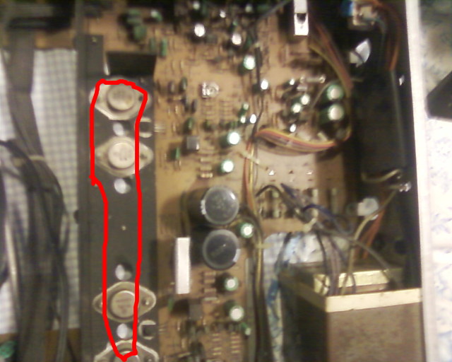

I stand violently corrected, two MJ2955's are present, but the other two are 2N3055's, again, made by Motorola.
The First MJ2955's markings are:
MJ2955
T8748
Motorola Logo
The second MJ2955's markings are:
Motorola Logo
MJ2955
MEXICO
9319
The first 2N3055's markings are:
2N3055
T8747
Motorola Logo
The second 2N3055's markings are:
Motorola Logo
2N3055
MEXICO
9416
I know its alot, but I have a gut feeling that the numbers are in reference to something.
Each one of these four transistors have 4 contacts on their underside.
Im not sure what else could be a transistor, so Ill work faster on getting that photo.

By the way, you were dead wrong about the motorola ones being replaceable by the tip2955's.
Its a 4 solder point transistor that DOESN'T stand.
Im attaching a low definition photo.
The four circles screwed to the board (with one a little out of sight) are the first 4 transistors I identified, but I haven't pointed out two 3 legged transistors, black, screwed inbetween two transistors at a time, 2 total.
EDIT: Gotcha, That was a poor mistake on my end, I need new sodium lamps...>_>
Anyway, You were right, but would I really replace something as big as the ones I have now with the small little 3 legged device?
Hi Alex,
You replace like for like, possibly using equivalents, but always in the same package (for outputs anyway).
As I say, the meter is essential, don't try swapping parts without knowing what you are doing.
I have just seen your new post. Look at the link I gave. The screws are the collector terminal and the devices will be insulated from the metal heatsink by insulating washers.
You need to calm down and listen and learn if you are to stand any chance of fixing it.

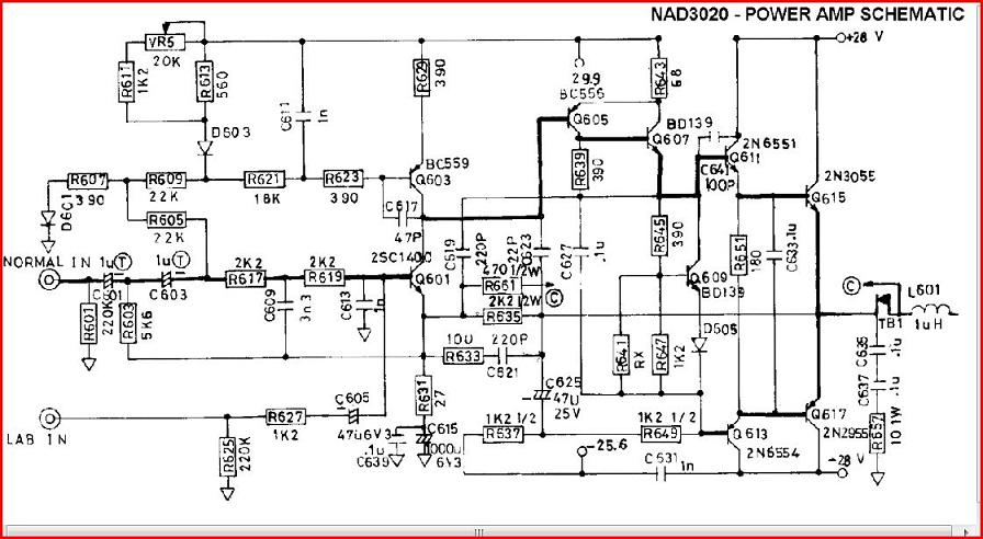

I have the same problem on my nad 3130.
"some darkening of the PCB around Q504, Which is running hot but not beyond what I can touch you without burning".
The power supply voltages are of (-34,8V) on the collector of Q504 and (+ 40,3V) on the collector of Q501. On emitters, we measure the following two output voltages: (-26,2V) on Q504 and (+ 36,2V) at the collector of Q501. There is a difference of 10 V.
It's normal? I don't find,on the net, a diagram shows the values of voltage, can you help?
We would need to see the circuit to make an informed decision on what you are seeing. If its all working then there can't be much (if anything) actually wrong. Darkening of PCB's (particularly paxolin type) is very common and unavoidable where there is local heat produced. So normal in other words.
