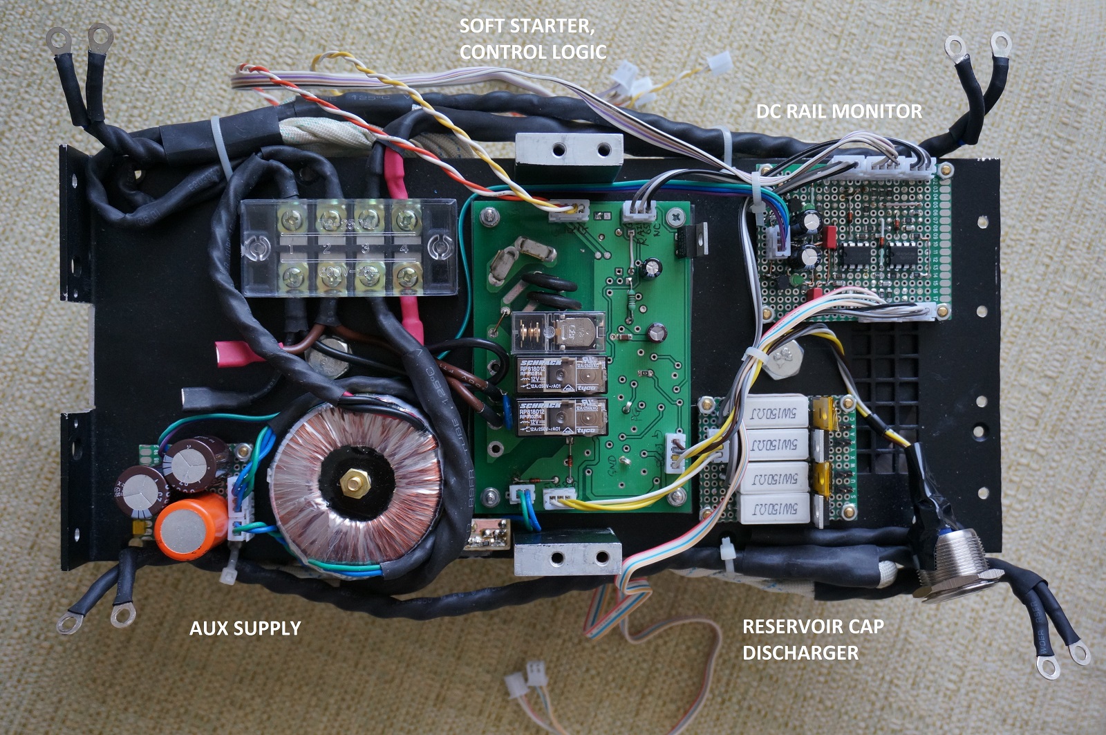

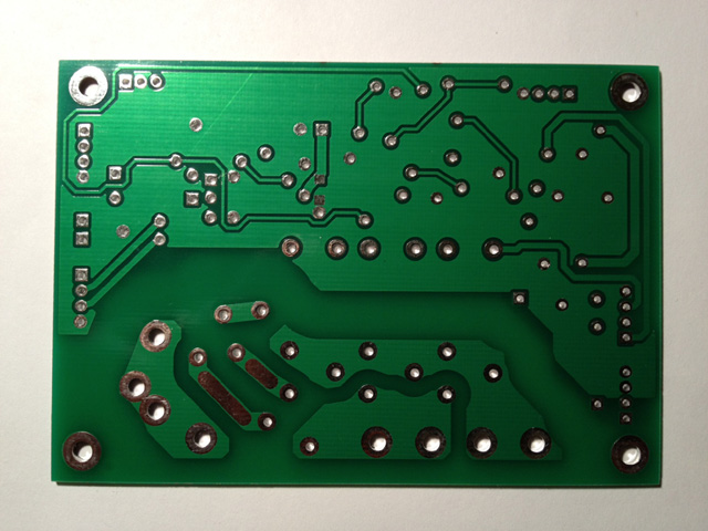

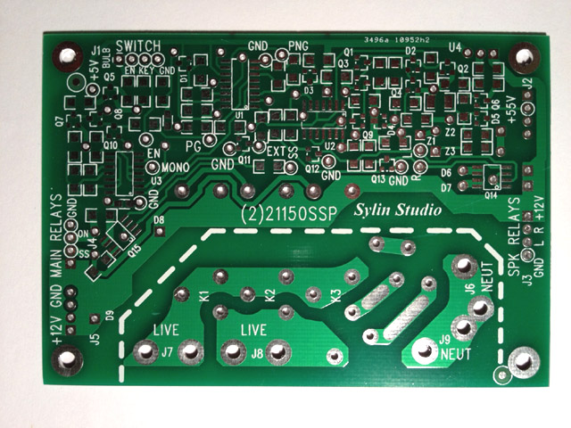

Schematic diagram and pictures of PCB are attached. Unfortunately I lost the pictures of PCB with populated parts on. Pictures of the installed PCB in my amp can be found at the link below:
http://www.diyaudio.com/forums/solid-state/170892-i-pimped-my-citation-sixteen-resurrected.html

The PCB size is 100mm X 69.5mm and should yield quite well in a 18"X24" panel for 32 pieces.

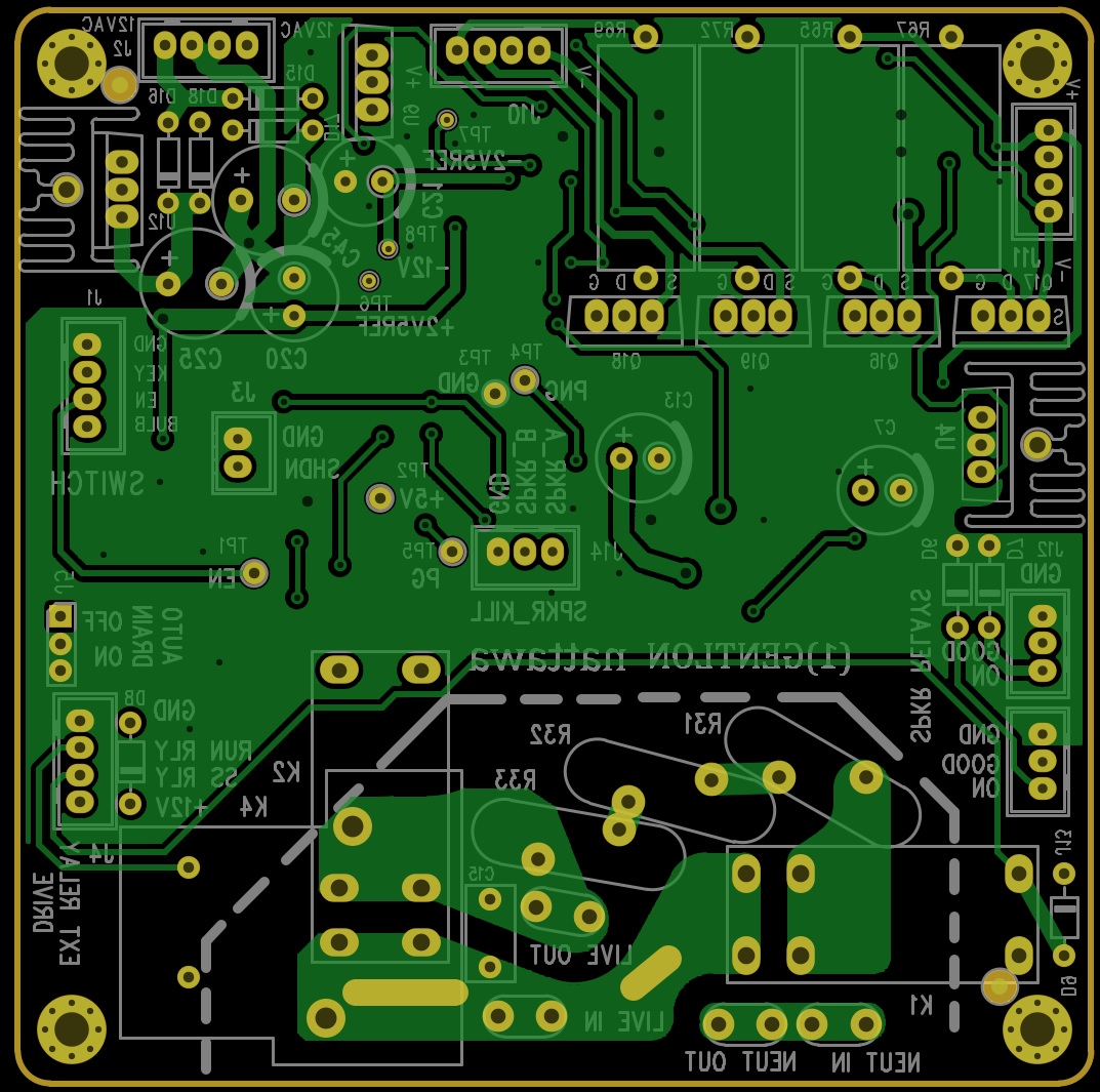

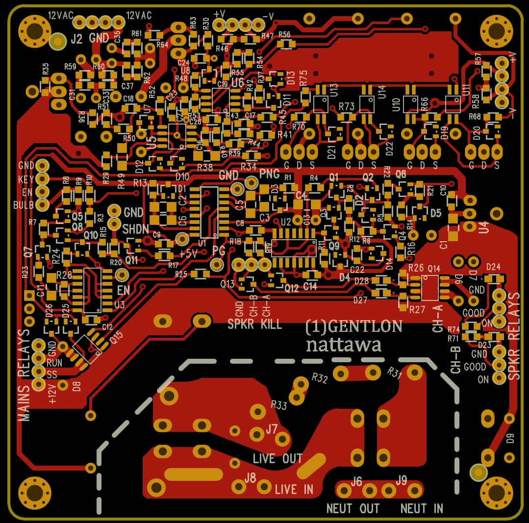

After a few successful builds and trouble-free operation for a few years, I decided to revise the PCB to include its own PSU, 4-channel DC rail monitor, two each positive and negative, and a 4-channel reservoir cap automatic discharger. It has headers to accept external power shutdown and speaker shutdown override controls too. Basically what are on the 4 PCBs in the Meistersinger amp, shown in the last post, now are on one PCB. The board is now 10x10 cm^2, still qualified at many PCB shops for least expensive prototype pricing.
GENTLON schematic and layout
Layout is done on a double sided PCB, all SMD components on one side, and all through-hole parts on the other. Stacking with an additional board will be easy for additional sensory or control circuit.
