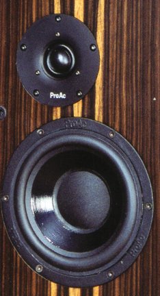

Another Cloner's Journey
The R2.5s were my first DIY loudspeaker project and I have spent about a year tweaking, testing and listening to them. I have learned a lot along the way, not least, that everyone has different opinions and that you can read DIYaudio.com all day but in the end you really have build/modify and listen for yourself. So here are my (much condensed) experiences with the clone:
I originally built the clones according to ALM's website instructions on
http://www.geocities.com/diyproac25/
using the crossover with the notch filter
http://www.geocities.com/diyproac25/images/Jacq_Troels.gif
After the initial euphoria of hearing noises from boxes that I had built myself, I had to admit that other than some spectacular bass on certain recordings the sound left a lot to be desired. The bass was boomy, the treble spiky and the mid somewhat variable depending on the program material. The thing which really killed them for me was on the intro to the 2nd track on the Chilli Peppers latest album the two guitars playing were merged into a tuneless one. At his point I was ready to sell the damned things as some sort of bad joke.
Experiment 1 was to play around with the amount and density of the dacron stuffing, too much deadened the sound and too little gave a boomy and echoey effect. Experiment 2 was to disconnect the notch filter - this was a major step forward, the timing improved dramatically, the Chilli Peppers started to play their own instruments, but as many have found, the sound was rather
tiring with excessive zing in the upper mids and sibilance in the treble.
Experiment 3 - I tried all the different crossover designs I could find (except the series ones) and eventually decided that the Chinese one was the best. After a while I grew even more tired of the shortcomings of the speaker and decided they would definitely be sold. I also heard some Proac Response 4.2s (I think) at a hi-fi show and they were so lacking in coherence
that I doubted Stuart Tyler posseses a pair of ears. Since then I have heard some R1.5s in a domestic environment and they were rather good so maybe Tyler was just having an off-day with the 4.2s.
Experiment 4. Then I read Troel's paper about the modified drive units and decided it was kill or cure time. I waited about 6 weeks to get the right brand of Damar varnish and eventually got the stuff, modded the drive units and changed to V6.1 or the crossover. This was the first time that I could honestly say that they were better than my £1K commercial speakers.
Experiment 5. Many people said the clones are not good enough to justify better crossover components so I ordered some Mills resistors and Sonicaps to replace the Solens and ceramic cased resistors. The Mills resistors went in first with a noticeable reduction is graininess and increase in detail.
The Sonicaps seemed a bit soggy sounding at first, since they were in the treble section this surprised me. Maybe they took some time to run-in but I had to swop them in and out a couple of times over a period of a few weeks to be sure they were an improvement, eventually and with a few other changes to
the system there is no doubt in my mind they are a lot better than the Solens. In fact I would go so far as to say that the clones are not worth building
without them.
Experiment 6. Al.M's website states that the stuffing is critical to the sound of the clone, since I now had a "TroelAc" not a Proac clone I decided to try some profiled acoustic foam instead of the Dacron. It took me about 2 minutes to decide this was a bad, bad move. If you like boomy bass and dull mids this is way to go!
I have also dabbled with port tuning and seem to prefer a slightly longer port than the recommended one.
I feel like I have been fiddling with these speakers for ever and I've still got to try different internal cable and the effects of adding bracing (probably by clamping the outside of the box - is this a valid method for assessment?).
So overall these speakers are tuned for my tastes, room and system, but surely that's the whole point of DIY. Finally I now feel that the description on AlMs website "very musical, sweet, coherent, tuneful, lush, and with a very bullet proof bass (for its size)" is appropriate.
Strengths:
Coherent, detailed, tuneful, good microdynamics, deep and tuneful bass, neutral.
Weaknesses:
Occassional slightly loose bass (I've never heard an open ported speaker that does not suffer this), treble could use more "air", cannot play really loud, macrodynamics a bit limited.
For what they cost in materials these are a really excellent pair of speakers, OTOH if time is money....Hmmmm best not think about that one too much.
