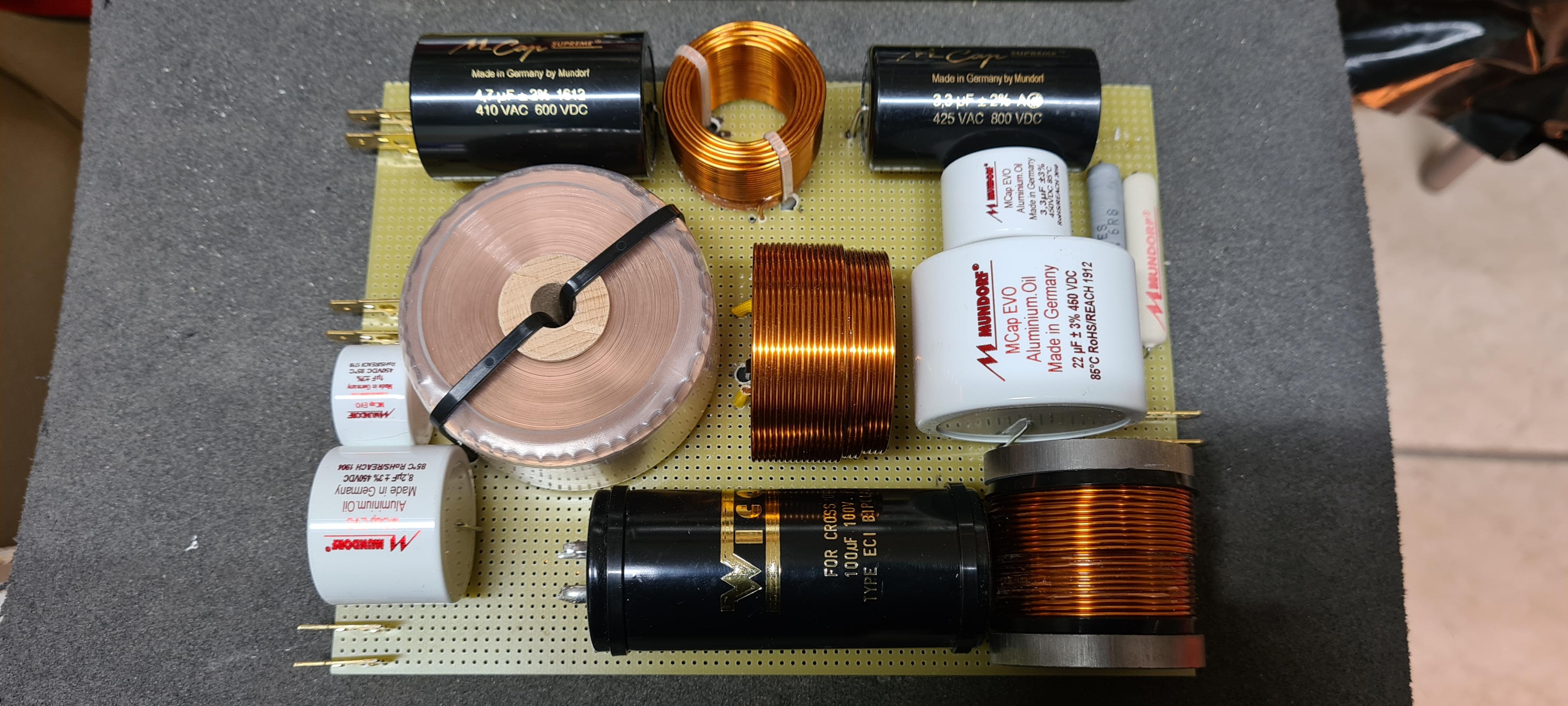

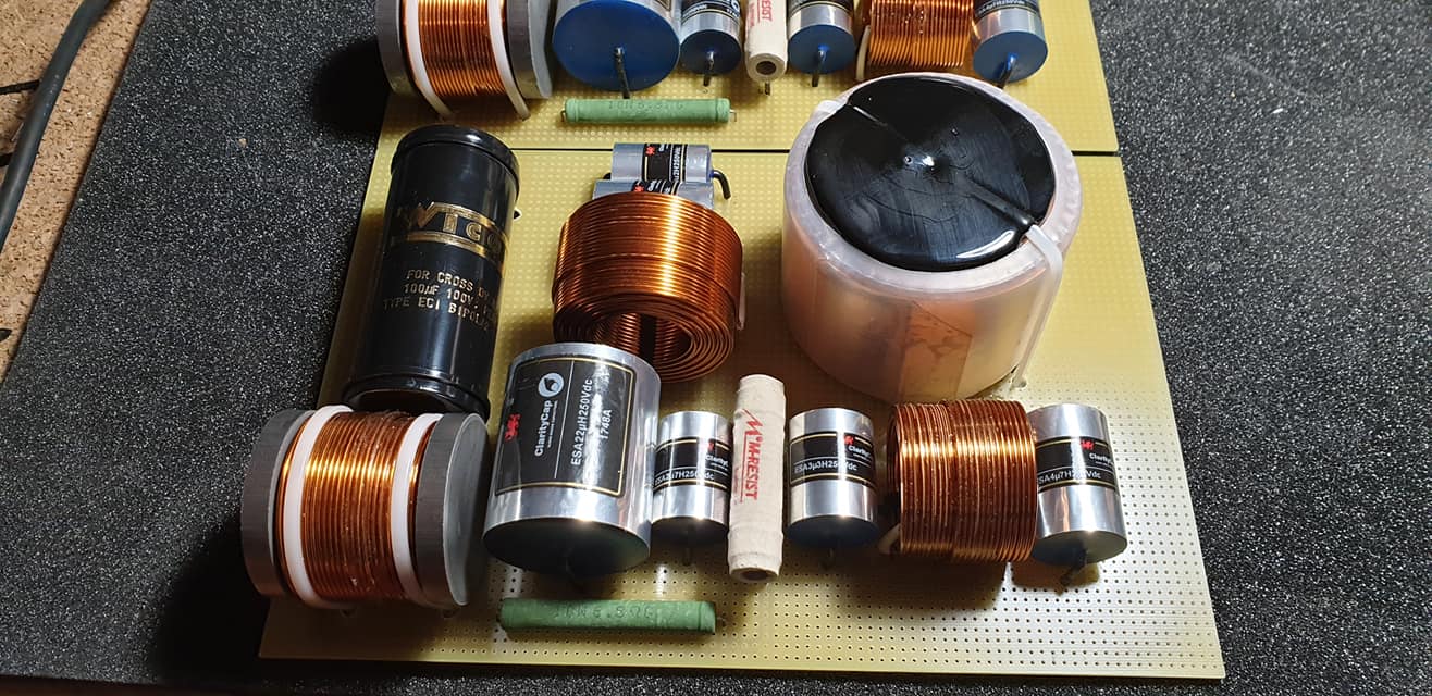

Any perceived improvements after crossover updates on your Proac EBS ? Mine has standard 75V SCR caps . Since Proac is notorious for using Mylar caps in its Response line I'm not sure there is much sense in a change but I'll listen to sugestions. Also what amps do you use?
that are two version of a crossover upgrade for PROAC EBS made by me for two friends...
the results are very very good!
