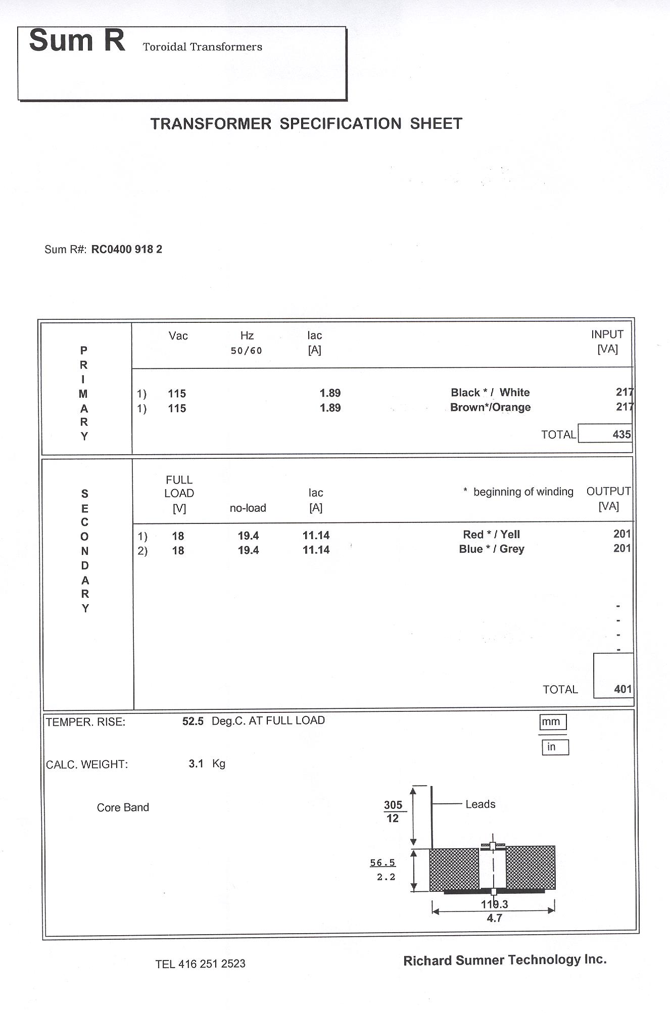

Thanks! Interesting - same dimensions +/- encapsulation. Was expecting the fully encapsulated version to be somewhat larger.
I use SumR encapsulated trafos for headphone amps (need quiet) and they are great. My understanding is that as a final step they go into a polymer can that gets filled with liquid epoxy and cured solid.

Looks good. I'd be up for the RC0400 922 4, but with dual primaries. Almost hard to believe those dimensions though.
Antek with similar specs is 125mm x 79mm, non-potted.
SumR with similar specs is 135mm x 70mm with potted and 120mm x 58mm without.
Can you verify one more time the dimensions?
Maybe SumR uses higher quality steel core which enable smaller dimensions.

So what is the ordering time frame for these transformers? What is the manufacture lead time?
Do the encapsulated ones have full steel covers with mounting hardware?
When asked the question, this is what Richard said.
I like the idea of a single primary for no other reason than wire count, but it has to be specified up front.
The 50Hz group of 230Vprimary, may want a single primary. This is the group I was referring to.
However, if your North Americans want a single primary, now is the time. ( either 117V primary or 120V primary @ 60 Hz).
Richard
Guess I missed that memo, sorry. I'm fine with the conventional 60Hz, 115/230 primary, thanks. Better to have more flexibility in case I ever "re-purpose" the transformer (chuckle).
It wasn't posted before. I just wanted to post his exact response, as I had just asked him the question.
Pardon me for the newbie question - what are the differences (in terms of performances or otherwise) between a single and a dual primary, apart from less wires to deal with?
Thanks!
In theory, there would be a small difference in the number of wire turns. Basically, it is SUPPOSED to be the AC voltage required to produce the nominal output @ specified load. So, (again in theory only), a transformer which can produce the specified output at a lower input voltage (115 or 117) would have been rated more conservatively than one which requires the input AC voltage to be 120 for the same output.Is there a difference between 117v and 120v primary?
In practice, if you do your own testing, your results may not reflect the manufacturer's specifications, and for DIY audio, it may be pretty meaningless.
For something like an industrial/commercial product, it may be critically important. For example, you may want to know that your product will function when the customer who purchased it switched to emergency power to keep a line running, or shut it down in orderly fashion. In high speed offset printing, one sagging power supply could cause a $50,000 loss on a single line (something that has actually happened). On a rolling mill, it could kill an operator.
