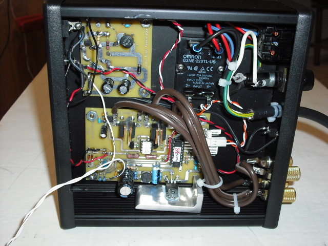

nigel I read your document very good. That means my design it is using option 3 by controlling the firing angle of the wave cycle.
Tried it in my FM tube tuner and no bright filament when switching it ON. It is was smooth in the turn on.

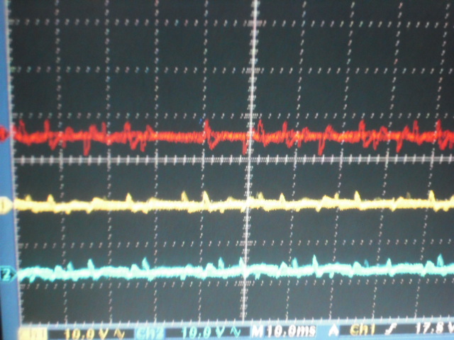

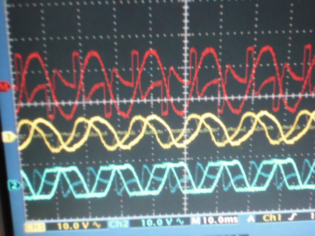

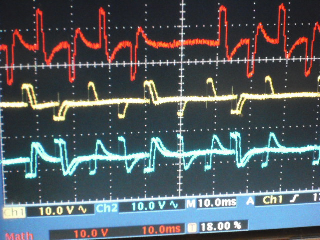

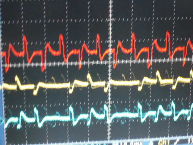

Also I have new better pictures of the toroid secondary output voltages. the last one I forget to zero the 2 input probes and didn't looked to good.

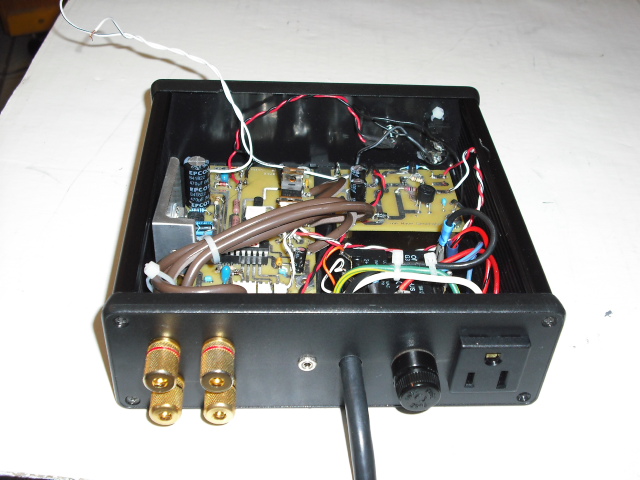

Also I implement the zero crossing to my stand alone speaker protection to switch ON/OFF the amplifier plus monitor the current output to the speakers. If the current it is too high it will open the speaker SSR and shutdown the amplifier.
Attached are the picture for the voltage waves signal when switching ON/OFF the toroidal transformer.

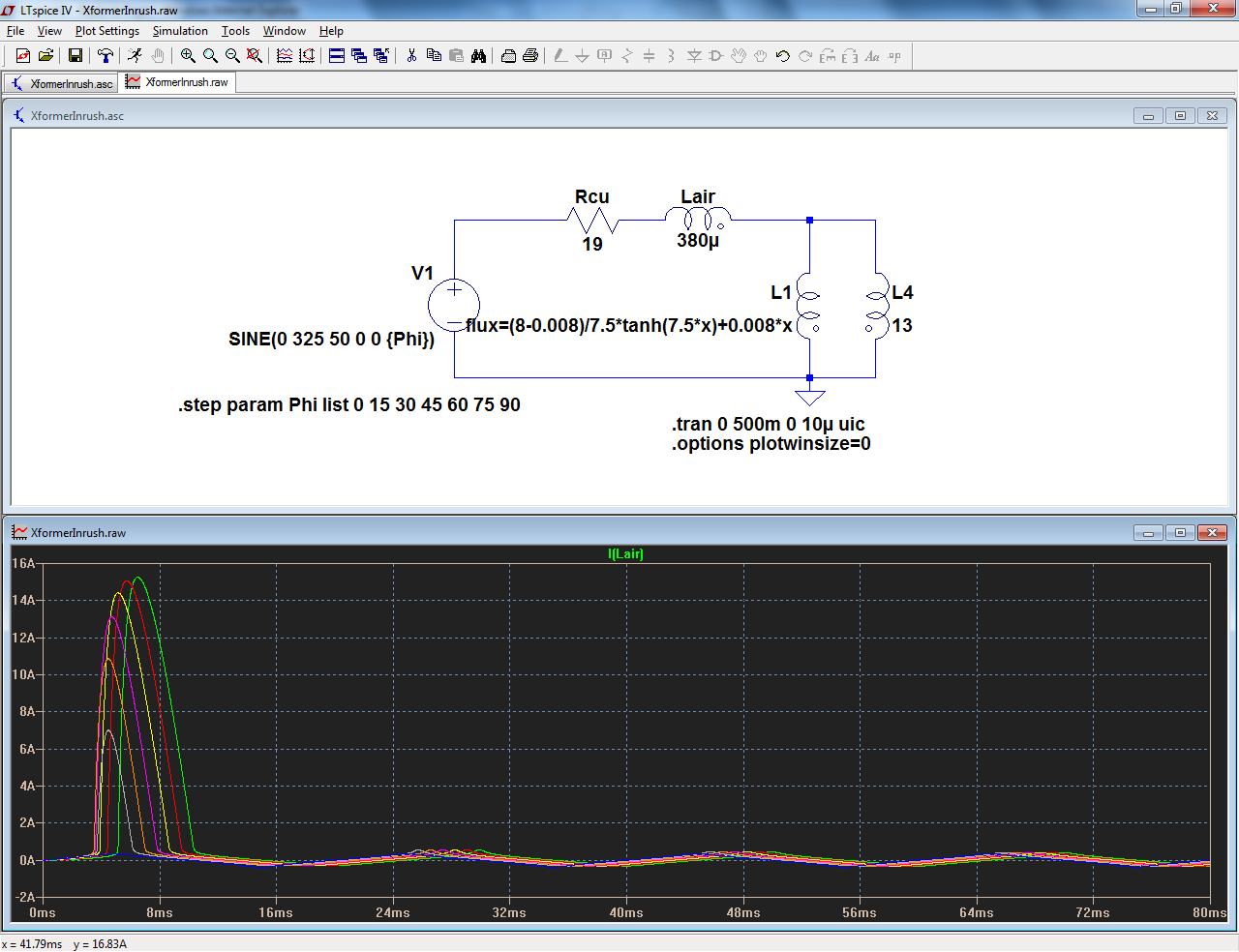

Here is a simulation for a typical, minimally designed 230V 100VA toroidal transformer (unloaded).
First, the starting angle of the voltage waveform is varied from 0° (green trace) to 90° (blue trace).
Next, the starting angles are varied from 90° (green) to 165° (gray)
And finally, the explanation with the two extremes:
The core sees the area subtended by the red sinewave. When the waveform starts at 90°, it only sees the yellow area, and then it reverses.
But when the waveform starts at 0°, it has to endure the whole pink area before being allowed to "breathe": it saturates quickly after 90°.
