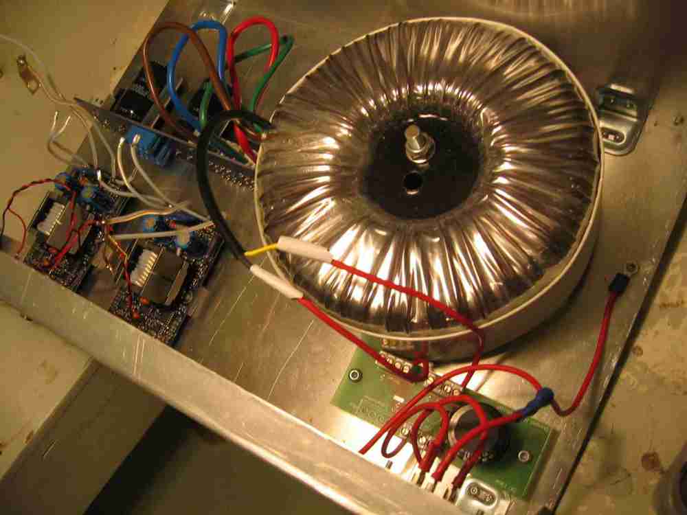

Hi everyone I bought a kit from LC Audio a year ago. Built the amplifier and when I powered it up one module worked and played music, the other one... dead. When I turned up the volume the first one died as well...
After this I kind of gave up. Until now.
When I measure the Predator I get:
+ to ground: 62.xx V
- to gound: 00.00 V
+ to - : 62.xx V
Here are some pictures I have taken. Check out the ground from wall marked with red. Is this right? I have used this to build (pluss more) http://www.lcaudio.dk/zp2iv.pdf

I found out that a small component one the predator is shot. I don't know what it is called, but it is 8 small barrels that is connected at the top two and two. One of these connections is missing. If someone know what it is called and what values it has I would appreciate it alot.
Is there any chance of saving the module by changing the damaged component or is it likely that more stuff is broken?
