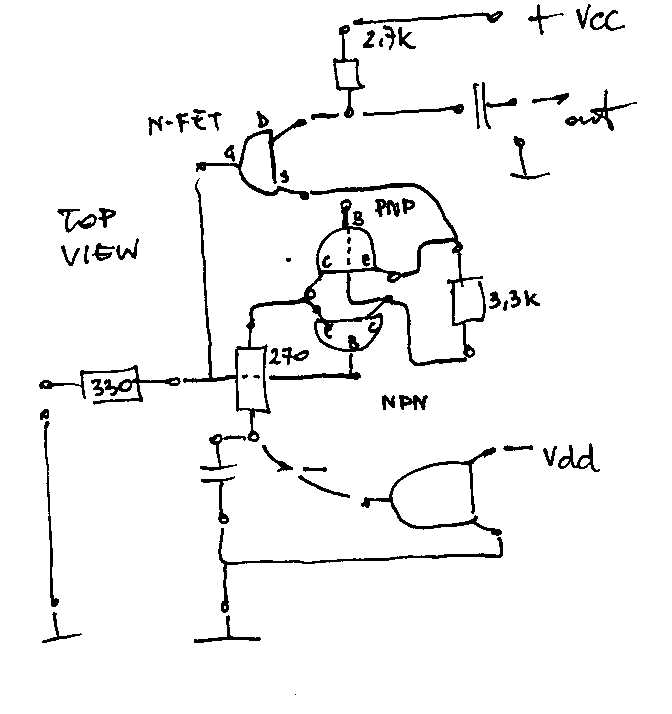

William,
I could not see from your sketch the joints and wires.
the circuit should look similar to attached by me (sight from top).
if your circuit is built good and you still got clipping (I cannot find the reason?) you shoud use +30V voltage supply and regulate +16V at the drain of the fet.
The circuit is built on stripboard, with the strips running across from left to right as you view the drawing. Straight vertical lines are jumpers.
I will examine your layout closely and see if there is anything different. I already upped the voltage from 16.8 to 21v without any change in behaviour.
I am thinking that the clipping is coming from my active crossover (which runs from a single rail 14v supply). Perhaps because this design was producing more bass than the opamp, clipping was setting in at a lower setting of the attenuator. I have been experimenting with a bunch of different gain settings today and it does also clip with the opamp - just at a higher input level. I have different chips I can try in the crossover - perhaps that will improve things a bit. Ultimately, I think I will have to build a decent active crossover, and that will probably solve my problem as well as improve the sound.
