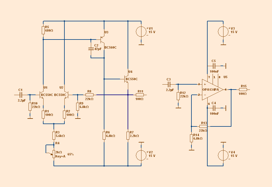

I am a currently trying to design and build a preamplifier through out the summer. I saw that there are lots of information that Douglas Self provides but they are really complicated and would take me longer than the summer which i have available.
I need to know that best pre amplifier that i could build in the alotted time period that i have ( this summer i.e. now till september 2). This pre amp should not be too simple yet not at complicated. I am fairly new to preamplifier topologies since i know that there are know integrated amplifiers. I really hope that someone could be of help to me. If there are any additional information that i should make available let me know so i could reply immediately.

You can start by making a power supply suited for preamp.
+/-15 VDC can easily be made with
one transformer 2x15 VAC, say 10 VA (a rather small trafo)
one positive 15v regulator: LM7815
one negative 15v regulator: LM7915
They both have 3 pins: in, out,ground
If you have a well regulated +/-15 volt power supply
then it is easier to build a good and fairly basic preamplifier.
For example using resistors instead of current sources.
I get it, you do not want the IC way. You think of transistors.
Because for example opamp OPA2134 is a dead simple way to get a good preamp.
Here you have 2 different ways.
1. Discrete opamp with 4 small transistors.
2. One opamp OPA134
Both have equal gain around x4.
22k/6.8k + 1 gives x4.23
OPA134 has a little bit lower THD distortion.
But both have performance very low distortion.
The transistor opamp should be more fun to build.

They are line preamps.
They should take sources, like CD-players, mp3 players etc,
and give a moderate gain x4.2
and drive any power amplifiers from the output.
I have added one 100 Ohm resistor, so the output impedance is like 100 Ohm
The input impedance is the 22 kOhm resistor.
Can be changed to 47 kOhm or whatever.

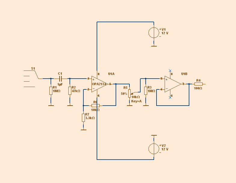

Thank you sooo much and may the Gods bless u. I have three questions ( hope im not over doing it : )
How well is the Signal to Noise ratio?
Whats the diiference (if any) between a line pre amp and the usual pre amp
Can the circuit be adjusted accordinglly ( i was thinking of having a selector switch so diffent signals to be proccessed by first :
-Using the selector switch to select the type of source/input signal that is going to be pre amplified .
-When the particular signal is selected, approriate proccessing of the signal could be done e.g. amplification, filtering etc then finally go through the pre amplifing stage befor fedding it to the power amplifier.
This came to mind because in know that different input sources( e.g a mic vs a guitar) would require greater or less (as the case may be) gain levels for pre amplification. Would the gain of 4.2 work on any source signal ?
If not could the selector switch technic could actually be implemented in the design topology?
Mic or guitar might need a special amplifier, and so phono from turntable
BEFORE the switching into the Line amp.
They are called mic.amp and guitar.amp and RIAA.phono.amp
Line amp is more to gather all different sources
and make a little gain if needed
and buffering the signal suitable for power amp.
I have made a more detailed schema here.
Uses a dual 8-pin opamp OPA2134. Two amps in one IC.
A. S1 is a 4 positions rotary switch.
B. Goes to AMP1 to be amplified x4 (+12dB is the usual for Line preamps)
C. Potentiometer is between the AMPS
D. Finally from pot goes to AMP2 which is a buffer with gain x1
This topology is the usual and best.
You can see it here, too: High Quality Audio Preamp
