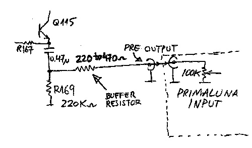

Dear Marcos
This is correct? (according interpret)
Very thanks !
Regards
Rolando
Uploaded with ImageShack.us
Hi Rolando,
220 KOhm I mentioned is the R169. What I previously suggested to you is to put a 220 Ohm (and not 220KOhm) in series with the output, exactly where you draw a 220KOhm resistor.
The 100KOhm value in my calculation is the input resistance of your Primaluna.
This manner, R169 (220KOhm) is in parallel with 100KOhm of Primaluna Input, wich make a hi-pass of about 5Hz with the original 0,47uF output capacitor in your drawing.
No need here to put a large capacitor, because the original 0.47uF is enough for your case, is what I mean.
Marcos

Dear Marcos
Now I'm clear, this extra resistance in the signal path made ​​little sense, so I preferred to consult again.
Now to buy the missing components (I get a transformer for the power, 220 volts Primary, Secondary 50 + 50 Volts and 100 Amp (5 watts) and once made ​​all to produce the circuit boards!
( ecualization RIAA, tone controls and power supply )
Very thanks!!
