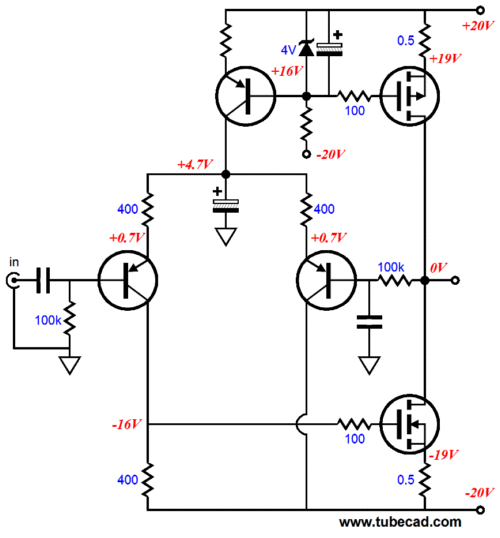

2SK170 LTP and CCS
Hello,
I was wondering if modifying the schematic from post #29 to use 2SK170 for both the LTP and the CCS would be a good idea.
It seems to work on LTSpice as far as I understand what I am simulating but I would like to know your thought about it.
Thanks for helping another newbie
Greg.

Zgregz, if you want to keep those resistor values you'll have to use 2 paralleled JFETs in CCS (J3) to produce 20mA. J1 and J2 should have Idss of about 12mA each and J3a and J3b should have Idss=10mA each.
Some JFETs are made symmetric but still I'd put Gate and Source (not the Drain) together on the -U rail.
Watch the Pd of J3a and J3b (18V x 10mA = 180mW). I'd use a 680R resistor in the Drain (upper) branch to lower the dissipation.
Anyway, the CCS from post #29 will work better than 2 paralleled JFETs....
Thanks Juma!
I didn't think about power dissipation!
It may be a better idea for a newbie like me to use the CCS from post #29.
I have a bunch of 2SK170BL and some ZTX, but no BD139, is there a suitable alternative to the BD139 in the CCS? I have some D44h11, can I use these instead of the BD139?
Thanks again,
Greg.
D44 is in higher power class but you can use it. BD139 is a useful BJT you should get some:
BD139 - STMICROELECTRONICS - TRANSISTOR NPN TO-126 | Farnell France
