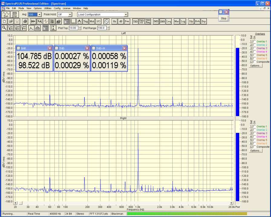

syn08 said:
In single ended is much worse, but still acceptable for the DIYer.
Same card, same everything, in single ended mode. It pretty much sucks. Note the 60Hz harmonics, the channels asymmetry and the S/N ratio plunging down.

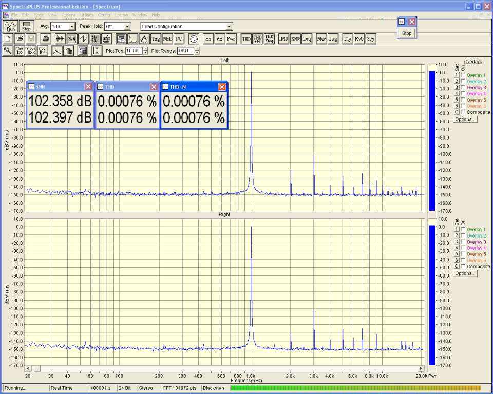

syn08 said:
Here's what EMU 1212M can do in balanced mode. In single ended is much worse, but still acceptable for the DIYer.
Thanks for that measurement! I was planning to purchase an ESI Juli@, but the EMU card seems to be a better choice in the same price range, maybe (except for the 48kHz restriction, but I haven't checked that for the Juli@ )
- Klaus
- Klaus
You are welcomed. Again, the limitation applies only for the internal loop (which you shouldn't use, anyway); you can use 192KHz to analyze an external signal.
KSTR said:
Definitely. But we can agree it's pretty OK to do relative measurements (looking at changes) at least, can't we?
- Klaus
Maybe, I don't know. I don't use a sound card for my regular measurements, I quickly got sick of the dependencies on the signal level, AC coupling only, lack of attenuators, unknown bandwidth, etc... And looking at that board full of cheap electrolytics makes me dizzy.
syn08 said:
Balanced, 0dBVrms. Much worse, of course.
This is still very good, absolute number considered. But as I am interested in preamp circuits that produce almost no measurable higher order harmonics above 3rd, this result would be unacceptable. Probably a combination with notch filter would help, provided it does not rise noise background.
