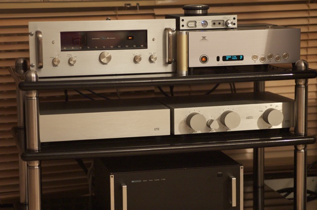

As far as i can tell the IRD Purist works with Opamps. It´s well made though and is very afordable. I can show you a way how you can bias that OPamps into class a if you like.
I have a photo of the Blowtorch on my other computer. It is owned by a friend of mine who had more or less all interesting components over the years. He seems to be happy with the Blowtorch and i can ask him why he uses it.

I hope that I am allowed to state what the Blowtorch preamp really is:
It is what we came up with, my business partner Bob Crump and I, to make the very best preamp that we could, for both ourselves, and for a limited number of customers.
The 'performance art' part of the preamp came from having to make something that our customers would accept in their system. However, very little about the preamp is arbitrary. The thick aluminum, almost airtight case, is on purpose. It is a good heatsink that allows us not to punch vent holes to let the heat out. It is a very good interference filter, that keeps RFI from computers, lamps, etc, out.
The Blowtorch has big knobs in front, showy, but necessary. The only other way to turn those big military switches is to put a vice grip plier on them, and that is unseemly.
We chose the switches, inside, because they sound better than any relay we know, and I had 30 years of experience with small signal relays, including several preamp designs, before going over to Shallco Silver switches. The circuitry, while simple in through-path, is exotic. All direct coupled with 4 quadrant symmetry to handle both single ended inputs or outputs without any negative feedback.
We used this preamp in listening contests with other preamps. We almost always won, however some tube gear was just as good. This was our goal, to win listening contests. Before making this CTC Blowtorch design, I was using passive as a line stage, and manually changed cables when I wanted to listen to another musical source. This I found better than ANY previous preamp that I owned or designed. They went to the closet, where they remain today.
It is just like trying to find the best wine tasting experience possible. Or the best restaurant experience. Some people throw their expendable income in that direction. Do I criticize? No.
