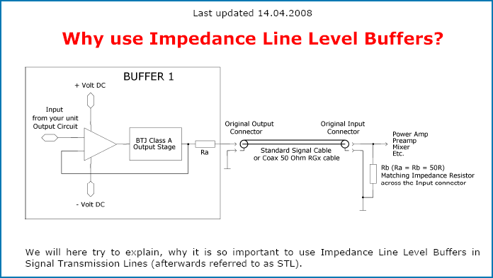

It so happend, that a couple of weeks ago, I visited your site, neighbour countryman ACD.
(Mr. Lineup sits in very north of Sweden, Lapland, writing this to you )
I turns out you have developed and provide a cable driver circuit/buffer.
For use, for example, to optimally transfer of audio signals into a specific impedance terminated cable.
Great and rather unique device, with very good data :cool:
Output Impedance: 50 Ohms
Here you are, our dear uk-fellow Andrew:
Image:
http://audio-innovation.eu/images/BUFFER v1-1/BUFFER 1 v1-1 RCA 650.jpg
Details, PDF:
Cable Driver principal theory - and why it is good
Website & lniks, see ACD signature.
lineup :) good audio greetings

Hello lineup from the great north :D
I wouldn't promote my self and therefore didn't made a link to this, however now when you have pulled it all into public attention, I can say that for line level interconnections it makes a h*** of a difference ;)

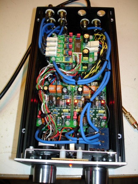

I did post some pictures in this thread
http://www.diyaudio.com/forums/showthread.php?s=&threadid=96192&perpage=50&highlight=&pagenumber=7 some times ago. I have attached the picture here again.
However I have never tried Coax as speaker cables.....:rolleyes:
Maybe I should give it a try ;)
