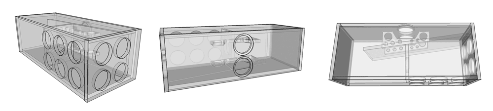

You've seen the HT appendix for the miniTower?
1st suggestion would be a double high wall-mounted centre. Dimensions can be adjusted to get the height under 11".
End result would give a driver config something along the lines of this EL70 x 2 ML-Voigt Centre that i am currently working on to mate up with bipole Mets.
dave
dave
Thank you Dave, I found the appendix. I would put the 2 CHR on the same front panel, widening it to 11" so the two CHRs would barely fit one on top of the other. Is the distance between them important?
