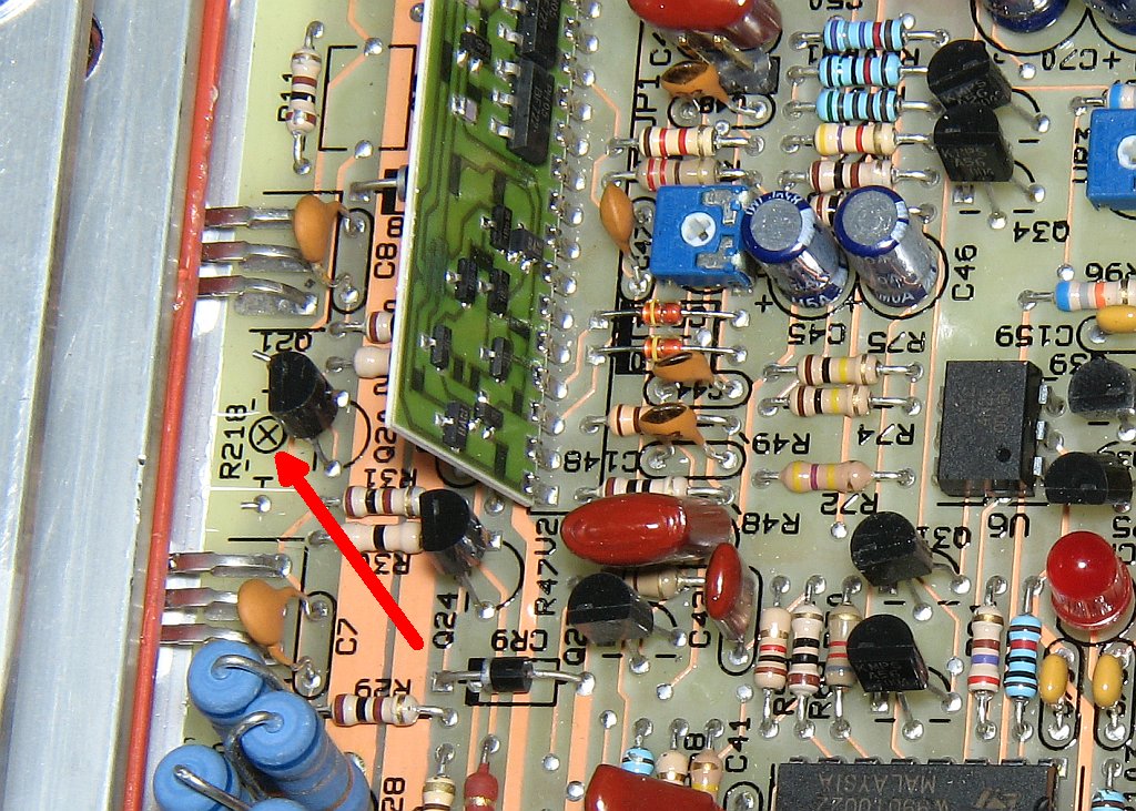

the rookie is trying to fix nice PPI Pc2600.2 I'm seeing few issues
1 -green light comes on but the amp is not powering .all fets are tested and no shorts and no repairs in the past that i can see.At the power supply fets I'm getting 1v on the gates and 11 on the middle legs
2- one of the driver cars looks like it was getting hot -bit brownish under it
3 the mystery- one resistor is mounted on the board but not soldered r192 its between q71 and q72 transistors .it looks like it has never been soldered to the board just mounted

1. That would generally mean that the power supply is running.
2. Does it look like the board it discolored or could it be something on the board? Is it discolored top and bottom?
3. Is there any solder on the bottom of the board? It seems like it would have fallen out if not soldered in.
4. Operating the amp without the bottom cover in place is dangerous because the transistors can overheat and fail quickly, especially if there is a problem. When troubleshooting it without the cover, install shunts on the 2-pin headers JP1 and JP4 while troubleshooting when the cover is not tightly screwed down. There are regulator transistors on each side of the amp. They will get hot and can fail even if there are no problems with the amp. Watch their temperature closely. If you do it by touch, only touch the plastic part of the transistor.

there is discoloration on both top and bottom of the board under the driver card .light brown discoloration .soldering looks bad like cold solder will do them again
that r192 can be soldered on the top of the board only ,i dosent look like it has ever been soldered there but why the hell should someone put it there ???resistor legs are gently folded so its stays on the board but not soldered
