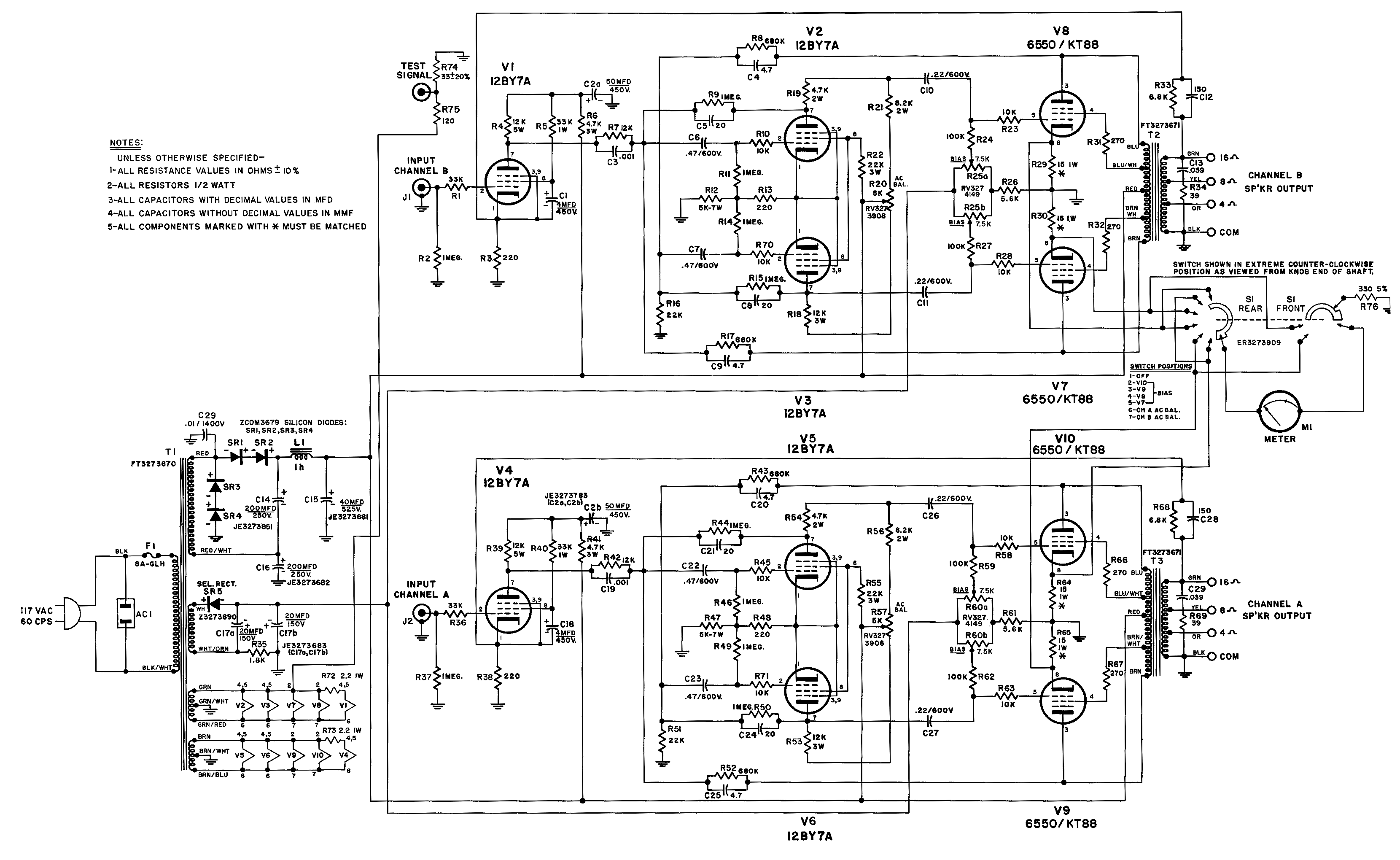

Another tack is to "clone" the Harman/Kardon Citation II circuit.
I own a Cit. 2 and it sounds GOOD. Costly HIGH performance O/P trafos are essential. The Plitron PAT4142 might be up to the task.

The Citation II interests me too, but I think it might be a "hard act to follow". Even H-K never built another amp on that design and neither did any other manufacturer AFAIK.
I think SY's idea of an all-diff amp is good. I have one like that (first stage is LTP splitter) and it's totally hum-free (I call it my Humphrey model). However, it uses triode-strapped EL34s, which don't need much NFB. It might be a bit of a reach to get enough open loop voltage gain to be able to apply sufficient NFB for pentode-mode. Modeling with LTSpice shows it can be done, though, achieving a damping factor of 10 and sensitivity of 750mv RMS for 50 watts output. That's with three NFB loops: one local balanced loop, one 2-stage cross-coupled balanced loop and one global loop.
Of course, if I put a transformer splitter on the front as SY says, than I wouldn't have to use the first stage to split the phase and I'd get twice the voltage gain, making it much easier. I don't have such a tranny, although I believe there is a very good Lundahl model for that purpose. I suppose a concertina splitter could be added on the front instead of a tranny to achieve the same thing, but that would be a real shame because I would lose all that lovely PSRR I get now.

Something like Jensen 11P1 or the Cinemag equivalent can also be dragooned into service as an input phase splitter (with concomitant CMR) by putting two matched resistors in series across the secondary and grounding their junction.
If we cascade 6SL7 and 6SN7 diff amps (an old and honored pairing), we can get a driver stage gain of 400 pretty easily. That leaves us roughly 20dB of excess gain which we can use for feedback. As you point out, Ray, that can be apportioned into several loops.
What bothers me about an all-diff amp is that it might be too much of a good thing. The 6SL7 cascaded with 6SN7 that you mention is what I use. It's a very easy design to get working and, as I said before, is very quiet. However, all the harmonics are odd - no second, no fourth, etc., but plenty of third, fifth, seventh, ninth, etc. (talking about pentode OP tubes here).
I suspect a bit of even order harmonic distortion in the mix might sound more natural - some 'sugar to sweeten the bitter medicine' of odd harmonics. There may be something to be said, therefore, for a single (unbalanced) voltage amp at the front end, as in Mullard and Williamson for instance.
