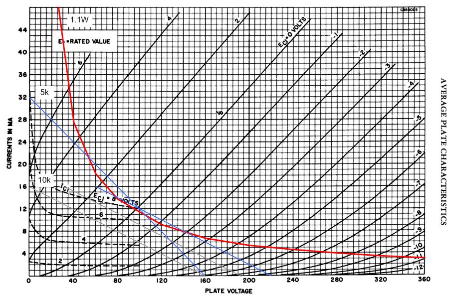

Hi, I'm currently trying to design af push pull triode amp with inspiration from ZVex's IMPamp. That mean that I am using the dual triode 6021 as output tube and LED cathode bias. This is my first time built from scratch and I am trying to figure out what output transformer I need.
I recently bought a pair of OT's rated 5W with a 4ohm secondary and a 10kCT primary winding. I plan to use 8ohm speakers and guees that this will reflect back an 20kCT load.
The sylvania 6021 datasheet shows 165 maximum plate voltage - I plan to use 160V. I've read at valvewizard.co.uk that a blue LED drops 3 voltage at the cathode.
I've attached the plate curves with my load lines - will this setup work or am I pushing the tube to hard?

Assuming the red line is maximum plate dissipation, I would say back off a bit.

Hi rman, thank you for your reply
yeah, the red line is the maximum plate dissipation. I plan to operate the triodes in class A - should I lower the plate voltage?

There are so many things wrong with your picture (considering your description) that I don't know where to start
First of all, what kind of load do you intend to drive ? Unless it's some extremely efficient speaker or curiously low impedance headphones you're probably going to be dissapointed by the sub-1W output power.
If you intend to pursue this idea further, calculate correct load impedance first, plot correct loadline (above it says class A, pictures shows class AB), figure out how you're going to drive your tubes (whether you're going to dip into positive grid voltage area or not) and then determine your operating point (which mostlikely isn't going to be anywhere near 160V cathode-anode voltage if you want any kind of signal out, considering dissipation limit).

Hi Arnulf, thank you very much for your reply!
The class A/AB are just me trying to understand
I've read the push pull article at valvewizard.co.uk - he use an example ..if we bias hot enough (i.e., push the Class A load line up far enough) it will become pure ClassA. What have I misunderstood here?
I don't want to use any extremely efficient speaker I just want to built a push pull amp with the 6021 tube and my already bought transformer.
However, I like the idea with LED biasing but I am not sure if i can use my transformer.

Your picture shows "broken" loadline, indicating that one device cuts off at some point. This is class AB operation (one device cutting off after certain output excursion). As the line you quoted says: if you bias it hotter, both devices will conduct 100% of the time, hence no break in the loadline.

LED is just a nonlinear resistance (unlike real resistor). If you understand cathode biasing with resistor, then you understand LED biasing as well
Figure out what kind of laod you intend to drive and what kind of power level you want, then plot the laodline correctly and see whether you can get desired result with selected parts. It's impossible to guess whether your transformer can work out to your satisfaction without actually knowing what you're trying to accomplish.

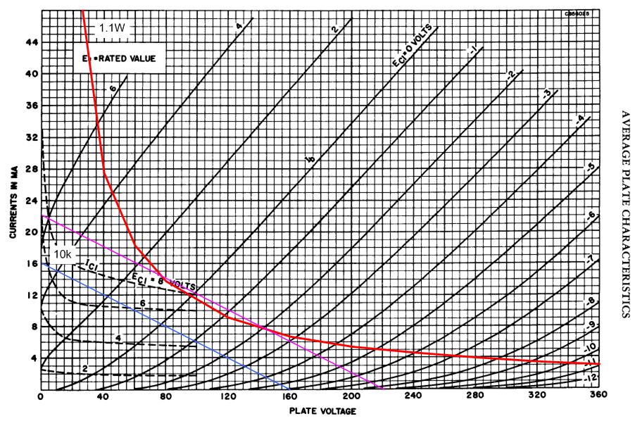

The amp is intended to stand in my little kitchen with small speakers..so i guess 1 watt will suit perfectly..I plan to use small average 8ohm speakers, - that will give 20k plate to plate load with my transformer.
The blue line is the 1/2 x 20k loadline at 160V.
The purple is the same loadline "LED-biased" at -3v at 160voltage.
Am I wrong??

Reflected load impedance doesn't scale proportionally with the number of turns ratio - it scales with ratio of number of turns squared.

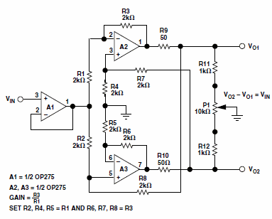

Hi Arnulf, I plan to use the attached circuit as phase splitter without A1 and with OPA234 op-amp.
From output transformer explained at aikenamps:
If you put 1VAC across the secondary, and measure 20VAC across the primary, you have a turns ratio of 20:1, which corresponds to an impedance ratio of 400:1. This means that if you put an 8 ohm load across the secondary, you will get a reflected impedance of 3.2K ohms across the primary. If you put a 4 ohm load across the secondary, you will get a reflected load of 1.6K ohms.
That's why I assume that my transformer will give a reflected load of 20K at 8ohm..
Yes, you are correct.
I think you're all set. You've got your input covered, adjustable gain of phase splitter will allow you to tweak the input for maximum swing without distrotion. You have the loadline and quiescent point (albeit rather "hot" one -average dissipation is still within 1W per anode though), so all you've got to do now is to build the thing and try it out
Do not forget to use suitable grid stoppers (and additional capacitance), this is an RF tube you're using so it might be prone to oscillation. There is a nice online RC filter calculator somewhere (I always Google it up when I need it ), put the cut-off point somewhere between audio and MW band.

Thank you very much Arnulf! surely this has cleared up some things for me I'll put grid resistors and calculate the cut-off between audio and MW but I have one more question.
lets say, that my mp3 player puts out 0.5v RMS like yours. According the circuit description the gain equal R3/R1 - if I set R1 = 2k and R3 = 12k I'll get a 6dB gain => Vout = 4v RMS
But if I connect a CD player that puts out 4v RMS, will I then be able to tweak Vout to around 4v via the 10k Pot? - this is might a newbie question, but that's what I am

Isn't that just the balance trimmer ?
..or use a simple (shunt) attenuator.
Off course Arnulf ..would it matter if I removed 10k balance trimmer/replaced it with 5k resistors? (I'm not sure what the purpose is for the pot)

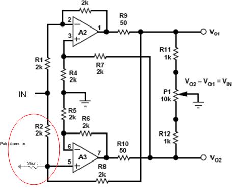

Would this work?
I don't get it, what is this supposed to be ?
Hehe..sorry for that one Arnulf..
What I want to do is to be able to adjust the amp so that if
1. the input is 0.5v RMS at max volume from the mp3-player I get a 4v
RMS at the grids.
2. if the input is 4v RMS at max volume from the CD-player I also get 4v
RMS at the grid
And I want to do it with a single trimm pot (turned left for cd-player and right for mp3-player)
Hi again Arnulf.. I've found this page Operational Amplifiers
If you scroll down 2/3 there is a calculator for the opamp as a differential amplifier..can I use it to find the resistor combination? if yes, is it possible to replace R2 in the original schem with a pot, connected as in the attached file?
