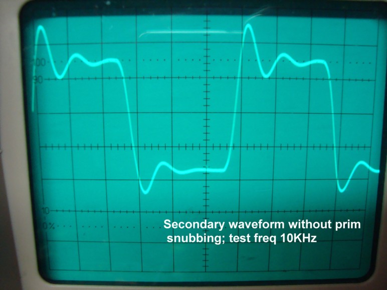

All custom makes use symmetrical winding construction for best balance, so the winding resistances are equal. I find the Sowter 7-14 sectioned designs sonically clean with 20dB global nfb give good open low end response, the UL anode to screen winding taps respond relatively easy to zobel snubbing, ringing occurs around 70Khz upwards.With high gm tubes this is often required. The fourier response equation requires a transformer bandwidth so that the 3rd harmonic doesn't droop more than -3dB at 3x the highest audio frequency. The rule of thumb is 20Khz x3 = -3dB at 60Khz. This is the minimum achievement for HiFi. We need high bandwidth to express wavefront rise-time as some instruments can have steep uS waveforms, in a view of expressing definition.
The 18 sectioned from others and NOS have even more complex winds and expensive. On merits, the upper leakage capacitances are slightly higher,requiring more careful snubbing so these designs are better for parallelled push pull stages. My own view is that the 18 sectioned designs are harder to optimise but give a more precise sound and can handle upper audio frequencies better. This can make the 1st stage phase compensation and feedback loop components tricky to optimise.

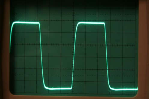

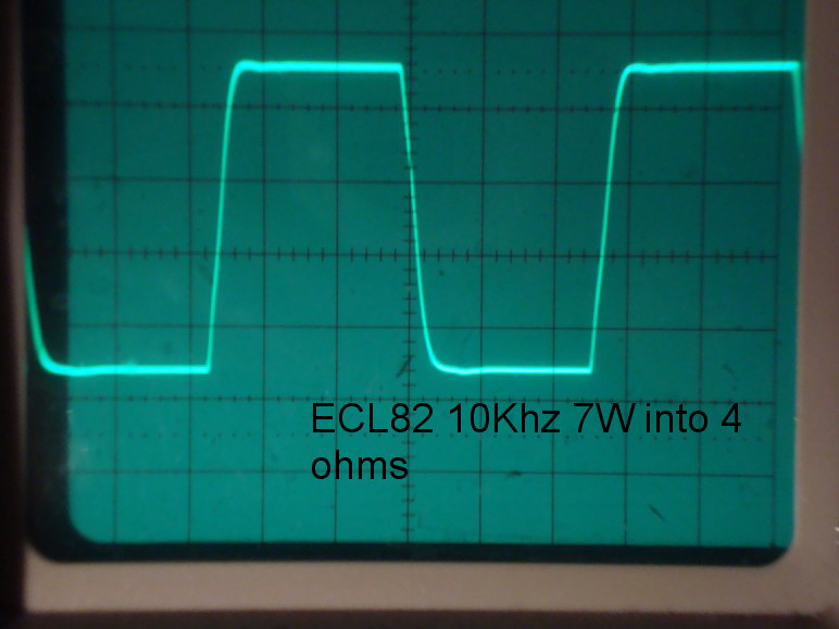

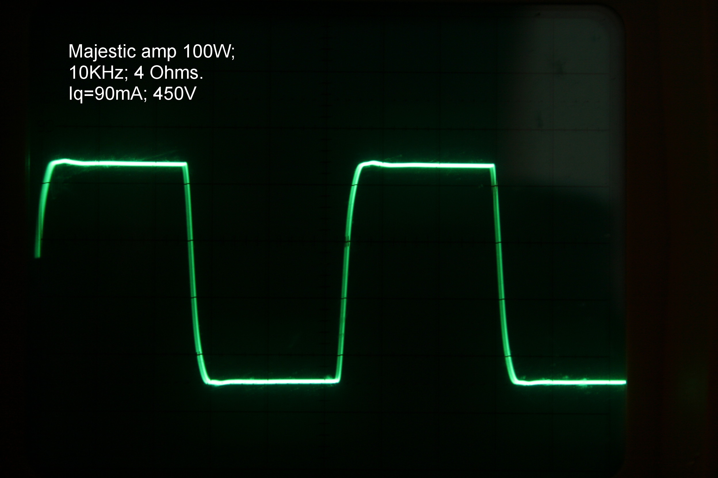

Enclosed are some waveforms. The Unsnubbed is typical of all p-p transformer undamped waveforms, the 10Khz squarewave test is very revealing of how all works. The procedure of damping primary resonances is the same from the uncomplicated 7 sect 7W ECL82 to the complicated 100W parallelled p-p types. Notice the cleanness of the 14 sect Sowter 8659.The 18 sect Majestic with sharper flank was alot harder to optimise, some auditionists mentioned it offers ultimate classical reproduction sound. So there we have it.

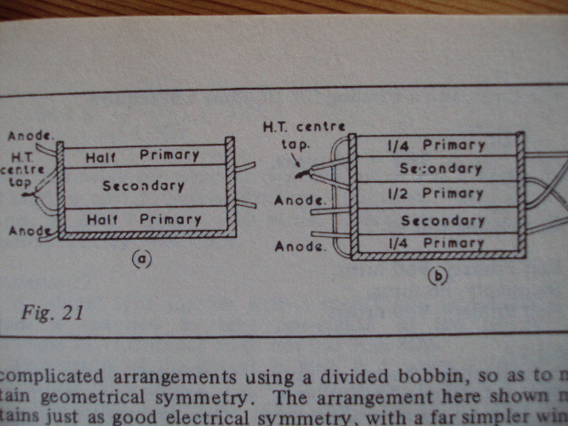

For the absolute simplicity see pic. Results can be suprising. (b) is a better quality version than (a). Obviously suss the phase out.

Hi Richy,
That (a) is pretty much like every vintage economy transformer I've rewound, while (b) was when they wound for balanced DCR is somewhat higher quality (6V6) units.

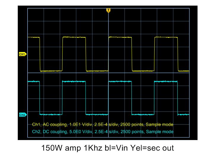

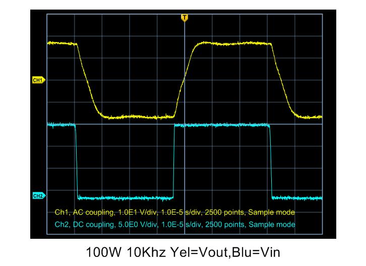

I get emails on "what to do's", regarding procedures with large p-p o/p trannies, i.e above 100W at low frequencies. The challenges and complexes are there, those o/p trannies weighing 15- 20Lbs#10Kg or so is no trivial business. Designing power amps in this upper power segment requires careful thought with test equipment and layout, the scope earthing leads and so on.
Following the discussion from posts 2,3; those square wave pics were obtained from a 4 stage amp with feedback loop and phase correction designed using the K transfer function calculation, with o/p transformers having 20Hz cutoff. The result that optimised circuits can accept a total of 36dB global nfb i.e onset instability. However, when an o/p tranny down to 15Hz is on the bench i.e +35% bigger, and to get a clear HF response at 150W the circuit design isn't quite so clear cut. As the size rockets, the leakage and capacitive parasitics double up, far more copper area, and greater through-winding capacitance begins to suck power je higher the frequency.
Actual parallel push-pull amplifier test with a 150W tranny specified at 15Hz throughput (this is a massive lump):- notice the square waveforms at 1Khz and 10Khz. Both taken at the 100W level. The 1Khz is near original whereas the 10Khz has rise and fall drastically slewed and the waveform resembles a "sandcastle". This amp used for demo is stability optimised: one cannot get a better squarewave quality as the limitations of bandwidth in the output transformer become the restricting frequency element. The distortion at 150W at 1Khz is typ 0.2%; so at 10Khz to be around 1% or more.The open loop curve of an amp designed with such a transformer looks like an upped' half moon.. Generally,all p-p transformers exhibit rising thd with rising frequency. Again, depends on circuit topology and amounts of global nfb used.
This is why paralled o/p tubes are often used in parallel-p-p to lower the impedance hence reducing turns= lower losses. To get 10Khz at 150W power without overshoots and strays requires skill. Things will get hot, any snubbers must be sensibly rated.
So when designing tube amps, keep to amicable power throughputs, lower and smaller output transformers are much easier to use. Consider the bandwidth implications of what is absolutely necessary, HiFi and/or MI.
