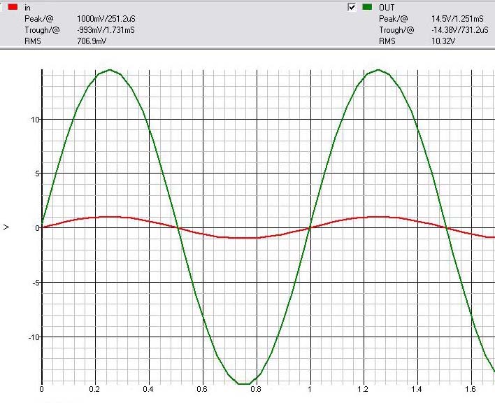

Exactly. Anyhow without trying to prove anything, this is what my trusty simulator comes up with:
fab
Joined 2004
The simulator results is in line with post #17 circuit where feedback resistors gives a gain of abut 20 (corrected schematics as compared ot original circuit in earlier post) but since the open loop gain is relatively low then the real close loop gain is about 14 something.
Ouf, I can keep my diploma!
Fab
Right. The sim plot posted is with 10k/510R feedback resistors. I am writing from another computer and I don’t have the sim file with me now but the gain of Dozuki's schematic with 2.2k/510R feedback resistors was close to 3 according to simulator, if I remember correctly (I used 2sj162 /2sk1058 for outputs though).
