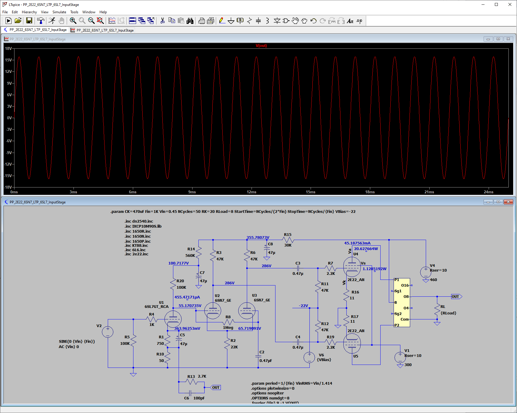

I recently mentioned the history of this amp in another thread.

I come here to ask for information about the schematic, to know if it is stable and/or if there are improvements/modifications to be made.
It was one of my favorite amps, I only found it a little short in the bass (for my taste, I never measured it)

I'm a bit surprised by a couple of things:
- very low 6SL7 anode voltage.
- very low LTP current 1.5mA/plate?
- very low g1 resistor. I know the 2E22 specifies 29k max g1 impedance, but that's for RF class c operation. In any case, that's a low impedance input for the LTP.

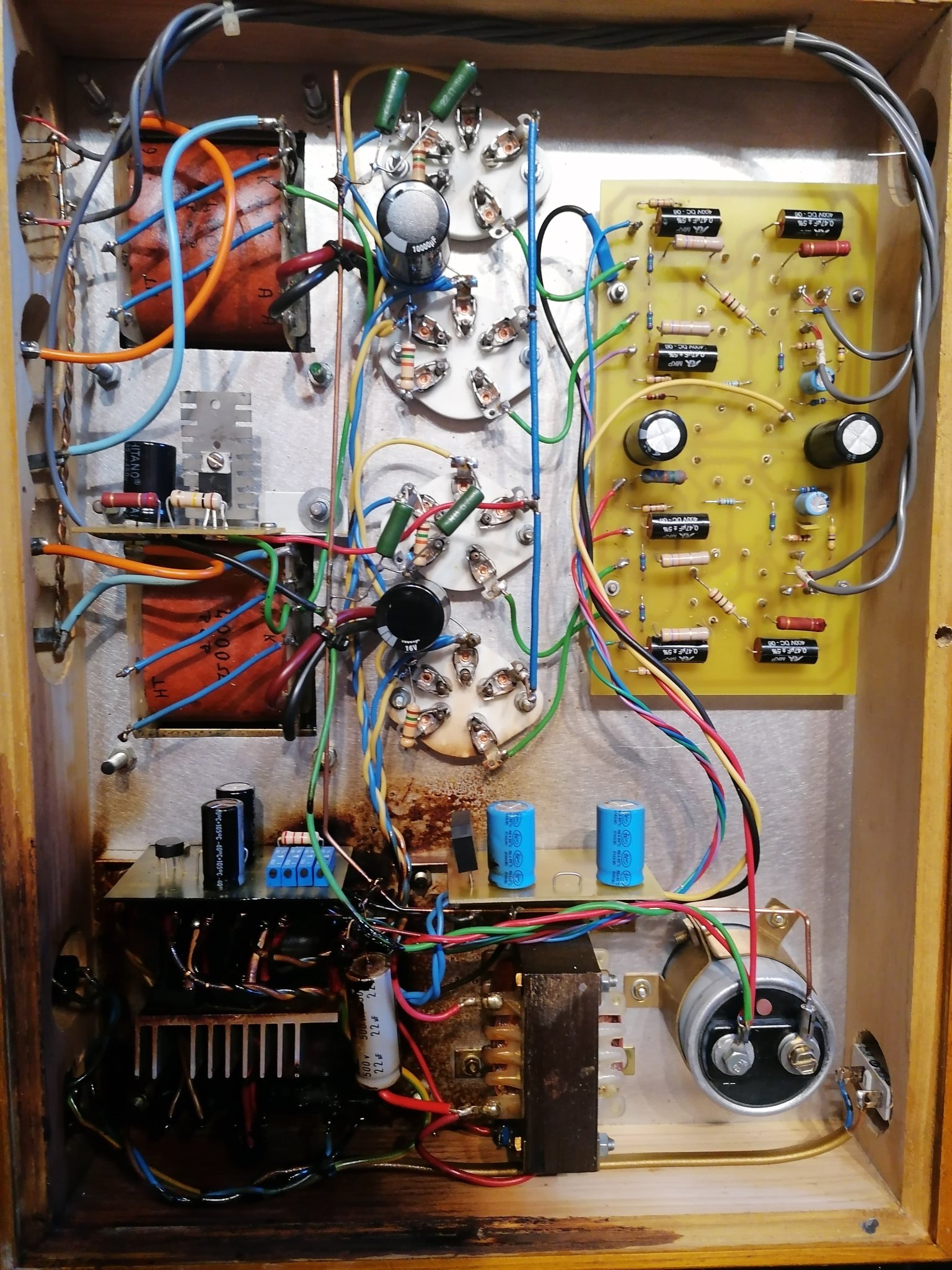

@huggygood What is left intact after the fire? You got the OPTs/tubes etc?

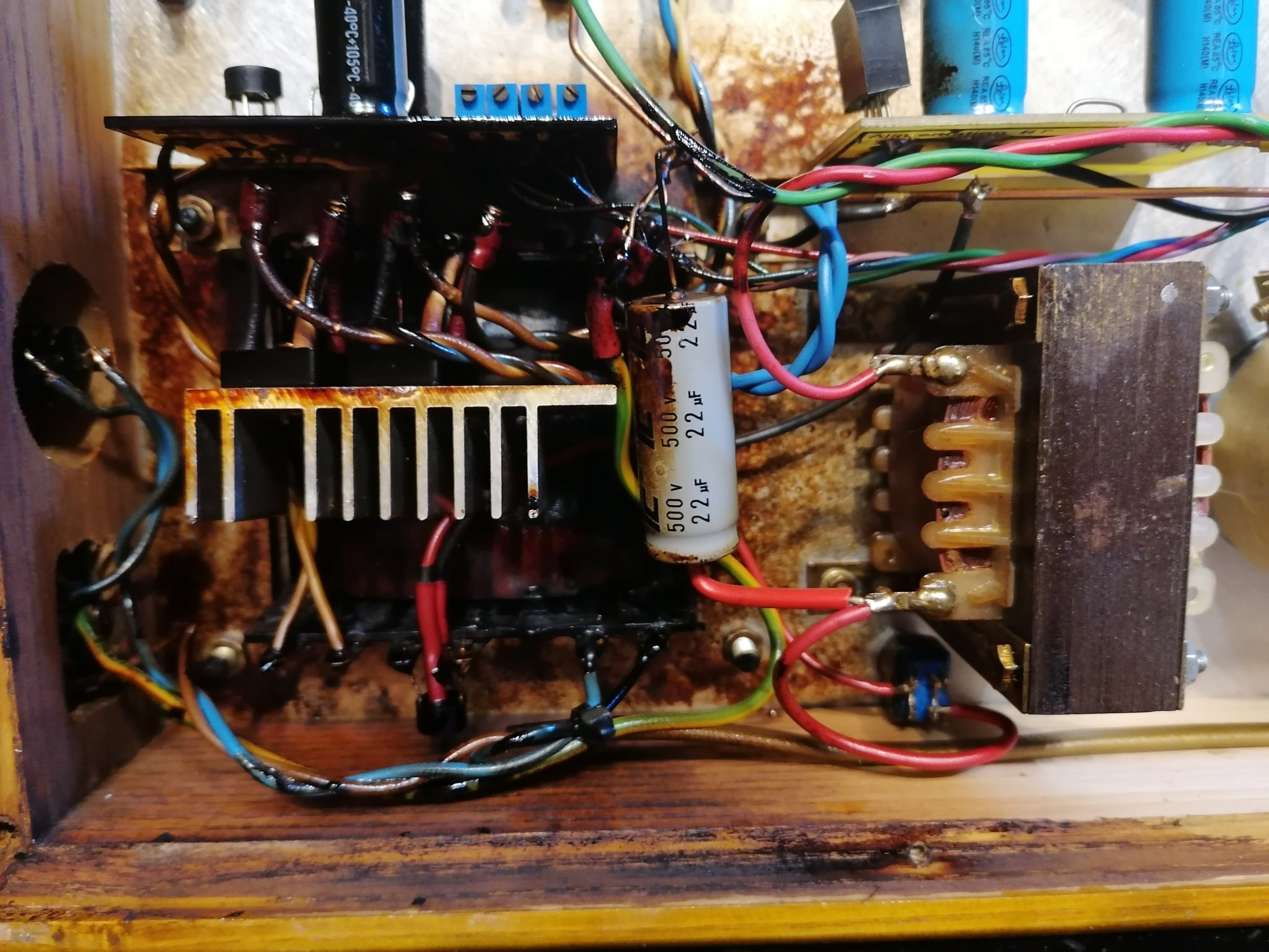

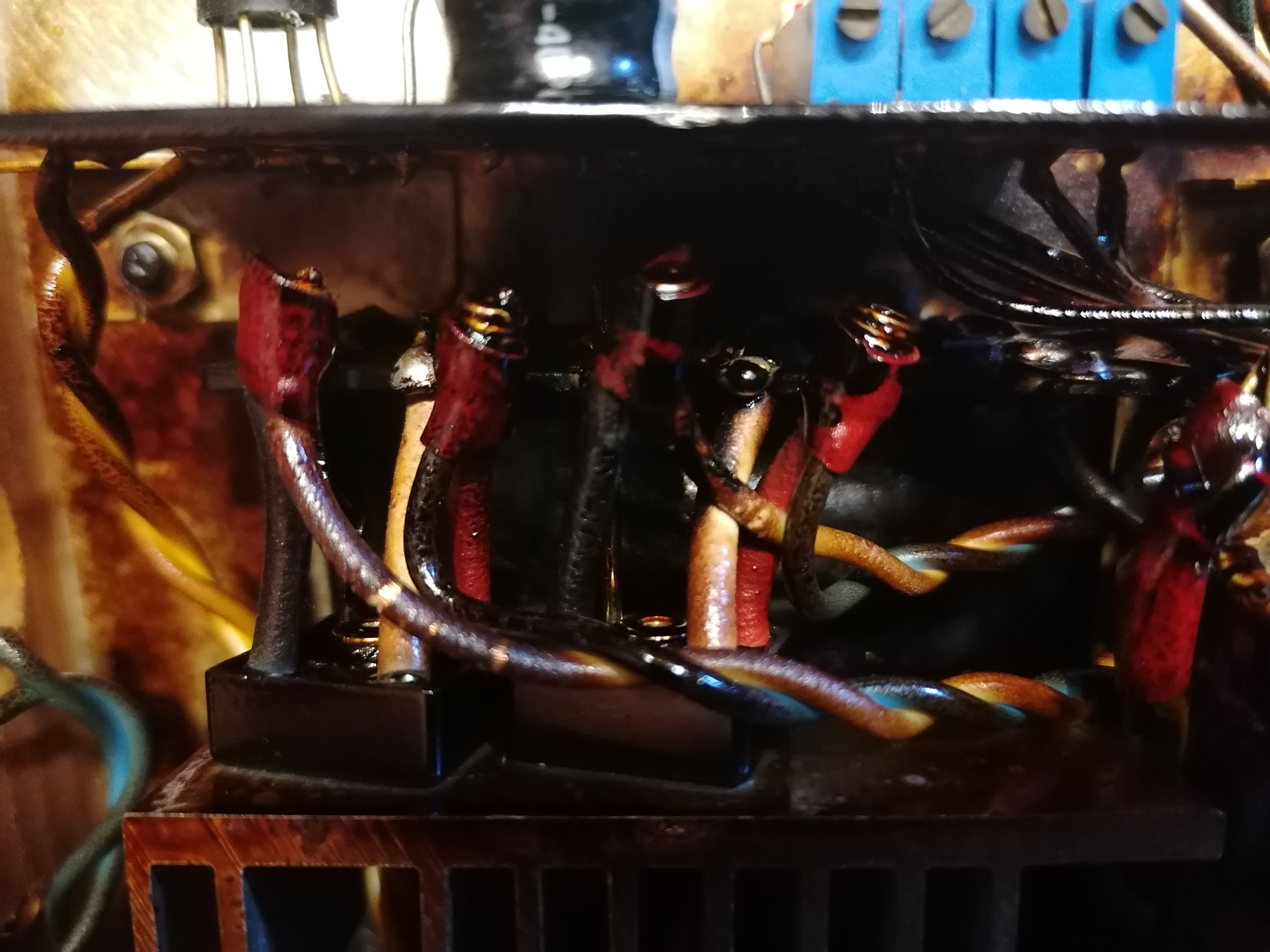

I think the OPTs are ok, but not yet measured, the 2e22, 6SL7 and 6SN7 are intact, everything near the PT is burned including the starter.@huggygood What is left intact after the fire? You got the OPTs/tubes etc?
I'm going to take photos today.

I have never checked the actual values in the real amp, this will be the opportunity to do so.Yeah, those decoupling resistor values can't be right.
I should be ashamed but I had never paid attention to the power indicated on the schematic but it is indeed very high compared to the output stage and the tubes used.The large transformer has a large field, also weight ..and... price. 700 milliampere is too much for 360 volts.

the thing that always intrigued me was that the amp had been on for barely 30 minutes and probably did not exceed 2W when it burned, I was busy on another amp that was giving me a hard time and a moment when I regained contact with reality I realized that the sound was less loud and that's when I saw the cloud above me then the smell.
It took half a day to cool down.

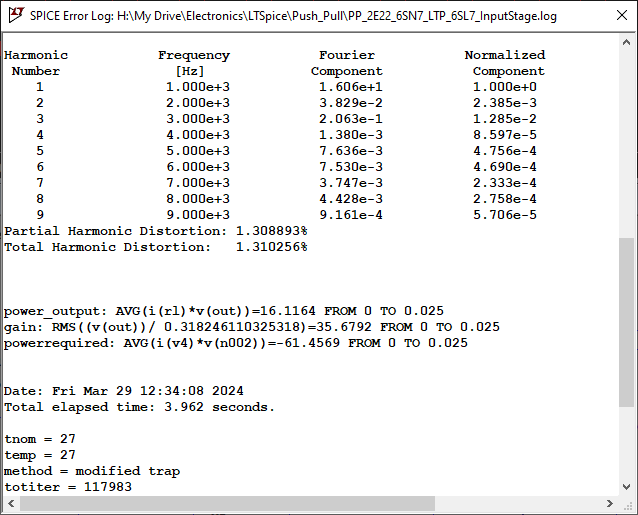

Here is a simulation. I found a 2E22 model in the Spice Model thread, I have no idea how good is. Then I changed the voltage dropping resistors, to get the right DC values and take into account that two channels are being powered. I could not make the simulation stable with the 1K nFB resistor, best I could do was 2.7K. Transformer model used is 1650N (4.3K, close enough).
16W before clipping, a bit low for such output tubes. But, as usual, this is just a simulation.
My pleasure. In fairness, the amp has the same topology as mine, it was a bit of copy and paste 👍It's really very kind of you to have taken the time to enter the diagram into a simulation, I'm really very touched.
