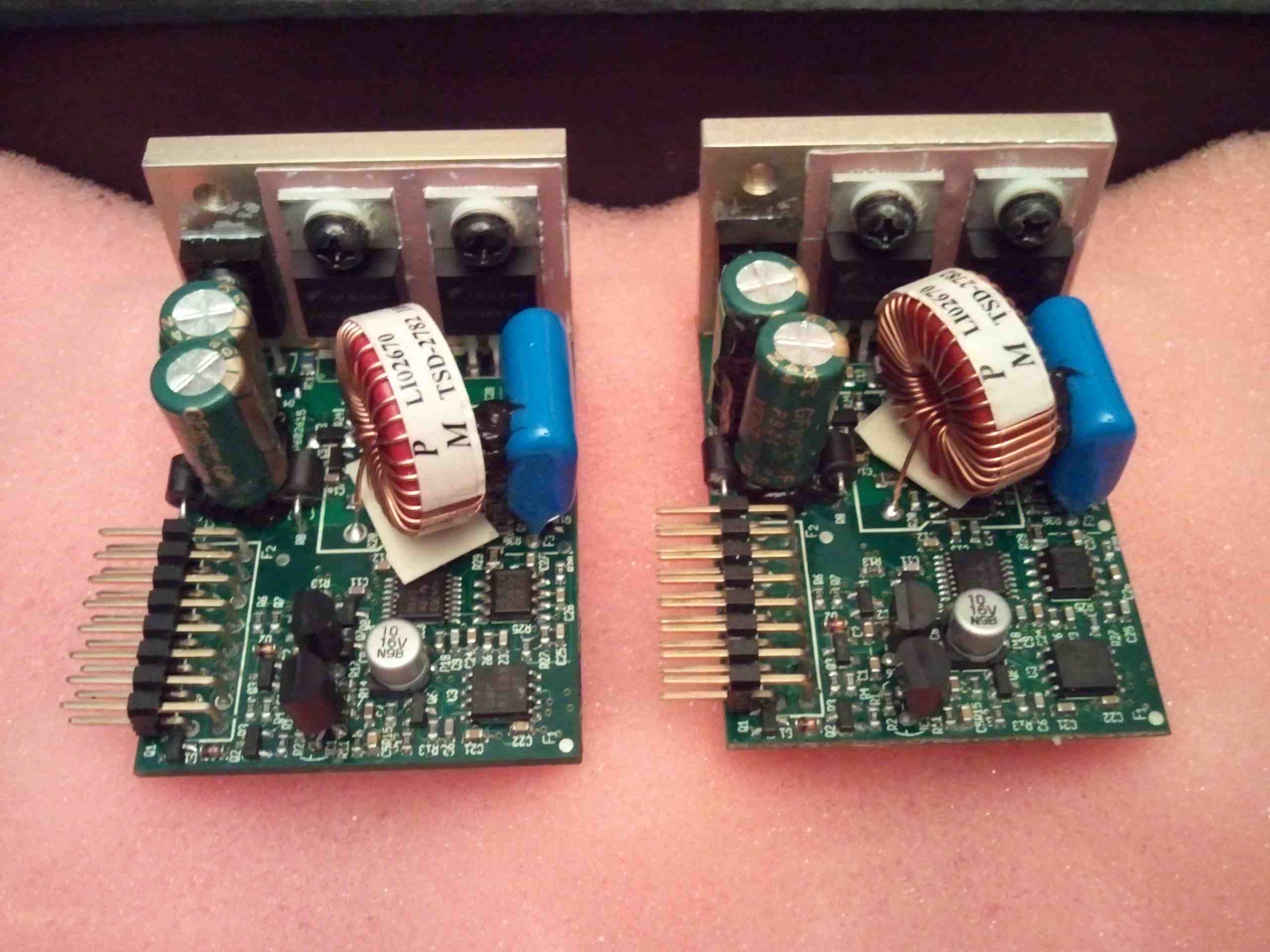

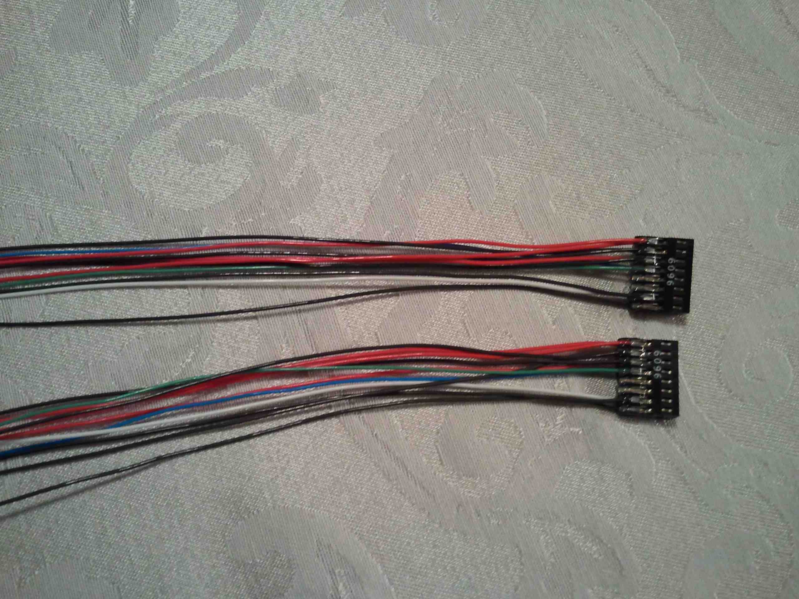

I was one of the fortunate winners of a set of PowerPhysics A154 amp modules. They arrived safe-and-sound well packed in an ESD-safe cardboard box. They're beautiful little amps with a surprising component count despite their small size. Everything looks quite robust with the exception of the output inductor which could use a little more silicone to prevent it coming loose.
Connecting the amp is kind of easy and hard at the same time. All connections are made through a 16-pin male, right-angle header. One way to connect it would be to solder wires directly to each pin and adding some heatshrink tubing to keep it clean. Another way is to wire up a 16-pin female header. This is what can be kind of hard. The first 16-pin female headers I found were the type where the wire is "sliced" into the rear of the connector then clamped together to lock it in place. But, this header would only accept 24AWG wire which seemed as if it would limit the 2+ amps of current needed for higher outputs. Next, I found some 16-pin female headers, only these were SMT solder types. I flipped it over and proceeded to solder each wire onto the solder leads. Unfortunately, when I applied some mounting force to the female header, it fell apart. It either has to be mounted to a PCB or soldering it weakened it. Finally, (phew!) I found a more robust 16-pin female header that would accept 20AWG wire, could be soldered and remained solid. Yeah! I briefly considered de-soldering the male headers from the boards, but decided not to in case I introduced damage plus I would lose the flexibility of disconnecting the boards for later projects.
Mounting it should be pretty straightforward, but I'll post on that when I get there.
Thanks again for the generous donation. I will continue to post as the amp's construction continues.
Paul
P.S. I still cannot view the A-154 pinout pdf. I can view all others on the site, but the A-154 is black. This is the case on both my home and work PCs.

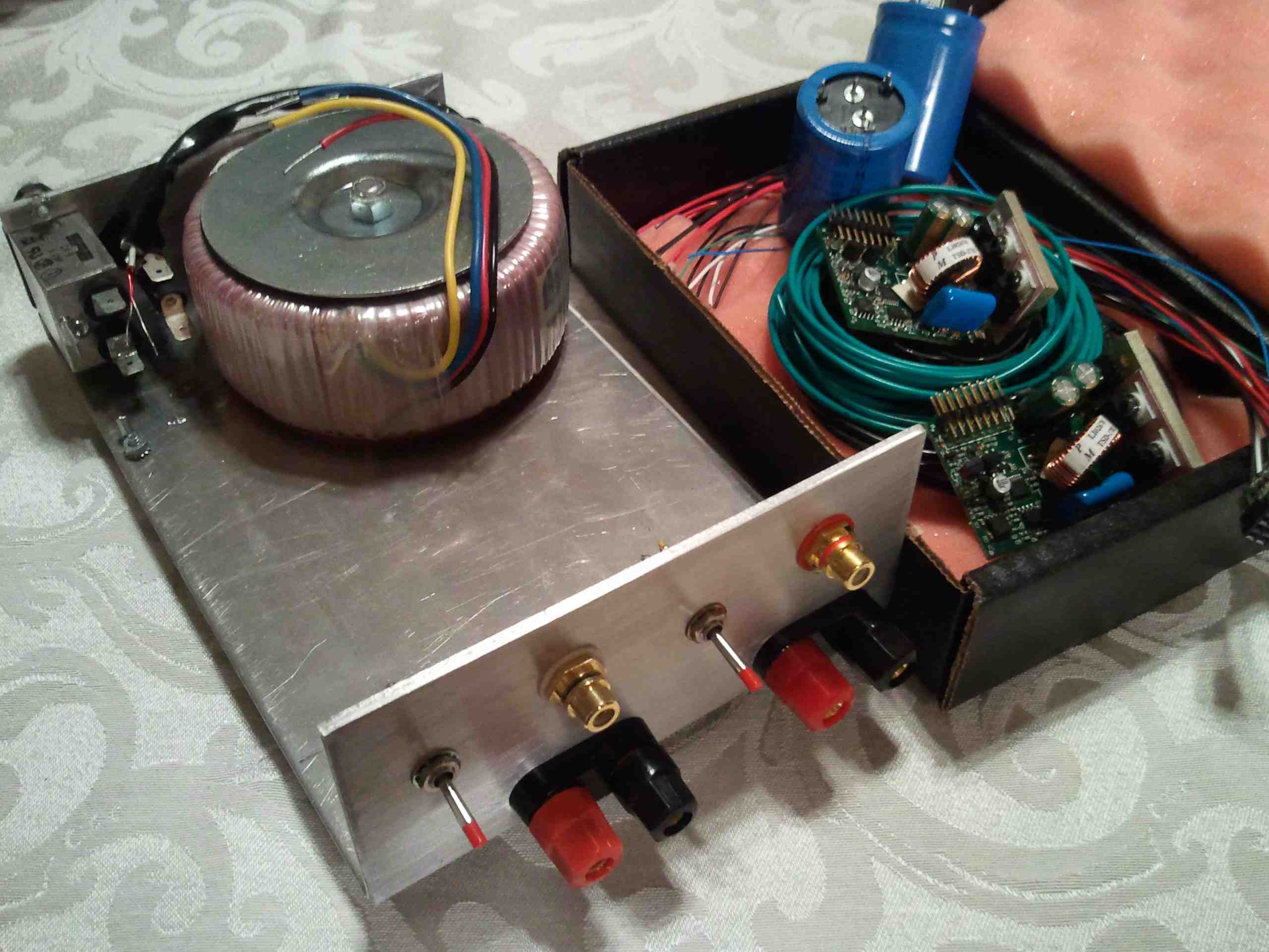

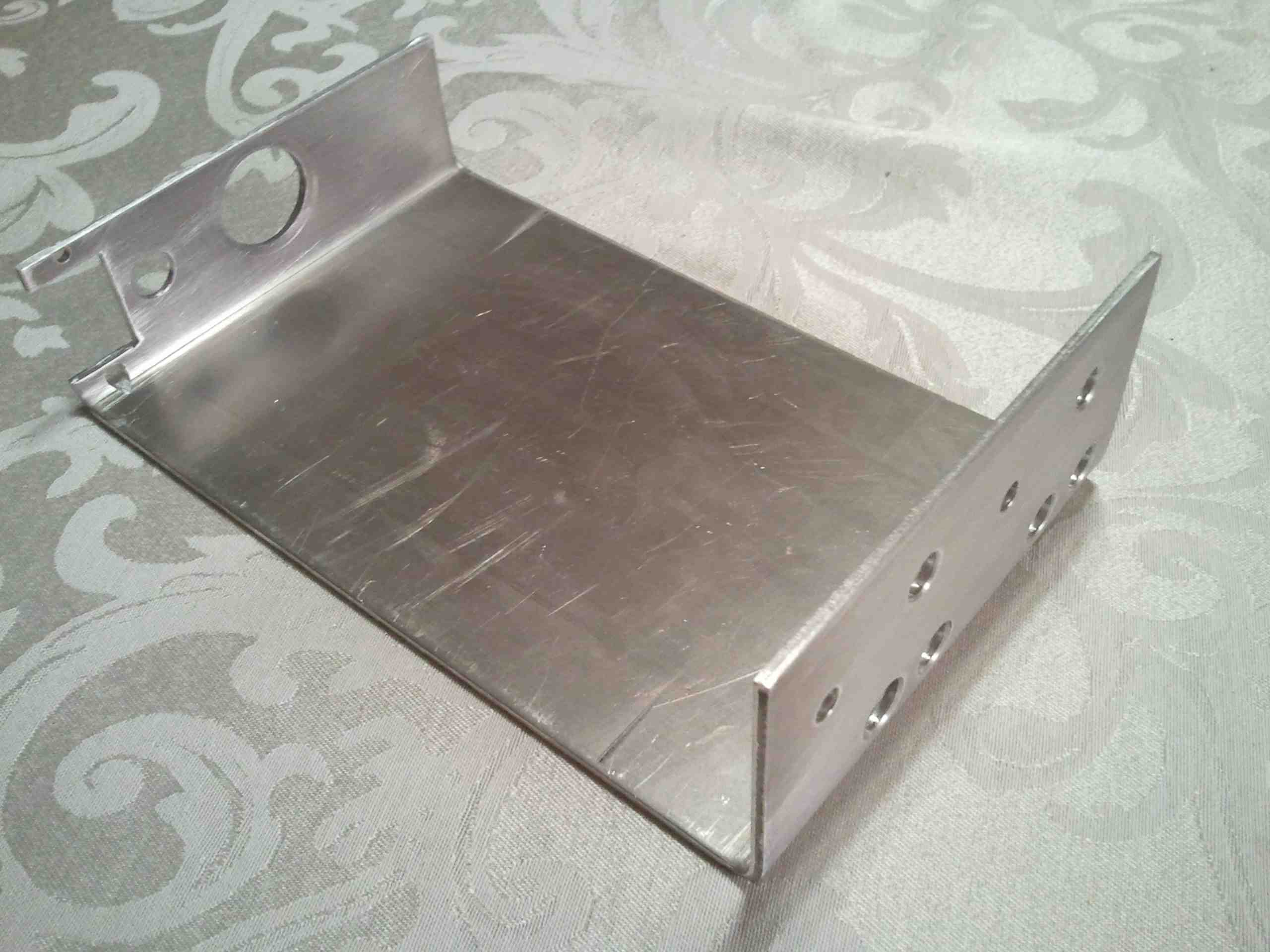

Just a quick update. I've made some more advancements on my A-154 stereo amp project. It's coming along nicely and now I've bent up an open-frame chassis out of 1/8" aluminum. 1/8" aluminum is tough stuff to bend without a proper brake, but thanks to some big clamps and an assortment of vice-grips, I managed. Next, I mapped out and drilled all the holes for the connectors and switches. Finally, I installed the switches, connectors, jacks, power transformer, power entry filter and fuse holder. It's looking pretty cool!
I have the schematics done for the filter and power supply PCB as well as the op-amp designs for the stereo/bridged selection. But, they're not entered into a CAD program yet, so I won't be posting them at this time. My next steps are additional hardware fabrication for mounting the modules, rectifier, PCBs, etc. I'll post more pics as I progress further.
As always, feedback and questions are always welcome!
Paul

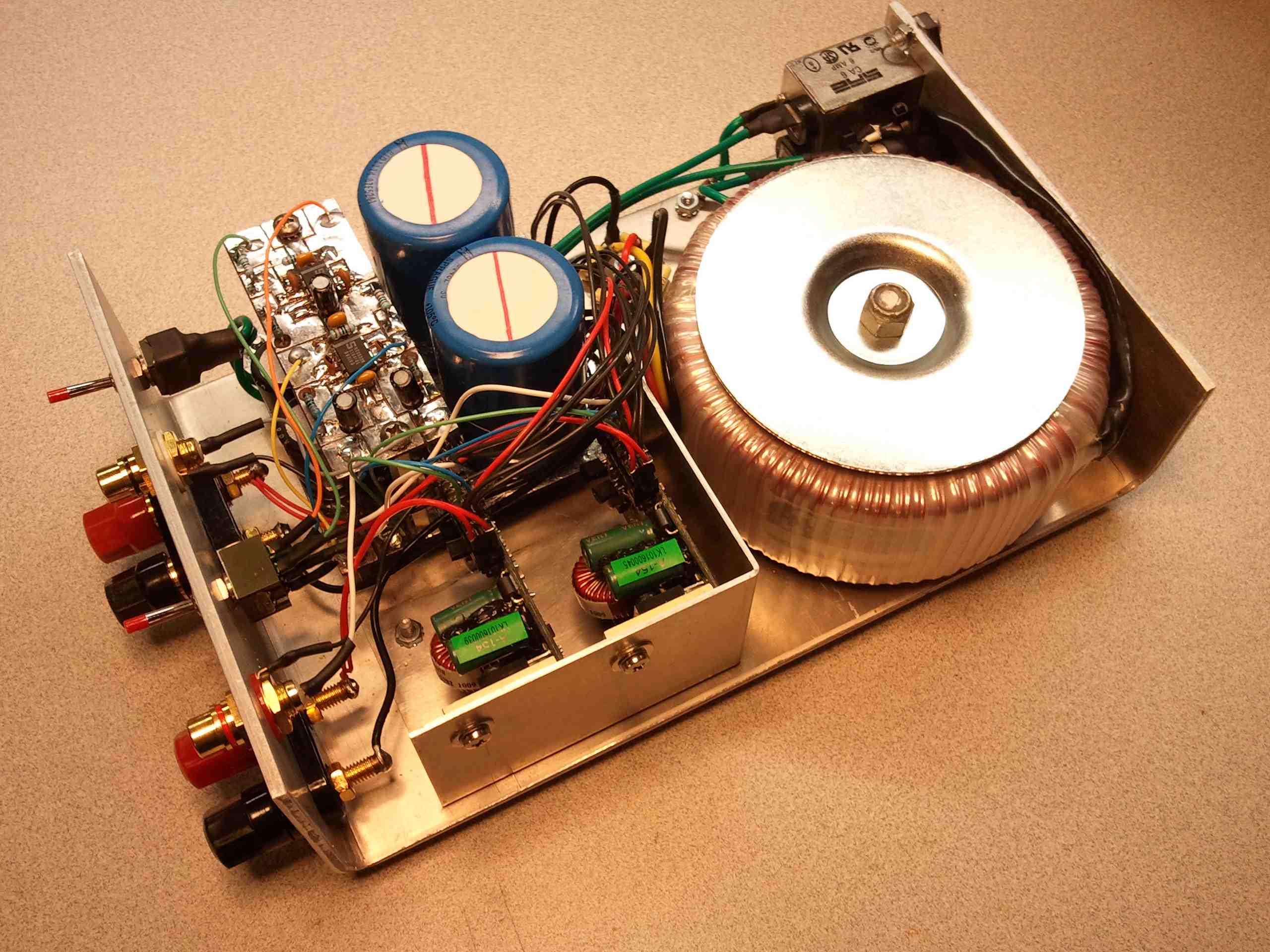

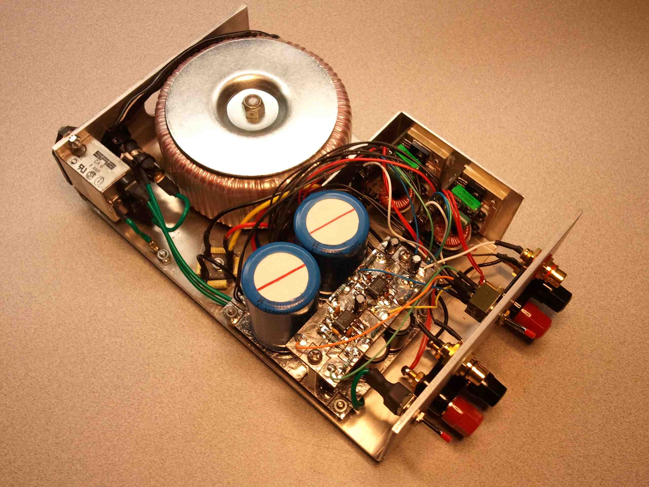

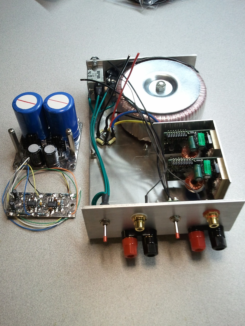

The first attached pic shows the progress in wiring the transformer primary and power switch. It also has the two A-154 modules mounted to a small aluminum bracket I bent from some thin material I had laying around. I also cut a piece of copper-clad board to use as my power supply board. I wired up the rectifier too and added some small film caps to bypass each diode junction.
The next pic shows the completion of the filter board with the large filter caps for the +/-40VDC plus the regulators and filters for the +/-12VDC required by the preamp and the A-154's signal section. Because +/-40VDC is too much for the LM78/7912 regulators, I had to add a voltage divider to the rails which is what the extra resistors are for.
The small circuit board next to the filter board is the preamp. The preamp is very basic consisting of just two NE5532 op-amps. The first op-amp is a stereo buffer between the input jacks and the power amp. The second device is set up with one channel being a summing-amp and the other channel serving as an inverting buffer. The second stage gives me the option of bridging to the amp to a mono output. The DPDT switch on the front panel will allow me to connect the two power amp inputs to either the stereo buffers or the two, summed, out-of-phase signals. Simple and clean! Plus, it will let me push the A-154 modules to their impressive bridged power level: 500W!
In case anyone's wondering why the circuit boards look strange, it's because they are not manufactured boards, but are simple boards made with a Dremmel tool. For low parts count projects, I simply draw isolating "traces" onto the board with a pencil and then Dremmel out the copper leaving isolated planes. These isolated areas then become the interconnecting traces. It's a method that works great for low parts count projects and for one-offs.
Almost there! It's getting close to the listening stage.
Paul

I finished building my PowerPhysics A-154 Class-D power amp! Yeah! It's taken a while, but actually went pretty smooth. Attached are two pics showing the completed unit. The next step is careful and thorough bench testing. With that, I will measure and verify noise, stability, bandwidth, gain and of course, power output both stereo and bridged. This is usually fun and progresses pretty quickly. Yet, it can be a bit nerve-racking the first time cranking it up to full power into a minimal load pushing the limit of the whole system. But, this can also be very satisfying when the amp performs well and remains stable and cool while belting out gobs of power. Sadly, this can also be the moment when countless hours of hard work and toil can go away in a silent wisp of smoke or a gruesome cacophony of melted wires, trembling transformers and shorted outputs.
Assuming all goes well, the final step will be the best part: the listening test. I'll report back to DIY when this step arrives.
Paul
