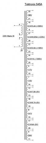

I also have a (non-functional CRT) Tek545 scope waiting to be parted out (it was purchased cheap with that condition known and I was pondering about converting it into a TekAmp at that time). Just curious, could the whole "regulated" HV supply complex (such as the DC +500V, +350V, +225V, +100V, and -150V(for bias?) outs) be used directly to setup the HV for the different stages of a push-pull amp (after minor voltage drop adjustments), instead of just chopping away the nice looking power transformer only? "~5-10 mV" ripple sounds good, or the regulation methods used in the Tek scopes are known to be undesirable for (hifi) audio amp applications? Thanks.

I don't see why not. You would have to mind the current ratings of the various regulators though.

Okay,so I did a quick-N-dirty load test on this Tek 120-120 trans..
I grabbed a few lightbulbs,and used them as loads. a 40W a 60W and a 100W,all were 120V bulbs,made by "GE".
(I only tested 2 windings with the 40W bulb. 7-14 and 5-10)
Line input was measured at ~122.5Vac (it was bouncing a bit.)

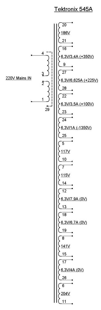

Windings 8-15,7-14,and 5-10 appear to have the highest current capability (lower DCR,and lower voltage drop with load.) Which is in-line with the testing done by Dave Paulson.
All of the heater windings were right at at 7.10Vac with no load.

Lastnight I did a bit more testing.
I connected each HV winding to it's own bridge rectifier,and 400V 470uf cap.Also,each cap/bridge has a 100K 'bleeder' resistor across it.
'No-Load' DC voltages: (-except for the 100K R's)
8-15 215Vdc.
7-14 175Vdc.
5-10 175Vdc.
6-11 305Vdc.
20-21 278Vdc
I connected the bridges+caps on windings 8-15 and 7-14 and 5-10 in series,and got +550V with a light 40W load (Big ~7.5K resistor)
With a LARGE 1.2K resistor,it managed 510Vdc. (at approx 425ma!) Approx 215W,by my math.
By connecting the windings in various ways you can get a wide range of B+ voltages! Approx. ~350,390,480,520,565,655V B+ are some of the combinations I came up with.
Getting 3-400ma shouldn't be much of a problem.

Hi everyone,
I was looking for info on Tektronix scope transformers and found this thread... I have a question that maybe somebody here can answer:
I have a 120-120 transformer. In order to tweak the HV that I want, I was thinking of incorporating some of the 6.4 volt filament windings in series with the other HV windings... Does anybody know how good the isolation is between all the 6.4 volt windings? I know one of the 6.4 volt windings has great isolation, but what about the others?

If you look at the 535/545 manual here: http://bama.edebris.com/manuals/tek/ you'll see that several windings are elevated to 100, 200, 350V (as well as the CRT winding at -1300V). So at least some are insulated to that degree. If you put those windings in series with a 120V winding with a bridge on its output (- grounded), they will never be more than 200V away from ground. Use multiple bridge rectifiers as Tek did and stack the DC supplies. No need for high voltage caps, no worries about PIV of rectifiers.
I've spent many years in the surplus test equipment business repairing those old Tek products. Those vintage scopes had power transformers that carried a virtual life time warranty. Meaning if a PT every failed, Tek would replace it and/or send you a new transformer. Of course that no longer applies anymore to the old instruments. It also doesn't apply to the newer stuff which simply isn't built as well as the old tube boat anchors. Like many companies who's products have evolved downwards, they rely on their legacy to fill some gaps. But I think you can safely assume that the transformers were made extremely well and will serve safely with what you're considering.
