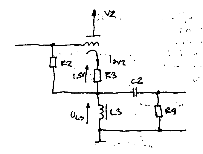

Nope. The original question was about impedance matching. Nothing about biasing. The main reason behind using a choke in the cathode in parafeed xformerless was low voltage at the output. Just in case something goes wrong with a cap.
I actually made it in headphone amp based on 6C45PI as an output tube.
--Yag

Shoog said:
How did you set your bias point ?
Shoog
That is what I have done. See attach.
--Yag
