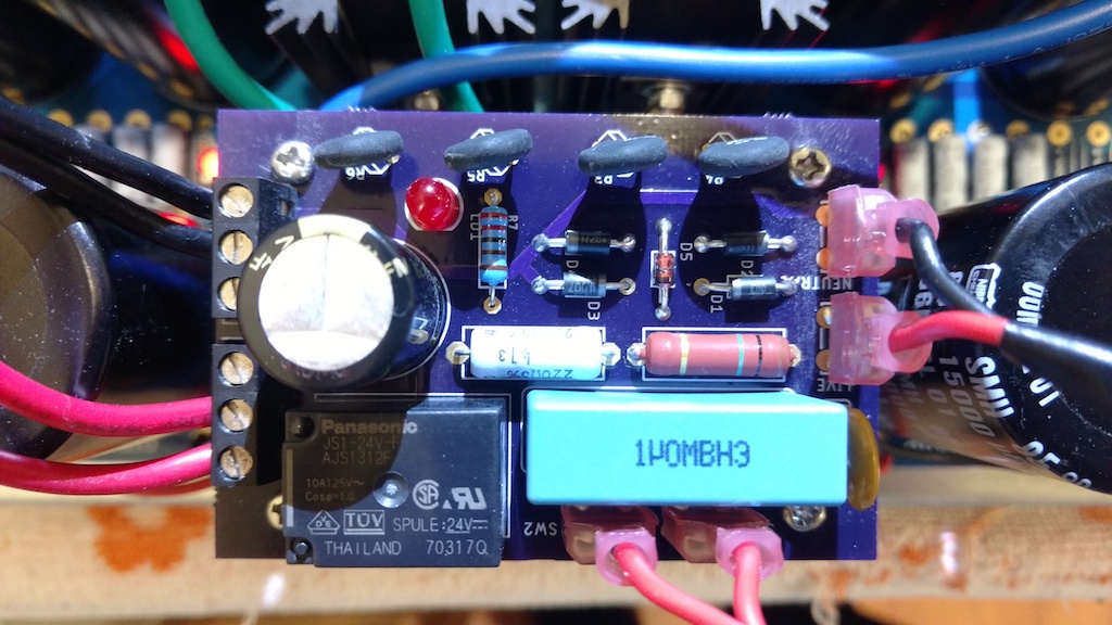

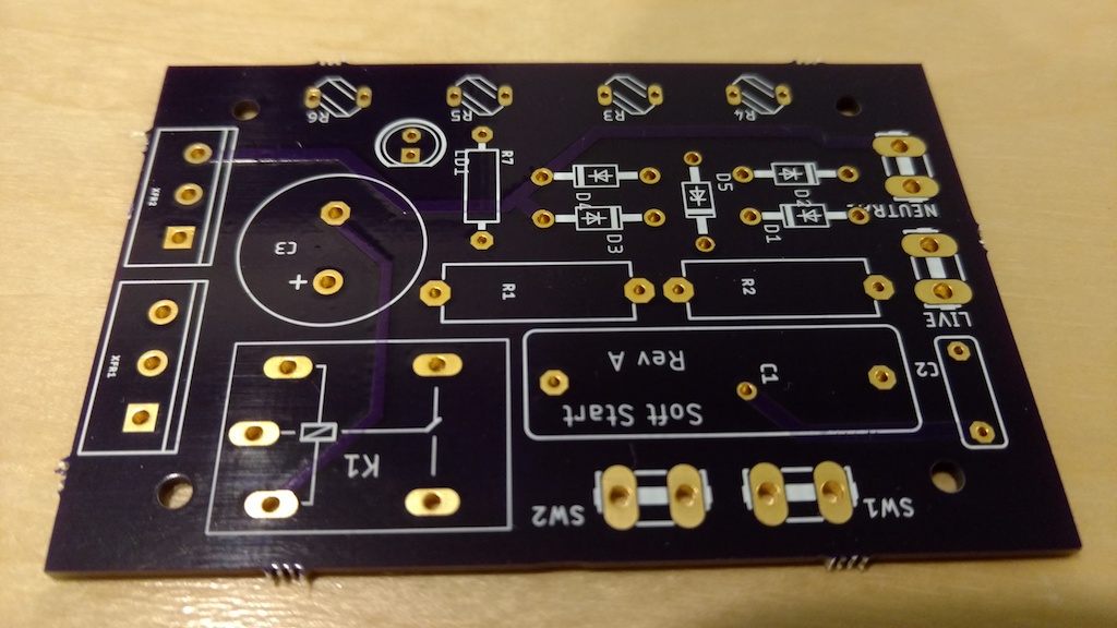

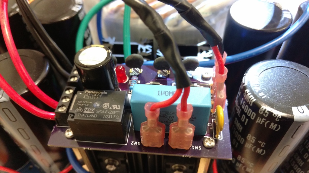

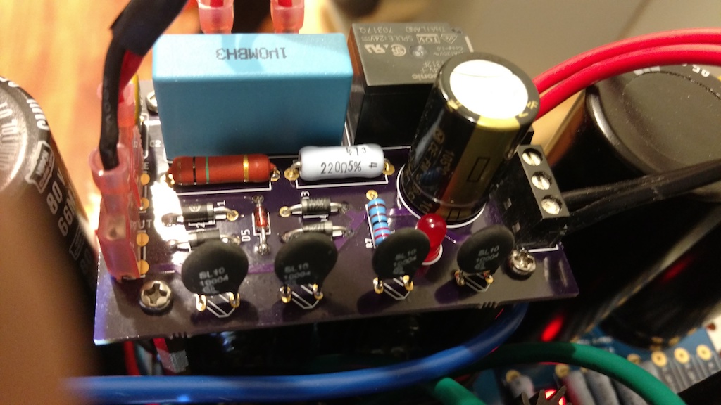

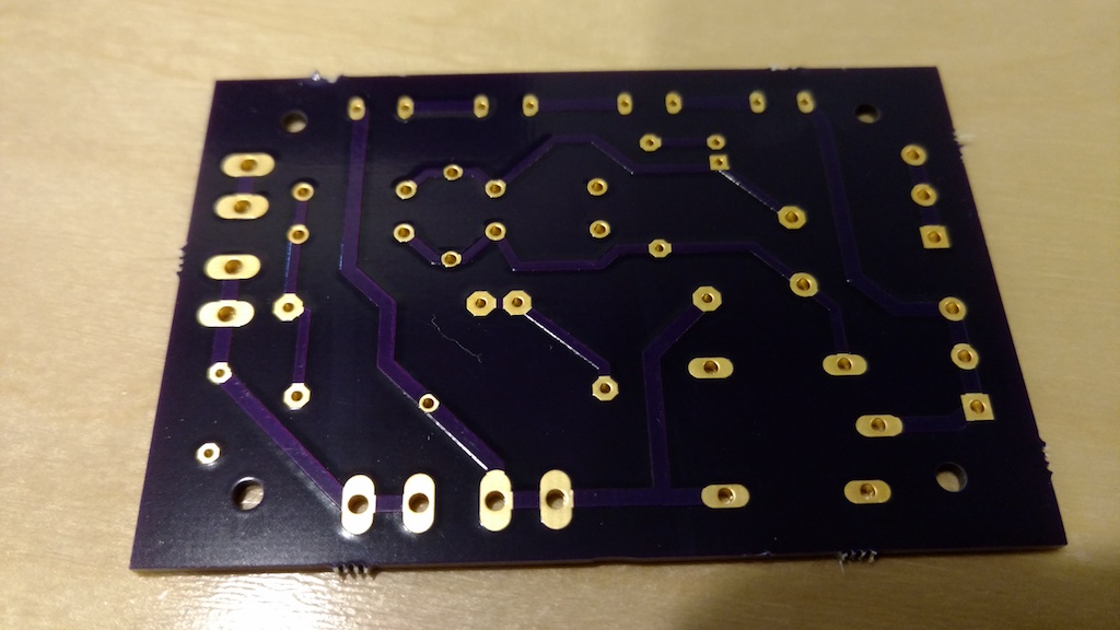

I have 2 left over boards for the Soft Start with room for 4 CL-60 thermistors serially connected instead of 4 power resistors as in the original board. The rest of the schematics is the same and the PCB uses the same BOM as the one sold in the store (except for external connectors - see the pictures). I will sell these at cost ($12 + shipping). Please PM if interested.
Here are pictures of the board (before I assembled it and after) mounted on top of the Universal PSU. The PCB dimension is the same as one section of the Universal PSU with rectifiers (55mm by 75mm) and mount holes are drilled at 40mm by 60mm to match those in the Universal PSU. Selling boards only, not the parts. Usual legal disclaimers apply.
