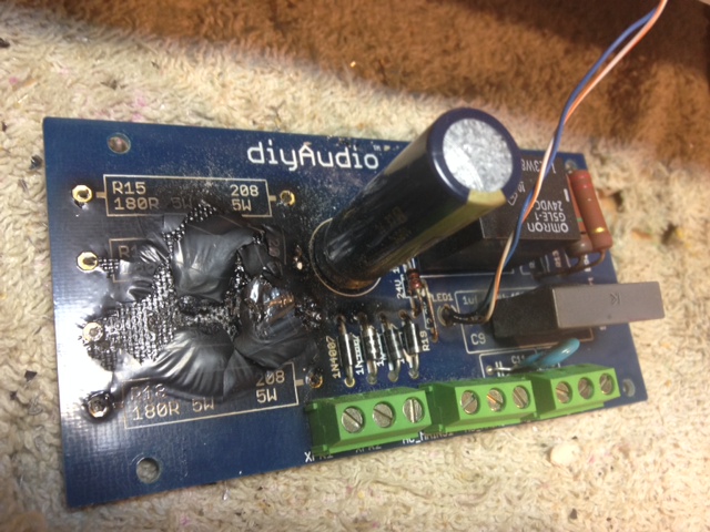

Given the late stage of this project and my very limited understanding of the way the circuit works causes me to want to resolve this problem as simply as possible. If I can get the diyaudio softstart board to work in this application then I'd like to do so, and worry about a better softstart implementation the next time.
Until the resistors blew, both amps seemed to be working just fine; both F5T V2 amps were cycled on and off several times before I started letting them warm up to set the bias and, even then, they worked for a few hours before the resistors gave up their smoke. I'm still unclear what caused this problem to occur in both amps.
The BOM recommended X-class caps in the 0.33 to 1 uF range and posts indicated that the smaller the cap the longer the delay. Because the toroids are 1,000 VA (with 24 VAC secondaries in one amp and 32 VAC in the other) and the capacitor banks are 160,000uF, I figured a longer delay made sense. Clearly, that wasn't the case. I could try adding .56uF X-class caps in parallel or replace them altogether with something larger. I could also change the power resistors (presumably to something higher).
My inclination is to keep things simple, leave the power resistors at 75R apiece and get 1uF X-class caps. Does this sound reasonable to you?
Scott
0.33 could work at 240 volt ac mains, for 120vac, 1uf is better...

Just an update at this stage: the replacement power resistors and 1 uF x-class capacitors have arrived and I'm home this weekend, which means it's time attempt a repair. I removed the blown power resistors and x-class 0.33 uF cap and, as you can see from the first photo, this SoftStart pcb was scorched by the toasted power resistors (the gap of about 8mm between the resistors and the pcb was clearly inadequate). The damage does not appear to have affected the board traces, which were checked with a meter, and everything else looks okay.

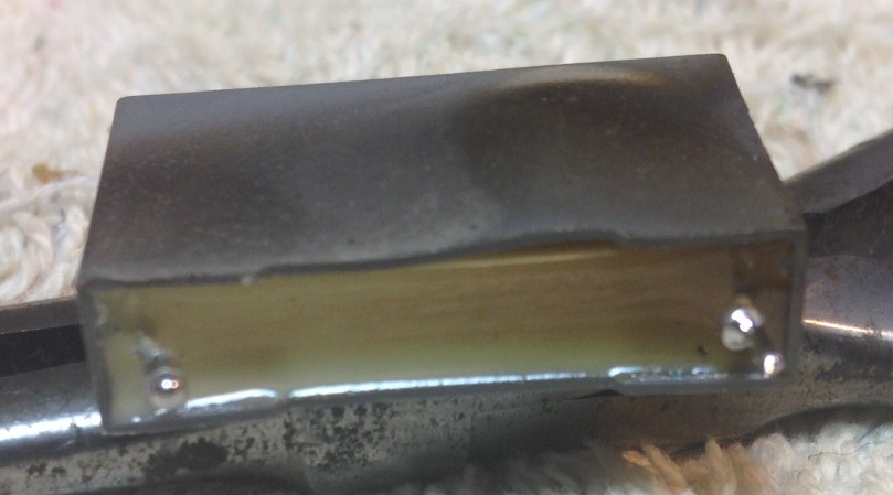

The second photo shows the damage the 0.33 uF x-class cap endured.

...and the results appear to be in. The power resistors and x-class caps were replaced in the two F5T V2 amps and all is well. I'm still using 75R/5W power resistors (per AndrewT's advice) and swapped in 1uF caps for the 0.33uF caps (per AJT's advice). Both amps have been running beautifully for about 10 hours each.
I suggest that the diyaudio SoftStart BOM be updated to provide a more nuanced recommendation for the x-class caps based on mains voltage.
Thanks to 6L6 (for the diagnostic advice), AndrewT and AJT!
