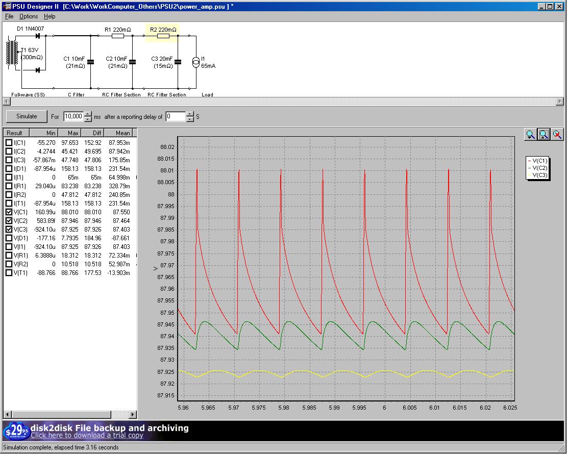

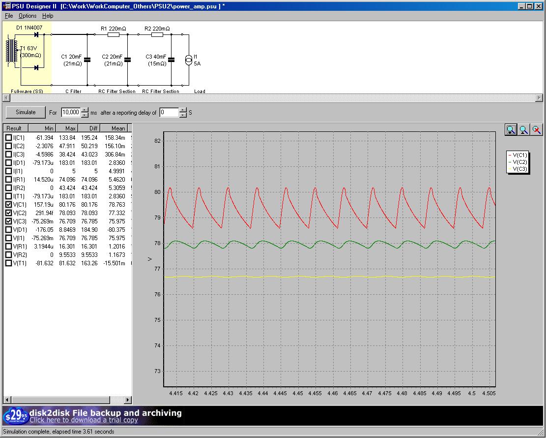

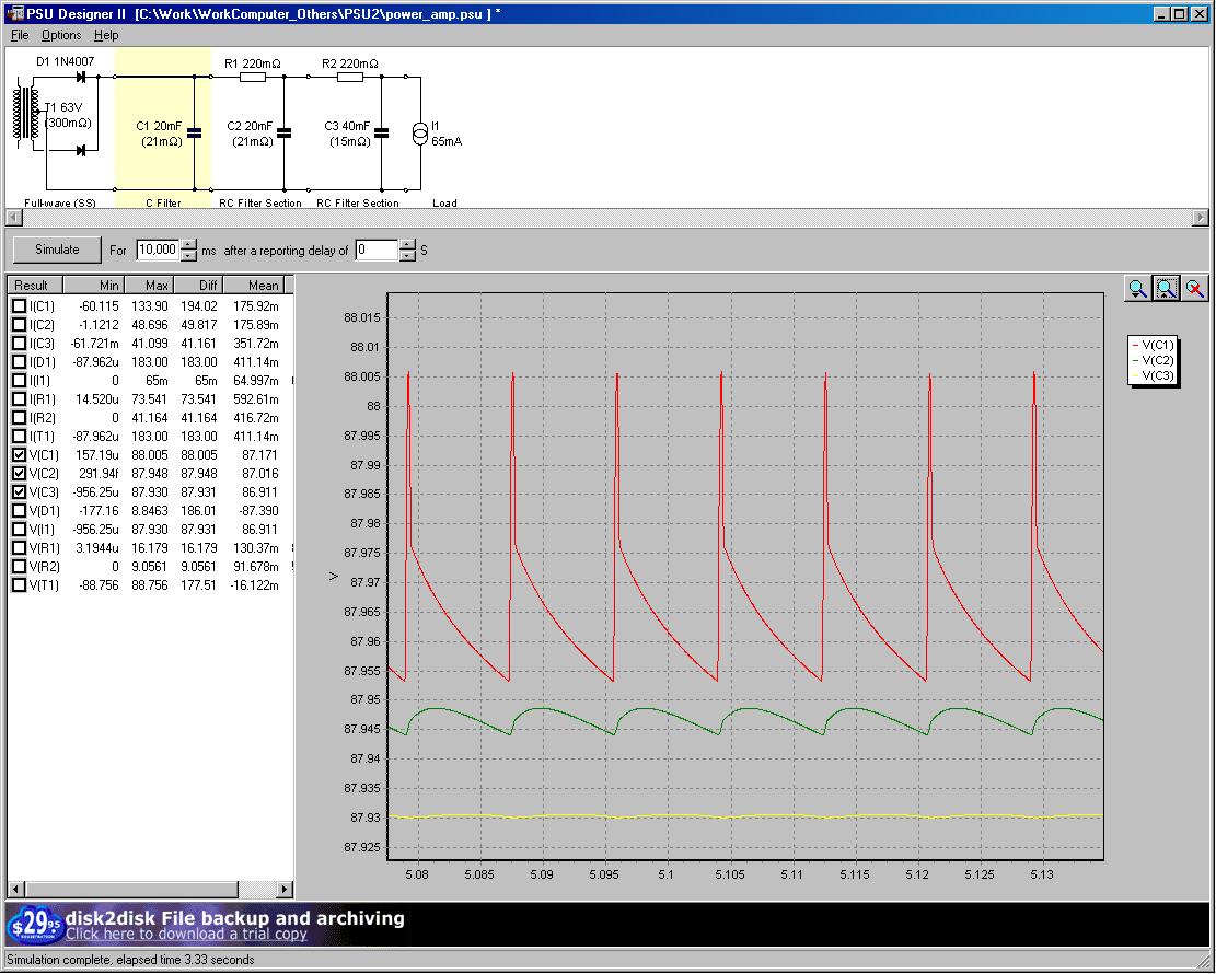

I think you are right when the capacitance is very low. However, I think once adequate amount of capacitance is present, the capacitance has only a little effect on the amplifier power.
I am attaching four simulation graphs to illustrate. They were simulated using PSU2. Using LTSpice would produce simular result.
The first graph comes from my planned PSU for my new amplifier. I assumed 5A current draw.
In the second graph, I doubled the amount of capacitance. As you can see, the voltage has not changed by much.
The third and fourth graphs are the same except with idle current of 65mA. See doubling the amount of capacitance has not changed much the voltage.
From these 4 graphs we can also see that the doubling the capacitance has not changed much of the voltage sag when large current is drawn.
That was why I suggested that the amount of capacitance has more to do with ripples and THD-N than to amplifier power.
Please correct me if I am wrong.
