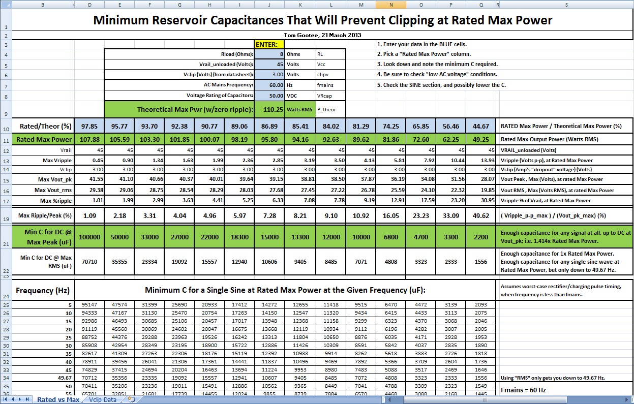

I finally figured out how to calculate the worst-case minimum required reservoir capacitance for a sine signal at less than the fmains frequency, in the presence of rectifier charging pulses.
There's an interesting table of C values versus frequencies, for each de-rated max output power that could be chosen for a given theoretical max power, in the attached spreadsheet.
You can enter your Rload, Vrail, fmains, etc, and it calculates everything else for you. It basically shows what Rated Max Power you would have, for different capacitances, in order to avoid clipping when operating at the rated max output power.
It ALSO shows the lowest frequency sine your amplifier could reproduce without clipping, for a given reservoir capacitance, when operating at the rated max output power.

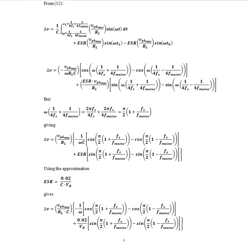

I also made an MS Word doc that gives the equations used in the spreadsheet, with partial derivations. (I didn't want to take the time to enter the many equations for all of the steps of the derivations.)

For all of the math lovers out there, I added the detailed derivation steps for the case where the intervals between charging pulses are less than one-half of the sine signal wavelength (i.e. sine frequencies less than AC mains frequency). I also used MS Word's equation editor to format most of the equations that were previously written with plain text.
If you don't have a compatible version of MS Word, a sample is attached as a jpg, so you can see what you're missing.

I made a minor change, so that the top row can be changed, to make it easy to change the rated max power's percentage of the theoretical (zero-ripple) max power. And I added a few more columns.
Screen images and new version are attached. In the sample screen images, I tweaked the rated vs max power percentages so that the capacitance values came out to more-or-less standard cap values, or combinations of them. The only change I made between the two was to change the rail voltage from 32.7 Volts (for 50 Watts using 22000 uF) to 45 Volts (for 100 Watts using 22000 uF).

So about 200,000 uf is about he max amount to have an effect on power supply stiffness ?
No.
The stiffness is relative to the load current.
A small low current amplifier will "need" less capacitance than a large high power amplifier, for the same apparent stiffness.
please forgive me for Stating a general rule of thumb kind of value for this range of amps when others are looking at exact values. The side effect of 100,000 uf and larger cap is the turn surge must be controlled but we all know that. I should have explained my previous statement better about the 200k uf amount . Gootee has done some very good work on showing the range of cap need to produce what level of power supply rigidity . Andrew T your point is well taken.
"Vrail" is NOT the "unloaded" value.
For some reason I wrongly labeled the Vrail entry as the "unloaded" peak rail voltage. I apologize for any inconvenience.
The rail voltage should be entered for loaded conditions, for "Vrail".
i.e. From the unloaded rail voltage, one must subtract two diode drops, assuming the diodes are conducting the current that would result if the load had a constant DC voltage across it, with an amplitude equal to the peak voltage of a sine at the maximum rated output power. (i.e. Output power = 1.414x the rated maximum output power.)
If in doubt, just use the largest diode drops that are spec'd for the maximum forward current of the diodes to be used.
For silicon diodes, it would probably be safe to subtract 2 to 2.2 Volts from the transformer secondary's peak output voltage. For Schottky diodes, it would probably be safe to subtract 0.9 to 1.0 Volt.
No problem. Note that in the latest version of the spreadsheet, you can just increase the percentages in the blue row, near the top, to see larger capacitances. For example, enter 99.9 percent, or 99.99 percent. That makes the PSU try to leave almost no room for any ripple, which makes the needed capacitance value "excessive". You might even have to widen the columns, to see the resulting numbers. (If a number is too long to fit within the column width, it might display as ######## instead of the number. In that case, just go to the very top, where the column letters are, and hover over the line between two columns. When the cursor changes, you can left-drag to widen the column to the left of the cursor.)
