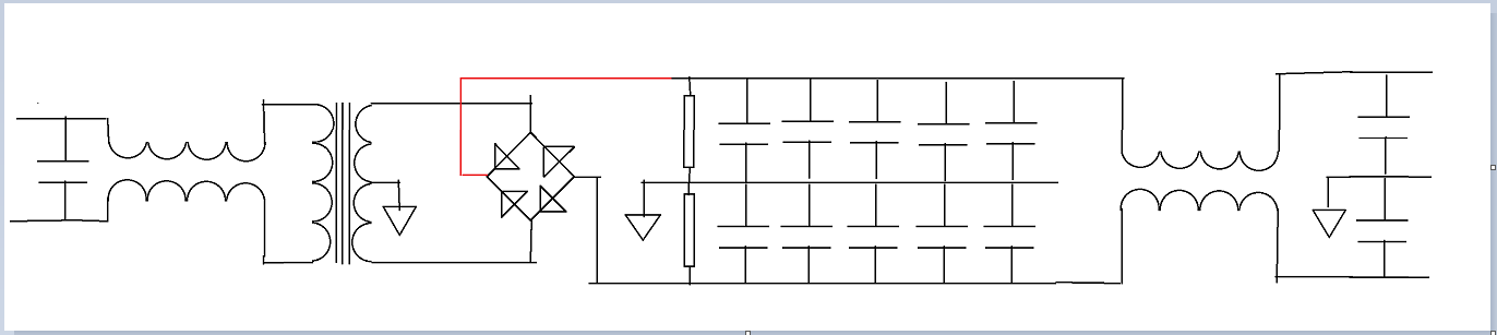

1. It is mandatory to filter power coming into transformer
2. Use appropriately sized transformer
3. Use a regular bridge rectifier
4. Use an array of parallel caps for main reservoir to slow down the main reservoirs transient response. (We do not want this part of the PSU responding to transients)
5. Use bleeders, fuses etc for safety during servicing, thermistors for slow start if needed etc
6. Use decoupling caps to ensure that the transient slows down before getting to main reservoir
7. If there is chance of noise coming in via a sibling winding, take care of it
8. If PSU unit is on the same board as load circuit. Use a filter between main reservoir and decoupling caps
Circuit to follow,
.........Tom hope this helps
Looking at this model it becomes easy to see why the pi filter is there on many of the PSU PCBs on diyaudio. And also why there are those that sweat multiple paralleled caps (apart from cost savings, the issue is, how slow should one make the reservoir bank ?).
Circuit to follow,
Some good advice and good observations mixed in with complete coddswallop.
1. mandatory?
3. other rectifiers?
4. slow down the main reservoirs transient response?
. We do not want this part of the PSU responding to transients?
6. Use decoupling caps to ensure that the transient slows down?
8. Use a filter between main reservoir and decoupling?
Does anyone agree with "every" suggestion of OnAudio?
Yes.
1. No, but sometimes it may be helpful.
2. Yes, but fairly obvious.
3. What is an irregular bridge rectifier? If you meant "don't bother with Schottky/soft turnoff etc." then say so.
4. No. An array of parallel caps could be 'faster' or 'slower' than a single cap, as it depends on the inductance. I can't see how 'faster' might be problem.
5. Yes.
6. Yes, if you are saying that decoupling needs to be properly done, near the point where the transient is developed.
7. Yes, although the term 'sibling winding' may be unclear. Rectifier spikes can hop from one secondary to another.
8. What sort of filter? A low value resistor might be sufficient.
