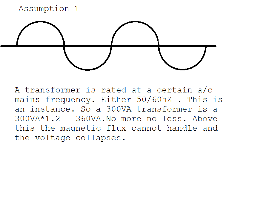

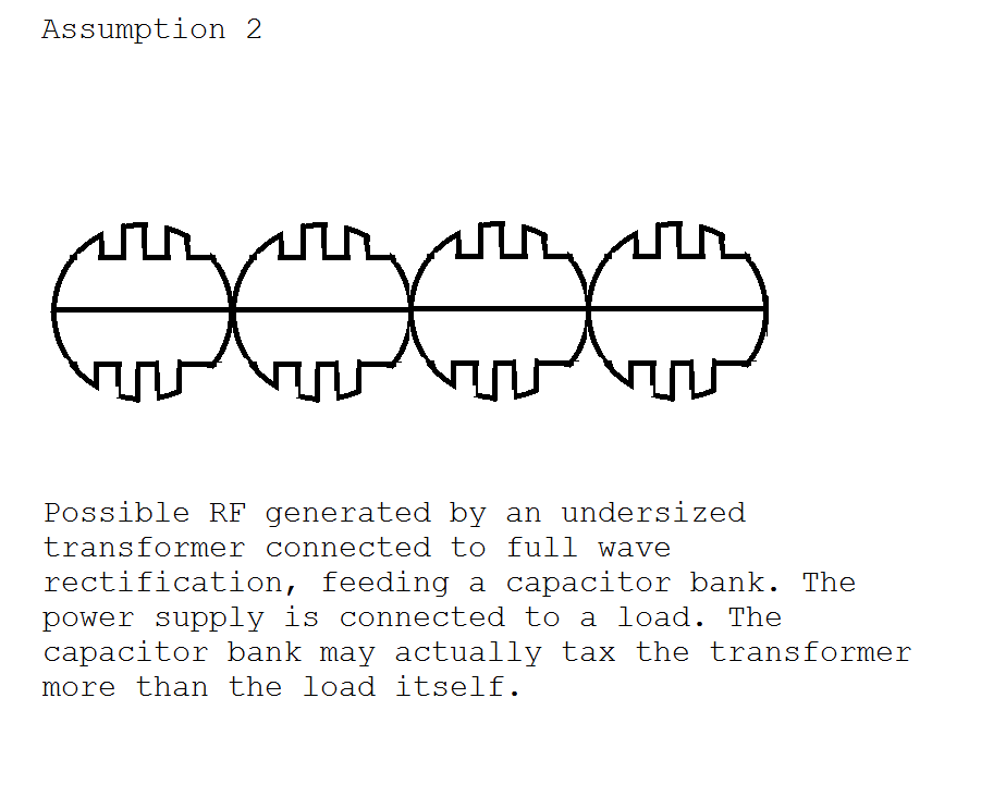

assumptions
How valid are the claims below ?
I think the second attachment of post 1532 is showing a futile attempt of continuing to pile on more capacitors to the too small transformer. That is counterproductive. Some of Tom's spreadsheets listed those conditions as impossible, invalid, or a negative number.

And in my spreadsheet, the capacitances are what would have been _required_, in order to have no possibility of even a tiny bit of clipping. It had nothing to do with adding extra (or too much) capacitance to an already-OK situation. It only meant that the cases being considered were either impossibly underpowered, or almost so.
Though, piling on more capacitors, of the right type and in the right area is highly productive.
