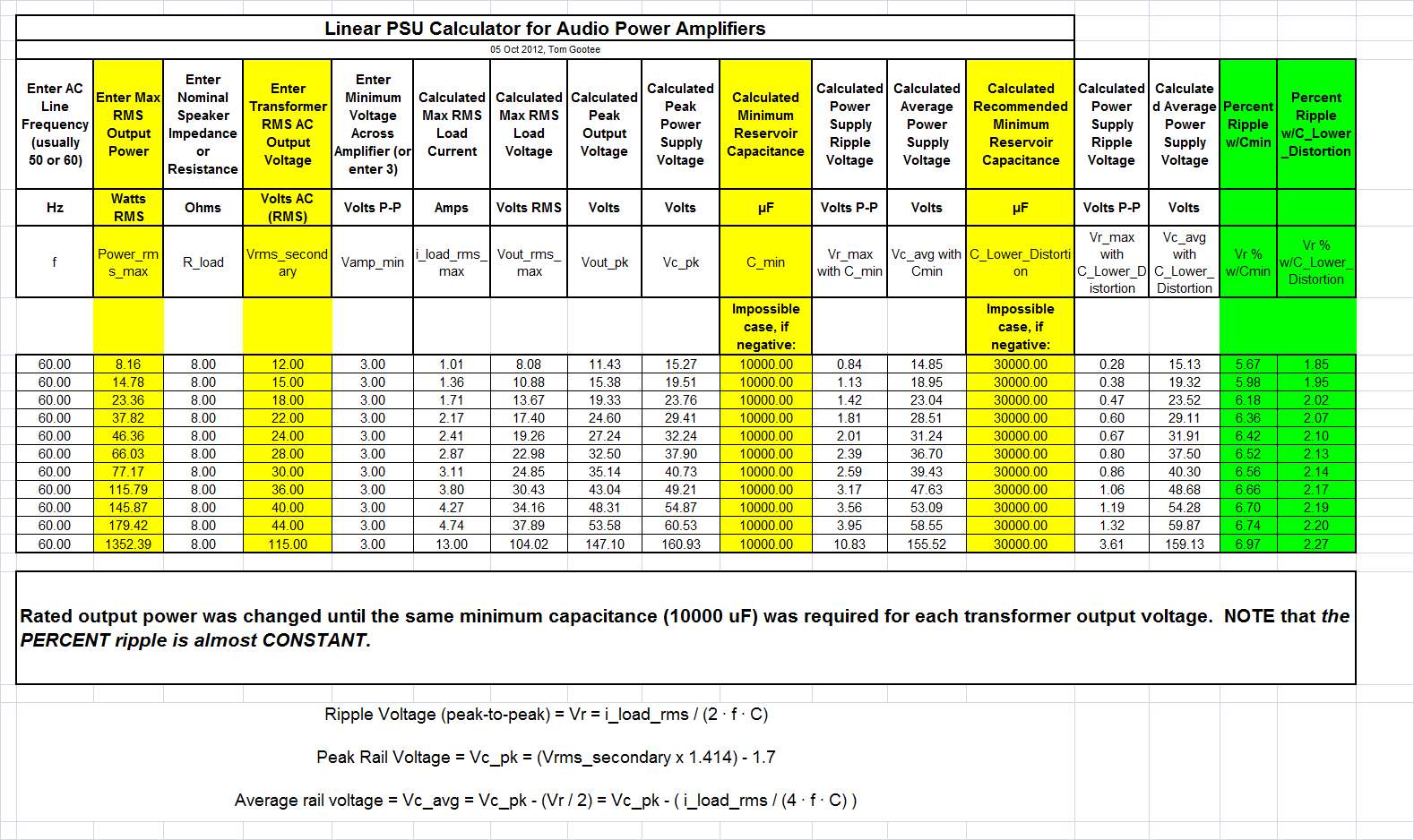

Yeah, it started to get a little fun to play with, again.
One cool thing I noticed about the spreadhseet, just by letting it calculate for 50, 75, and 100 Watts, with 28, 30, and 35 Vrms transformer for each of those, was how heavily-dependent everything is on the VRMS of the transfomer output. e.g. 28 VRMS can do 50 Watts RMS easily-enough, with a minimum of 3150 uF. But when you try to go to 75 Watts, it needs a MINIMUM of almost 100000 uF, just to stay out of the "gross distortion" region. I liked seing that pop out, because that type of behavior will make it very clear whenever someone is trying to push a transformer way too close to doing the impossible.
If no one else does it, I will try to generate spreadsheet lines for ALL of the permutations of the Vrms, Rload, and Pmax inputs, within some min-max range and step value for each one, and see what happens!
Then someone could eliminate all of the lines with extremely-large C values, and all of the lines with negative ("impossible" case) C values, and we would be left with a "map" of the areas that are reasonable combinations of Pmax, Vrms, Rload, and C. Should be useful.
I wish I was an Excel and Visual Basic (the macro language for Excel) expert. There are probably some interesting perspectives that could be mined, from the data, especially if a brute force approach wasn't necessary.

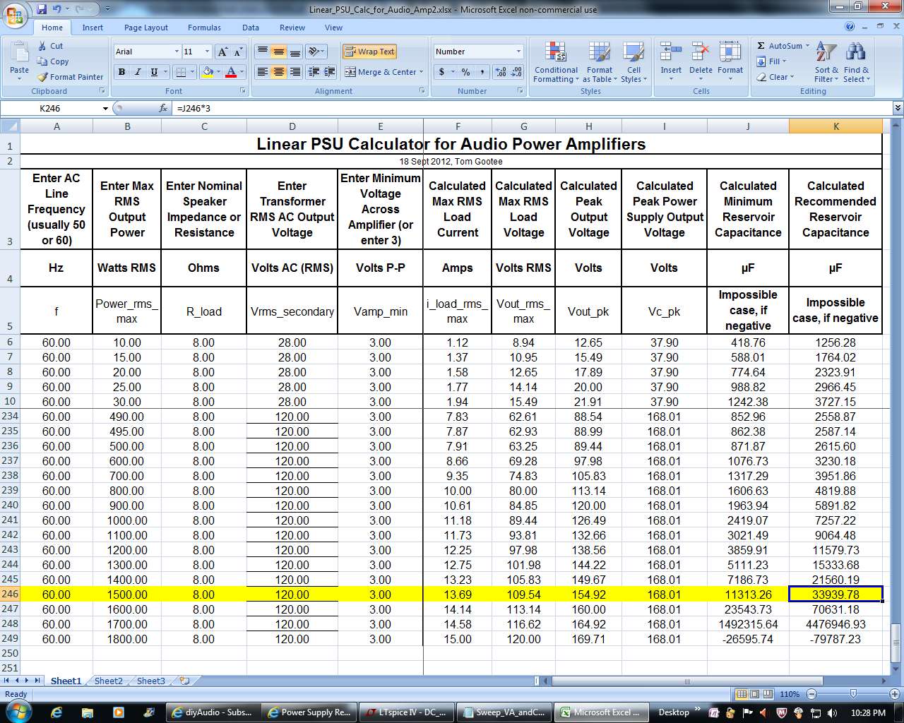

That spreadsheet is a lot of fun, to play with.
See attached! I don't even NEED a transformer! I could just run straight off of the 120-volt mains and build a 1500-Watt amp, with 33000 uF per rail (or maybe only 11000 uF)!
Or how about 500 Watts with only 1000 uF per rail (or maybe 2200 uF for a "deluxe edition")?!
Might have to worry a little about PSRR... (grin).

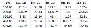

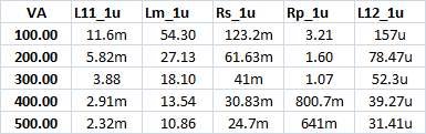

You should add the transformer effective secondary resistance to your table, as this is the crucial parameter. VA rating by itself only tells you whether the transformer will get too hot. Two transformers with the same VA could have different resistances.

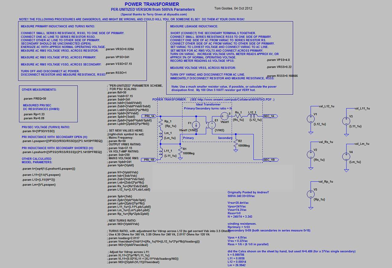

Attached are the transformer parameters (measured off of the LT-Spice plot screen, manually), and the transformer model's schematic.
The measured transformer was a 250 VA secondary of a 500 VA 35-0-35 transformer with a 241-VAC 50 Hz input voltage.
In spice, the transformer was set for the following, when the data in the small table were collected:
; SET TRANSFORMER RATINGS:
.param Vrms_setting=28
.step param VA_setting 100 500 100
.param mains_freq_set=60
.param mains_rms_set=115.9
DF96,

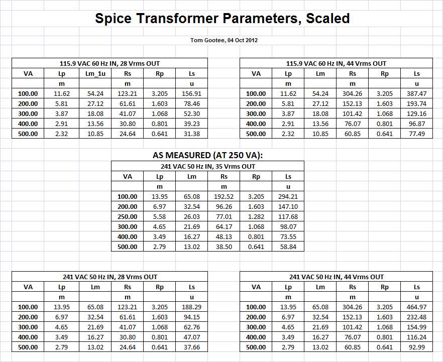

I was finally able to set it up so that the transformer subcircuit parameters' measurements can print automatically, into the LT-Spice log file, making it much easier to acquire them.
I have attached some tables that show the primary and secondary inductances and resistances, and the magnetizing inductance, for the originally-measured input and output conditions, plus two different input and output voltages and line frequencies.
If someone who knows about scaling transformer model parameters would care to comment on how far they might reasonably be able to be scaled, that would probably be quite useful.

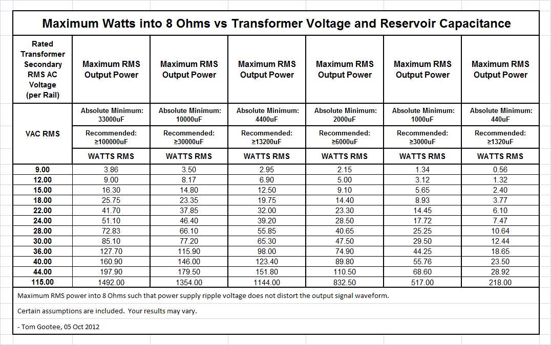

After filling in the spreadsheet I posted earlier, with lots of combinations of transformer voltage and maximum output power, and 8 Ohms for the load, I pulled out some data for a few values of reservoir capacitance and made it all into a table, just to illustrate the trends and to have as a handy reference.
Of course, some assumptions are embodied in the data, such as the 1.7-Volt rectifier drop, and the 3-Volt minimum between the ripple voltage and the output signal voltage. So your mileage may vary. Still, it's an interesting type of table.
Tom

Here are two examples of the latest version of my CMIN-calculating spreadsheet. They each contain lots of combinations of values of the transformer output voltage and the maximum output power. One is for 8 Ohms and the other is for 4 Ohms (They are the same spreadsheet, except for the values entered.). Both .XLS files are in the zip file.
Tom
Interesting. Seems to show that even for high power there is little point in going much above 10000uF, and for lower power diminishing returns set in from 5000uF.
Turning it around, if you design a 100W amp then find that it can't quite do continuous 100W low bass then you can do one of the folowing:
1. massively increase the capacitance size
2. somewhat increase the transformer size/voltage
3. just call it an 80W amp, with excellent transient capability!
