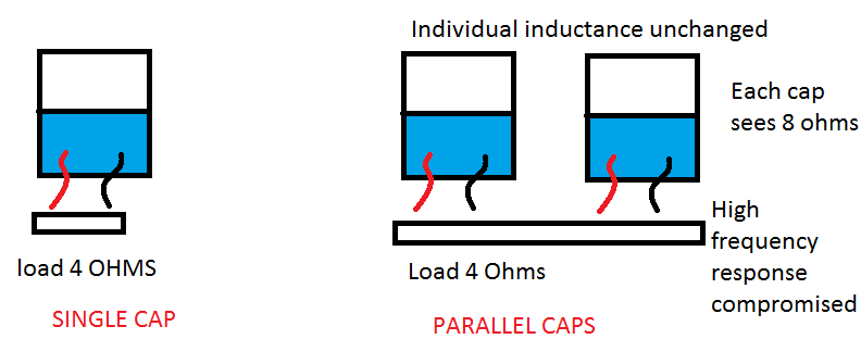

Fun stuff about parallel caps

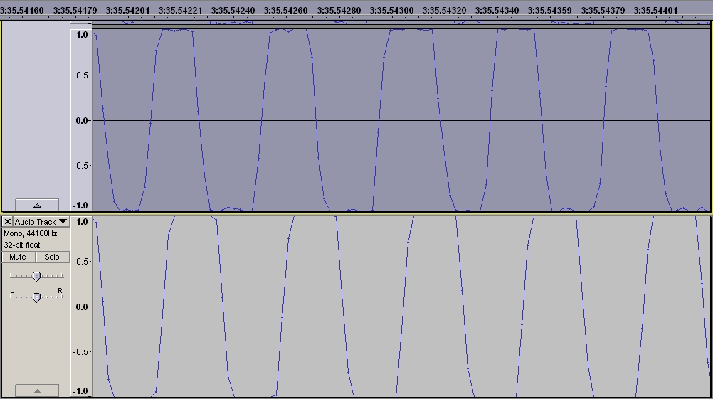

THE transient you have to worry about in a music signal is when the waveform has a very short rise time, a sharp slope so to speak. This is hard work for everything: ESR, ESL of the caps, the PSRR and FB circuit of the amp are severely tested by this, separates the men from the boys ...
As an example of how bad that "transient" music signal can be, the following is about as rough as it gets, I reckon. This is an excerpt from a real music track, bizarre as it seems, Iggy Pop and the Stooges, Raw Power album, "I Need Somebody":
But, the funny bit is, only the top waveform is one channel from that album, the bottom track is a 2.2kHz sine wave generated by me, that's been amplified 10dB beyond clipping!! Hmmm, this is getting mighty close to a square wave, available on a music track - now, just set this on A-B repeat, and uuup the volume ... ;) !
Frank
Might be fun, but wrong. HF performance is improved by paralleling caps, not compromised. Each cap sees half the load, as the picture said. This halves the time constant, so doubles the rolloff frequency. Remember, for LR circuits the time constant is L/R so bigger R means faster response - the opposite to CR circuits.

Hi Fas,
can you tell if that upper trace (CD music sample) is approaching the maximum slew rate available from CD's 44.1kS/s?
Would that be related to a 20kHz signal slope? And of what amplitude?
Not quite, the slope corresponds roughly to that of an unclipped 8kHz sine wave; if you look closely at the waveforms you can see 2 or 3 data points on each vertical section. Maximum slew rate would be one data point at full negative excursion, and the next at full positive excursion, something that could be created in a program like Audacity.
This would correspond to a maximum amplitude, near enough 20kHz signal, which could be recovered with better than -90dB distortion. Correctly behaving digital is remarkable stuff ...
Frank
