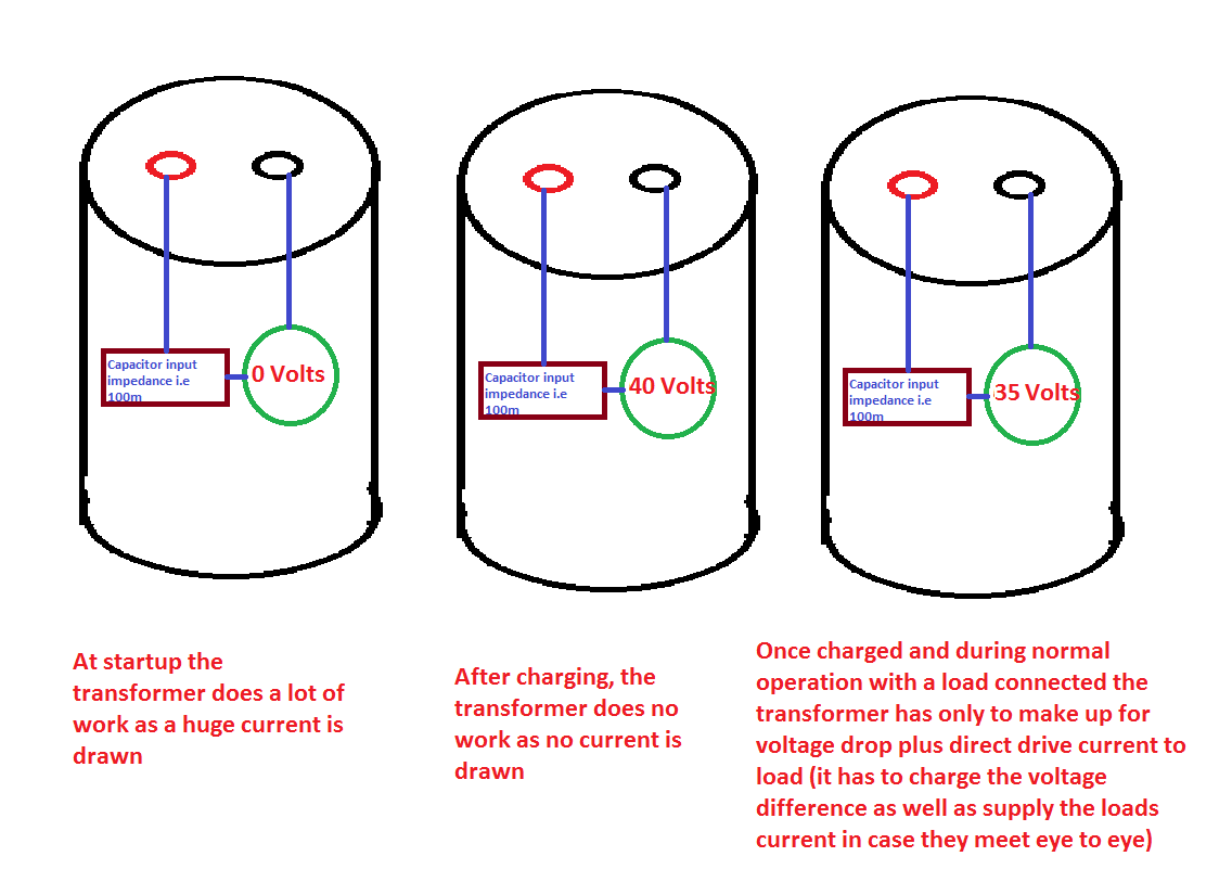

A 1A rectifier with a 1000µF cap and a 1A load will have roughly 1A peak charging current (ignoring the transformer DCR for a minute). Increasing the cap to 100,000µF will increase the peak charging current to 100A and blow the rectifier to silicon nirvana (and let the magic smoke out).

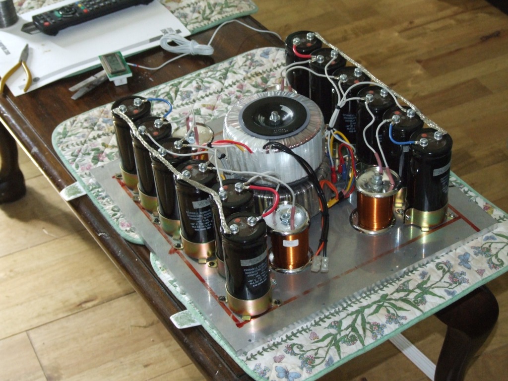

There is a definite trend towards a big bank of smaller 1000uF caps rather than huge 10000uF caps. Seems like there is something there. If you search the Chip Amp forums, the ridiculous go for 20-30 1000uFs in parallel.

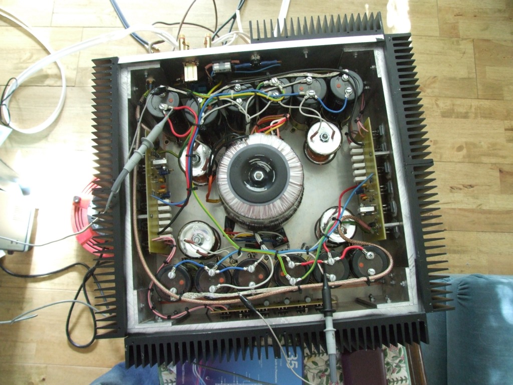

Personally I run a Class A 100W amp with 6 x 33000uF Computer Grade Dubilier Caps.
That's 12 caps for 2 x +/-48V. Running in dual MonoBlock.
I inherited this from my brother-in-law. It is a clone of a Pass Aleph 4.

Pehhaps I did not make the point correctly, the 100A peak is repetitive, it will occur every 8.3mS (10mS/50hz), it is not the initial turn-on surge.

Okay djk firstly I have a comment, you will only draw the full current if you have depleated all the energy from the cap, the amount of current flow would be directly proportional to the difference in terminal voltage on the cap and peak voltage of the transformer. But I did say in the specification that we must assume 100% duty cycle and in that case you are correct.

Just keep in mind that a capacitor discharging does not do this in linear packets of energy. Each packet is slightly smaller than the previous due to a voltage drop. But you are correct. I do not understand your question though, what is there that you need solved
