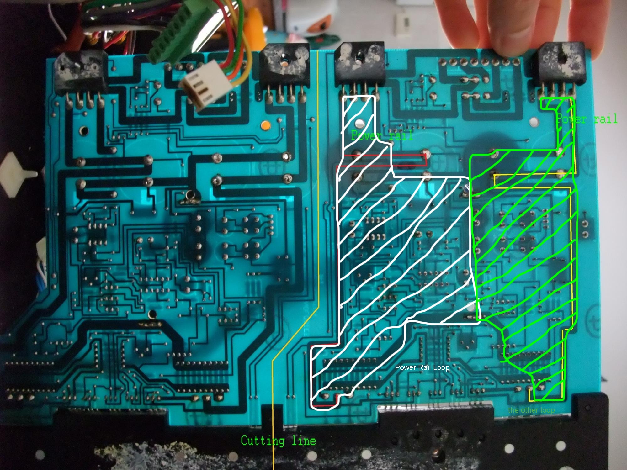

yes, if for no other reason than large batteries make it really, really easy to wire up gigantic loops.
here's a good example of large loops in a PCB:
the EL cap placement means they reduce the loop area by very little - only the bit above them. At higher frequencies where the cap ESL becomes significant, the loop area is as shown

Daniel,
look at the PCB layout above. see the highlighted loops? pick one - lets say the white loop.
Break the white loop into 3 separate areas:
1 - the area above the electrolytics (up to the rectifier)
2 - the area directly beneath the electrolytics
3 - the area below the electrolytics (down to the O/P transistor)
these three areas correspond to three sets of stray inductance (which is proportional to loop area):
L1 - Inductance between the caps & rectifier
L2 - Inductance between the caps themselves
L3 - inductance between the caps & the O/P transistor
Its not too hard to physically calculate these inductances (F.E. Terman's Radio Engineers Handbook has pages of relevant formulae), nor is it hard to measure them given a blank PCB.
But without calculating or measuring anything, we can make some observations:
1. L3 >> L2 & L1 - the bulk of the loop area is between the electrolytics and the O/P transistor. It doesnt matter what you do to/with the capacitors to reduce ESL if this loop remains untouched. Its the 400lb gorilla thats defacating on the carpet and kicking holes in the walls during subjective listening tests.
2. think about the mutual inductance with the 1uH air-core output inductor - thats not going to help now, is it (hopefully they are at least orthogonal).
3. L2 adds to the capacitor ESL (and is probably bigger).
4. L1 doesnt really stop at the rectifier - the inductance (loop area) of the long dangly wires to the transformer need to be included too (although if cable tied together this is still a lot less than area 3).
A DC bus is supposed to be exactly that; a sizeable chunk of this thread has been demonstrating that good DC bus layout is important. However many of them are far from low impedance, and as shown there can be all manner of exciting inductive couplings present. "normal" wiring and PCB layout practises in audio amplifiers are horrendously bad, for no apparent reason I can see (other than applied misunderstanding).
So before you can attempt to compare the effects of various caps you really need to:
- ensure all xfmr wiring is short & tightly twisted
- ensure the DC bus PCB layout is extremely low inductance (regardless of how you do it, no single-sided layout will ever be good in this regard)
I'd also make sure the output leads are tightly twisted, and ensure the L,R output inductors are orthogonal and as far away as possible from each other and the AC input (this has the extra advantage of increasing immunity to external fields).
and then I'd measure the impedance of the DC bus (seen from the O/P transistor) to see how good my cap bank was. its not that hard to keep the impedance in the mOhm range up to a few MHz, and with careful design that can extend to a few hundred MHz.

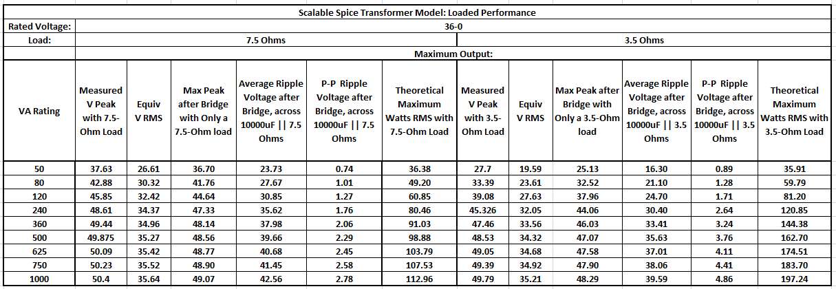

The table in my last post had the theoretical maximum output power for a single sine tone, i.e. it took the average ripple minus half the p-p ripple voltage and assumed that was a sine's maximum-possible peak voltage. So it divided by sqrt(2) to get the RMS voltage then used V-squared over R to get power. Consequently, those values appeared to be very-conservatively small.
The attached similar tables give the theoretical maximum output power assuming a square wave instead of a sine wave. For a square wave, the peak value IS the RMS value. So the theoretical maximum power shown in these tables really is around the maximum usable power (for cases where the transformer could support it), but an amp could be well into clipping at the levels shown, since there often needs to be four or five volts headroom between signal and bottom of ripple.

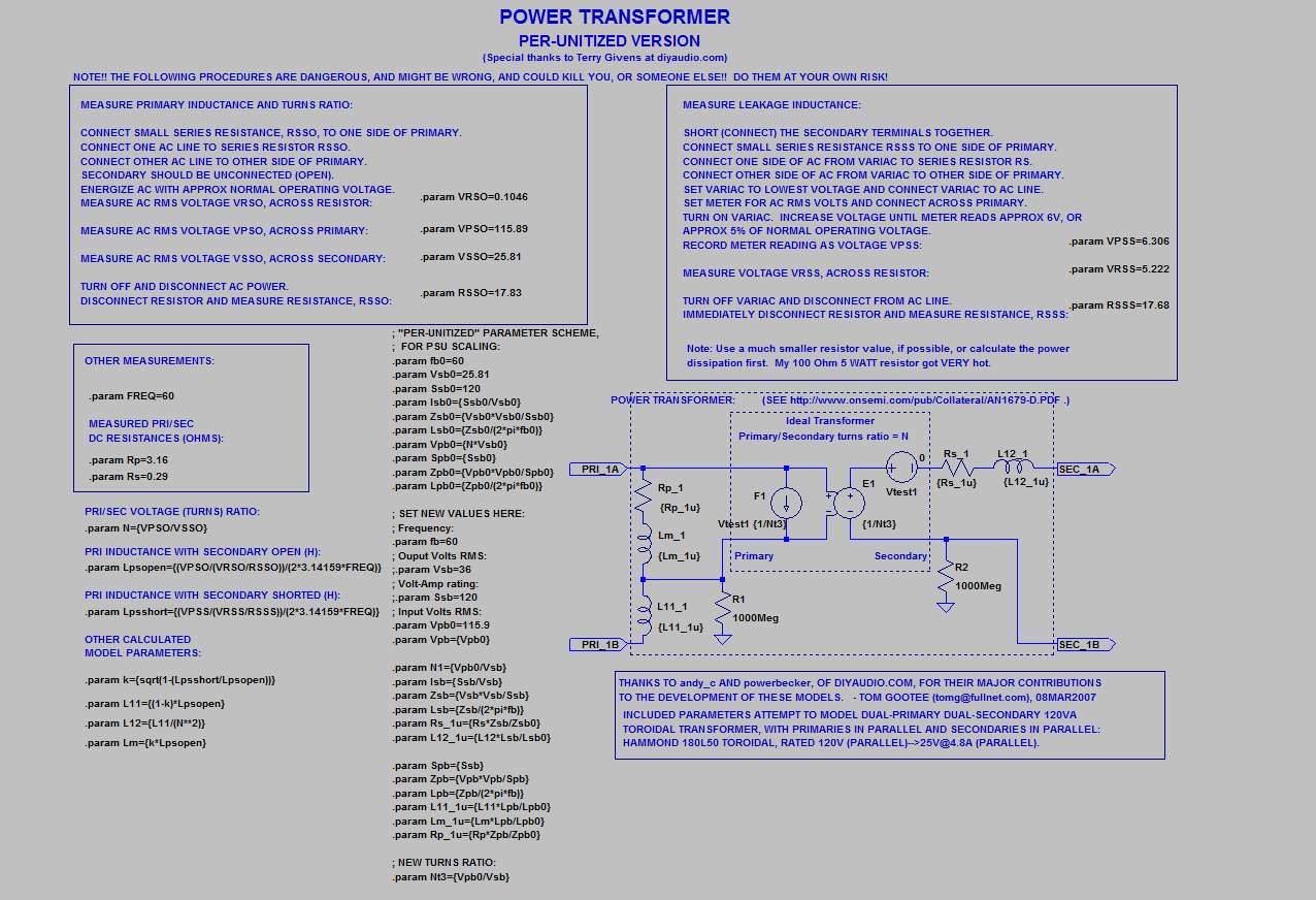

The scalable spice transformer model is great, because I can now automatically sweep parameters such as VA rating, and Volts RMS rating.
NOTE: 7.5 Ohms and 3.5 Ohms are the average impedances seen across the transformer's output terminals, during charging pulses, with 8 and 4 Ohm loads. Those impedances include the whole load, including the amplifier, not just the output resistor. Since the measurement setup for these tables doesn't include an amplifier, I used 7.5 and 3.5 Ohms to get the voltages but used 8 Ohms and 4 Ohms to calculate the power delivered to the load.
Oh, the reason I started making these tables was initially just to test the new scalable transformer model. Then I also thought they would be nice to have, to see if a particular power/load/VA combination was "reasonable" to try to simulate, to use as a data point for the required capacitance per amp of output current.
I was going to post all of the spice files for everything so far, but it's getting late so it will have to be tomorrow.

Nice Job Tom. The truth is that we need the transformer to provide much more than is normally perceived. Your data may very well have brought out the balance that is needed between VA and Farads. Could you direct me to the decoupling data ;)

However, in case it's something that is easily explainable and measurable, such as the capacitors' ESRs or inductances, you could download the spice model I posted and do things like: automatically plot a series of frequency-responses, one for each ESR in a sequence you can define. You could plot the frequency response for any range of steps of variation of _ANY_ parameter, anywhere in the circuit! If there are correlations with certain frequency ranges, you will immediately SEE them, as the multiple plots (of ratio of output vs input amplitudes, over frequency) all take form on the same axes, right before your eyes.
Interested in distortion? It's almost as easy. You can tell anything at all in the whole schematic, including any parasitics you choose to insert, to vary over whatever range of steps you desire, and use a sine wave as the input, and you can receive a THD number for each step of the variation that you commanded. The only difference from above is that the THD numbers get placed into a text file that you then have to open, after the automatic sequence of stepped variations has finished running.
