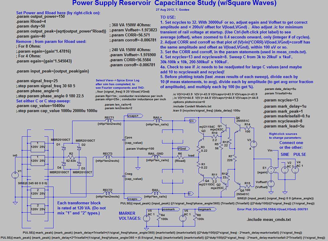

So, DF, Terry, Fas, and other experts: Square-wave testing, with peak values equal to the peak sine values previously used, as in post 846, should be comparable to using a sine load current's or voltage's peak value instead of its RMS value, as the DC load current or voltage when calculating ripple and the needed reservoir capacitance using the standard approximate formulas, correct?
So it's like using double the power as a worst-case design margin, and throwing in huge fast transients, too.
Tom, sorry I haven't been more active lately, you know, life and all that! Anyway, I had a play with your pulse source, but what I did just to make things fair to the circuit was to drop the slew rate to that equivalent to a 20kHz waveform: made rise and fall times 20usecs. This is as nasty as one can encode a CD, so theoretically, if Iggy Pop had another go at mastering, this could end up in the stores! The end result? Double the power dissipated in the load, 200W, so the answer is, yes. And not that much worse voltage sag.
But what would be worth playing with now is ESR: at full power the voltage sag varies dramatically once you go over 30mR. This is where the parasitics really start to intrude very significantly, may be much more important than the nominal capacitance.

The maximum slew rate of a sinusoid will depend on the peak-to-peak amplitude. For a +/-40V sine, the peak slew rate occurs at the zero crossings and is about 5 volts per microsecond. So that rate should also be able to be sustained from peak to peak, which should be able to be encoded even on a bandwidth-challenged CD, in a triangle waveform. Remember that after amplification, the slew rate can be much higher than what's in the same signal when at line-level. Anyway, at 5 V/us it would only take 16 us to go from -40 to +40 Volts.
That will certainly make it easier to do the decoupling.
Ah yes, that generic capacitor model. It's been in the back of my mind the whole time, making me wish I would take a closer look at it. It was just a quick-and-dirty convenience when I first started using it.
What I should probably try to do is get a complete series of values of the frequency-dependent cap models from the Cornell Dubilier site and somehow set them up in a subcircuit so that the desired value cap would be connected automatically, so I could still do the automated sweeps of capacitance values.
Here are the files for simulating with square waves.
I hope I didn't leave out anything important.
(These should still work with sine waves, too, but you'd probably want to at least un-comment the .four command and comment-out (with leading semicolon) the meas_cmds.txt "include" statement.)
At some point, I need to go in and set it up with someplace where binary values are set, to select the configuration, and everything else is set automatically, maybe using the u() unit-step function of each binary parameter multiplied by each alternative value and then all of them could be summed, so that the one selected would be multiplied by 1 and the others all by 0, so the sum would be the correct value for the selected case.

To add a bit more meat to what I said before about the ESR of the smoothing capacitor, here is what happens to the voltage rail when Tom's model is driven by a full power 1kHz sine wave into 8ohms, for 2 different values of the ESR, 30mR and 300mR, nothing else varied:
Hopefully what you're for using on your amp are around 30mR or better, but if they're a bit dodgy or long in the teeth then the other value may be closer to what you have ...

Wow, man, you really need to download LT-Spice (free from linear.com). You don't need additional "provisions", to look at something. You can show almost ANYTHING.
The mouse pointer instantly turns into a PROBE(!) as soon as it moves over the schematic, which I posted just a few posts back, and which is also at http://www.diyaudio.com/forums/atta...wer-supply-resevoir-size-schematic_square.jpg .
And with a quick right click on a wire and then a left click on a pop-up menu, you can set the probe reference point anywhere you want, if you don't want it referenced automatically to ground.
Also, moving the probe over the top of a two-terminal device, or to a pin of a multi-pin device, changes the probe into a CURRENT probe.
Click whatever or wherever you want on the schematic and it's instantly plotted. Watch the plots unfold as the simulation time progresses, if you're simulating in the time domain. But it's just as easy to switch to the frequency domain.
Note that there IS a snubber in the circuit, already (but not aimed specifically at the turn-off spike): R2 is the snubber. The optional C in series with it was unnecessary in this case because the optimal dampng resistance was so high that its dissipation was low-enough that no frequencies needed to be restricted from it, making the optional series C unneeded.
The snubber was needed in an earlier version of the circuit in order to damp out a very strong and persistent ringing that was at a fairly-low frequency (below 1 MHz). I can't remember the details, right now. But the circuit changes whenever the transformer model is reconfigured or the reservoir capacitance is swept.
When simulating, I usually only bother with designing a snubber if it is needed in order to prevent the sim from slowing to a crawl. I haven't checked this one without the R2 installed, lately, but it's a high-enough R value that I just left it in.
By the way, that snubber was designed by using the steps I posted at:
http://www.diyaudio.com/forums/powe...lm-caps-electrolytic-caps-30.html#post2828689
(I realize that the snubber looks a little weird, with such a large R value. But it did work extremely well.)
I have seen an almost-identical snubber-design method in several different papers, and also in some other places, on the web. I read Jim Hagerman's snubber stuff "a few" years back, along with a lot of other snubber materials, but I can't remember if his method was similar. Anyway, did he invent a special case or type of snubber, since then? (Otherwise I would have to wonder why snubbers should be named after him.)

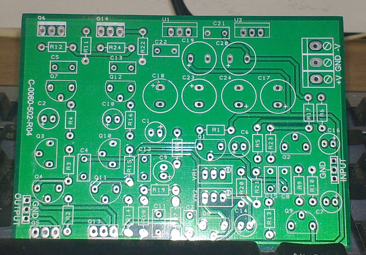

I have laid a little headphone amp board to the test the "sonic" effect of multiple smaller caps as I am currently using the same amp with a single cap per rail.
I feel headphones are the best test system because you have some of the worlds best speakers only a centimetre from your ear and no room acoustics or furnishings or any other obsticle to affect what you hear.
