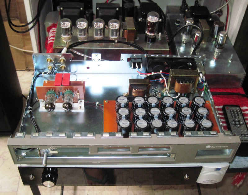

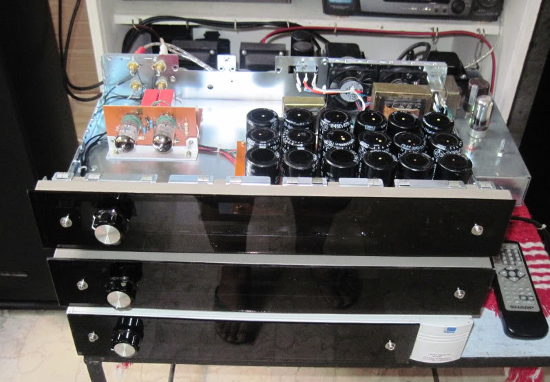

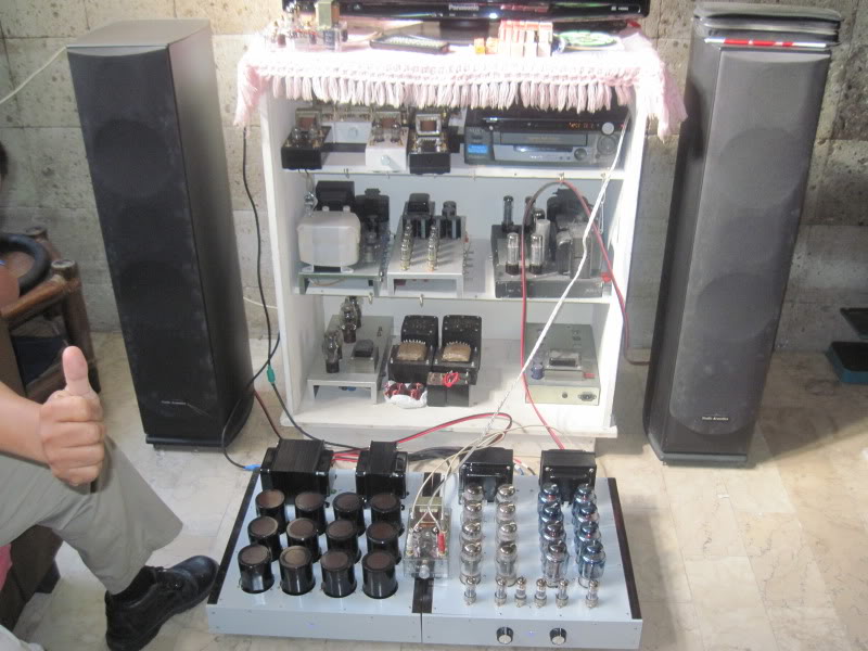

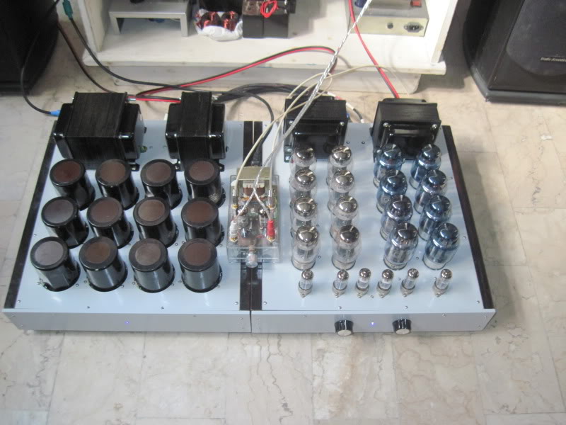

well the owners of these gears are very happy, i am happy for them....:D
