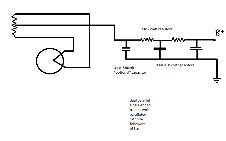

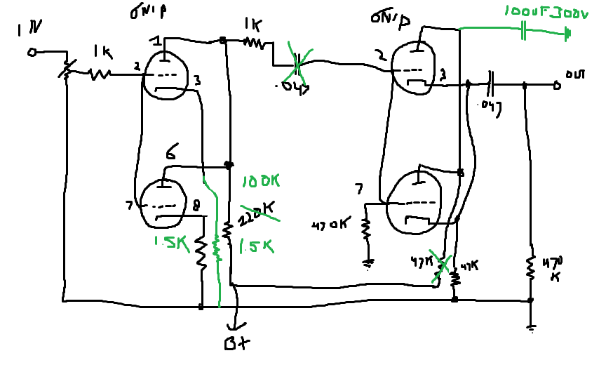

i reassigned the "zen dual parallel single ended triodes with paralleled cathode followers" preamp to the duty of phono preamp.
the two circuit diagrams and the power supply diagram are shown below
i thought i could just stick with the old power supply and there would be no difference. wrong. now im getting only 80 volts B+ and low gain rather than 250 volts and too much gain.
i was getting 250v before but now it has all changed.
what do i need to do. change the resistors between the smoothing caps? any ideas?

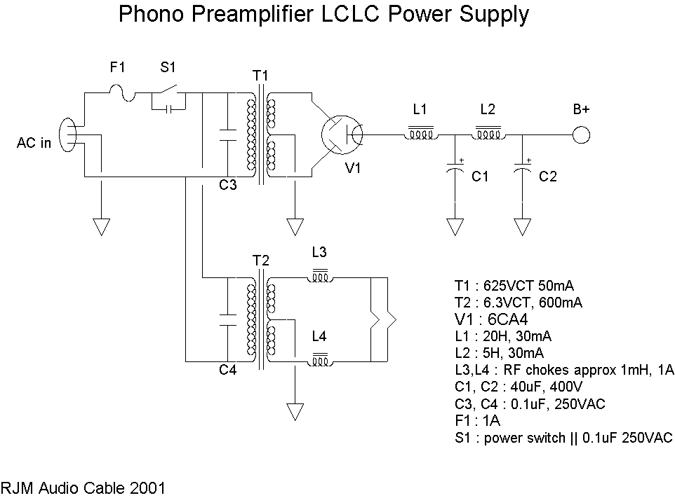

this is the PS that the designer suggests for this project. i thought one would be much like the other

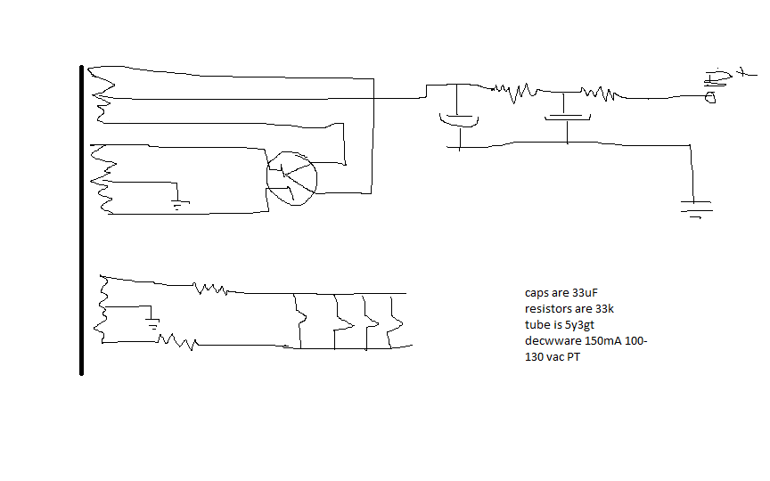

Power supply diagram. Did you draw that from your own wire tracing?
Your hand drawn PS diagram shows a directly heated K rectifier like a 5U4 or 5AR4 and your official diagram lists a 6CA4 type. And your hand drawn diagram shows you tapping the B+ from a CT on the 5V heater circuit for the 5U4. Aint no such thing.
this is the complete schematic of the zen power supply that is in the original preamp.
the other PS schematic is the one recomended by the designer of the phono preamp

The Zen PS drawing shows the rectifier output tied to a centertap of its own 5v circuit. Get that checked out. There should not be a centertap of the 5v. You may have some tranny legs crossed.

what 5v. that is the B+ voltage. right on the rectifier, its about 600 volts pulsating DC . then after that goes back to the tranny that CT measures 400v before the smoothing caps and the 33k resistors. then between those resistors it's 250 and then only 90 for final B+. i need 250 for final B+ so can you help to determine what the value of those resitors should ought to be.

LOL, you got it all wrong. Take a deep breath and start looking for your tube rectifier anodes.
what did i get all wrong
In your drawing it goes to the filaments, take your B+ from one side of the tube filaments. Pin 8.what 5v. that is the B+ voltage. right on the rectifier, its about 600 volts pulsating DC .
AC high voltage to the anodes, 5v to the filaments.

Chop, the lines that go to pins 8 & 2 would have 5v on them for the filament/cathode but when it's running the full rectified voltage is on top of it so you'll never read 5v. there unless those leads are disconnected. It's the same for all 5Y3, 5U4, 5AR4... get it...they all start with 5. So if you get that sorted out and find out why your drawing has a centertap on there when there shouldn't be one, you may have a serious load on there drawing it all down. It should blow a fuse though if that's the case.
Anyway, realize that tranny is able to supply 150ma and the other tranny is only rated 50ma.
