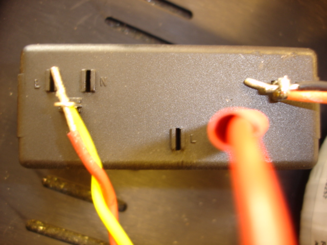

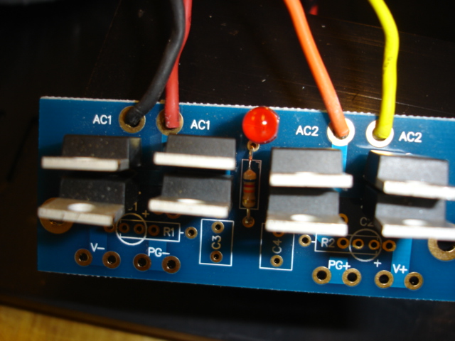

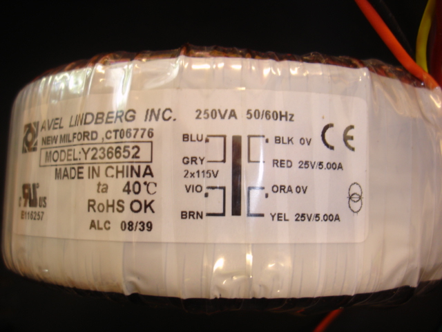

I would like to be sure that I am connecting the wires from the transformer to the correct locations on the rectifier board and power module.
Information off the transformer
Connections to the rectifer board
Connection to the power module
For the power module, I have connected the two negative (0) wires together and they are going into the (N) terminal. The two power (25V) wires together go into the (L) terminal.
I want to make sure things are wired properly, so not to blow it up or worse, get shocked.
Thanks.

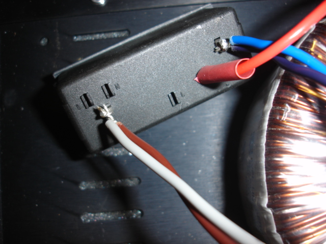

Definitely not correct. Assuming the block with the L and N is the power connection, the Blue and Violet wires should be connected together and go to the L connection, and the Grey (white?) and Brown wires connected together and put on the N connector (actually, they can go either way as long as gray and brown are together and Blue and violet are together) You also may want to put a switch somewhere in there - unless one is built into the power line module. For the secondary connections follow the wiring for this thread - they even use the same black,red, orange and yellow colors. http://www.diyaudio.com/forums/chip-amps/131820-help-first-power-supply-lm1875.html Lastly (and most important) set up a light bulb in line with the ac - more information can be found in the Power supply sticky at the top of the chip amp forum. Good luck with it. BTW, I've made some assumptions about the board and the power line connections but feel pretty correct about it.
Reaper, please be very careful. As you have it hooked up it is leathal. Please have it checked by a knowledgable person if you are not sure. sregor has put you on the right track but if you are not 100% sure take it to someone who knows this side of DIY and ask them to teach you. Otherwise you may meet your grim namesake.
I don't think so.
I will leave it to someone in the US to answer as I don't know that form of power entry module. Ours in Aus are different.
I think the rectifier bridge needs the wires in sequence Black, red, orange and yellow. Currently you have Black Orange, yellow red.
A bit of background while you wait :)
A power transformer has two 'sides'. We call these primary and secondary.
In the US the primary is the one labelled 110 or 115v This side goes in to the household power.
The secondary side is the side that goes into the toys we make. In this case 25V.
When you first connected it you had these the wrong way around. If you put 110V in the secondary you have over 500V coming out the other side.
Please wait for a response from the US. I am sure sregor will answer when he can. Patience is a virtue after all :)

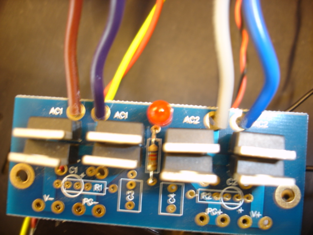

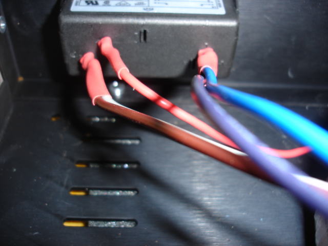

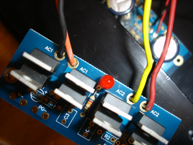

Is this now the correct wiring of the power entry module and rectifier bridge?
power entry module
rectifier bridge
The power entry module looks correct; but, the rectifier bridge still looks wrong to me. According to the trafo picture in post #3 the 2 ac pairs should be AC1 = Blk-Red and AC2 = Ora/Yel. Other experts please feel free to comment/correct.

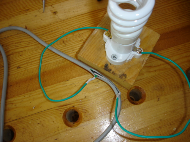

Okay, I have the bulb tester prepared and have soldered the primary wires to the power entry module. There is no load on the secondary wires, they are loose, do I need to secure the secondary wires or leave them like they are to test the primaries?
Is the CFL, 60 watt, ok to use for the test or do I need to use an incandescent bulb?
Thanks.
the tester must use a tungsten filament incandescent bulb.
Have a selection to hand for different power requirements.
I have 40W all the way to 150W. I test transformers and transformers + rectifiers with only the 40W bulb.
If I have a big capacitor bank to add on I may up this to 60W, but for first testing I never go as high as 75W.
These are all for the UK's 240Vac main supply.
