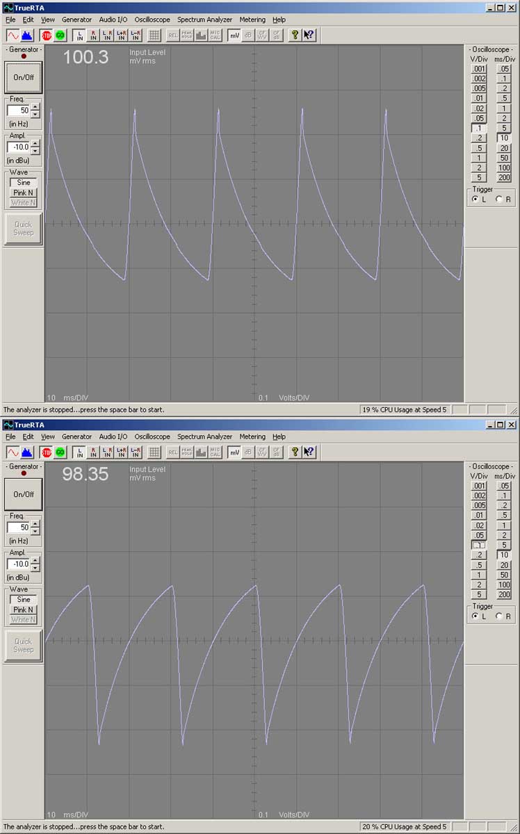

OK I finally got around to testing the ripple on my Amps psu. I built a sound card pre-amp, and downloaded the freeware version of TrueRTA. What I see worries me somewhat!!! It looks real nasty!!!
So the question is: Is this real bad, and if so Is it likely my filter caps are cactus? There is 16,000uF capacitance on each rail, 2 X 8000uF.
Ive attached some screen dumps of what I saw in TrueRTA.
It's obvious to me the problem is at 50Hz which is what I would have expected, but the amplitude (around 100mv) seems a tad excessive, also the shape of the wave form is pretty weird, and seems to be mirrored +ve to -ve rail. BTW I have never used a scope before so wasn't sure what to expect!
The positive rail is the upper image and the negative rail the lower.

The measurements were taken with zero load (well 100ma quiesient current on the output transistors.

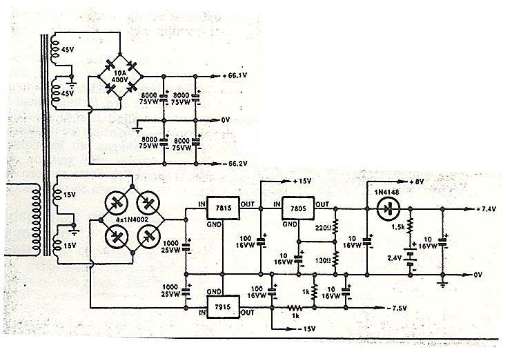

Here is the schematic. It's as basic as you can get, a metal can Bridge rectifier and some filter caps. The secondary 15V winding, and subsequent voltage regulators are fine, less than .5mv ripple, difficult to tell as the sound card has a bit of noise at that low a level. Note that the output voltage shown on the schematic is too high and is really around +- 63V.
The PSU drives two channels of my 100W Mosfet amp.

Psu
When building a PSU like this the two windings on the transformer are commenly out of fase, this in turn means that the caps are charged at the double freq of the mains.
The rippel you measured is only 50 hz, which leads me to think that the transformer has been (re)wired wrong??
Is there a problem with the amp?? the rippel is small
edit: try measuring the AC voltage between the two secondary windings, if you don't get something, the wirering is wrong
\Jens

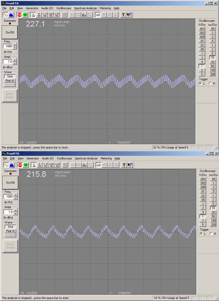

ripple with load
OK I haven't checked the wiring of the PS yet, but I decided to do a test with a load.
Input signal 1Khz sine wave at about .2V (all the soundcard will deliver) amp cranked to max volume, resulting in a 1Khz sinewave at speaker terminal at about 20V. Driving one channel only into 14 Ohm resistor (what I had lying around).
Now this looks much more nasty to me, but again, I don't know what to expect.

soren said:
Since you are using a full-bridge rectifier, the fundamental of the LF supply ripple hsould be 100Hz when using 50Hz mains. Are you shure you have wired up the rectifier bridge correctly?
Well I think so, but I'm no longer sure!!!!! I would have thought that if I didn't wire it up correctly that I wouldn't get the correct rail voltages???? I'm actually thinking about going out and buying two new rectifiers and wiring up a dual rectifier setup one each for +ve and -ve rails. This may help with my problem about not being sure which end of each secondary winding is which (if it even matters).
I guess it is possible that the rectifier bridge is faulty..........
Tony.
edit: I am interpeting the cro output correctly aren't I. 5 peaks in 500ms (50 divisions of 10ms each) must be 50Hz correct?

Well I'll be damned. I just checked the ripple on the other rectifier in the amp and guess what. 100Hz ripple! I'm now wondering whether the main rectifier has been wired up incorrectly for the last 16Years, and if that's been the cause of all my Hum problems!!!!!
I must admit that I was building this amp late at night when I was supposed to be doing uni assignments, so it is quite possible I wired up the rectifier incorrectly, but never realised, because the voltages seemed to be ok. Time to pull the amp to bits me thinks!!!!!

Re: Transformer in fase
JensRasmussen said:
If the two secondary windings are in fase, they are just in parallel, this means that the bridge will work as a ½ wave recitifier.
Half wave rectifiers (even in a bridge box) will give you 50 Hz ribbel.
Hope you cure your amp
\Jens
Thanks Jens,
I've now got 100Hz ripple at about half the level it was before. (about 48mV no load). and about 138mv with the same load as I tested above, ie 1Khz sine wave 14 Ohm resistive load which is much better than the 430mV before. I havent hooked the amp up to my speakers yet, but I suspect I that the hum problem hasn't gone away :-( Still can see spurious junk on the speaker output even with the volume knob at zero.
Thanks for the help, at least one problem now appears to be fixed :) .

some more pics
OK I have fired up the test gear once again. Bit more of a real world test now.
1Khz sinewave as before (input to preamp at .2V, managed to get the sound card to crank out .6V but caused the amp to clip severly, so I went back to .2V which is what I had in the previous test, at which setting the volume to max, causes slight clipping at the output.
Both channels are being driven, with two 10W 15 Ohm resistors in parralel as the load for each channel.
Having done this I now have another observation, clipping is occuring with only about 27V appearing on the speaker output, which is less than half the supply rail voltage, is that normal? Also at around the point when the amp starts to clip, it is making a funny noise, I'm not sure what component(s) are making the noise but its like something metal is vibrating a bit like a tuning fork..........
Finally the supply rail voltage goes down as I crank up the volume, starts at around 63V but drops to about 49V by the time the amp is fully cranked up (this is with .6V input 1Khz sine wave, with the amp clipping.
Anyway I have attached the latest test pics. As you can see the ripple is much more under control than it was with the transformer wired up incorrectly. And what's more, this is driving two channels, into roughly half the resistive load, so overall it is working a lot harder. I still don't know whether I should be seeing the 1Khz sine wave superimosed on the ripple though!!!
I spent a lot of time today looking up Farnel Australias web site, to get a list of caps to replace in the aging power amp section. I'm going to replace all of the electros with Panasonic FC series caps, and also the greencaps with some somewhat experimental Metallised Polyphenylene Sulphide (PPS) capacitors by Evox Rifa (If anyone has used these and they are bad news let me know and I go back to some metalised polyproylene ones!) and some .1uf ceramics to use as snubbing caps on the recfifier bridge.
The upper screen shot is the -ve rail and the lower the +ve rail.

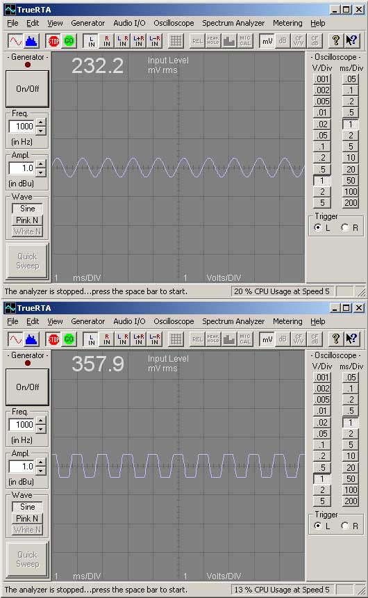

clipping demo
OK Here is the screen dump showing no clipping and clipping.
I measured the input to the power amp (from the preamp) at about 3.3V with no clipping evident at that point. again this is a 1Khz sine wave.
as you can see at around 23V (I have my sound card preamp set to divide by 100) there is no clipping, at full volume and about 35V clipping is very evident (note that I haven't recalibrated the software for the divide by 100, and a measurment with the multimeter showed about 38V at full volume).
I just realised that the supply rails are at 63V DC but the output at 38V on the speakers is AC dohhhh...... so me thinking I should be able to get up to 63V without clipping is probably completly not based on reality.
One last intersting observation, I have a piece of blue tack on the amp beside the volume control. This is the do not turn up above this line mark which was supposed to stop people at parties from blowing my speakers, I can't remember how I decided on this point (it wasn't through any scientific means) but It is at this exact point that the amp starts minor clipping! So all those people in the speaker formum that told me I was most likely clipping my amp when I blew speakers, you were absolutely correct :)
Tony.

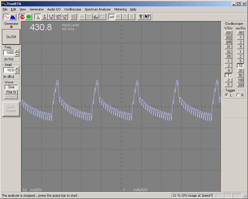

One more thing
I just measured the current on the speaker output whilst clipping 5A! so by my calculations 5A 38V is around 190W..... No wonder my poor speakers blew up!!!!
without clipping its about 3.8A at 29V so that's about 110W so I guess I can't complain about that :)
I guess that also explains why the two 10W wire wound resistors in parallel got a bit warm :hot:
Also Ive attached a screen shot of the noise on the output of the amp with no input signal, top pic is with volume at zero and bottom is with volume at max. This is the worrying thing, If it was purely hum, I would have expected a sine wave, but its really spikey rubbish............
