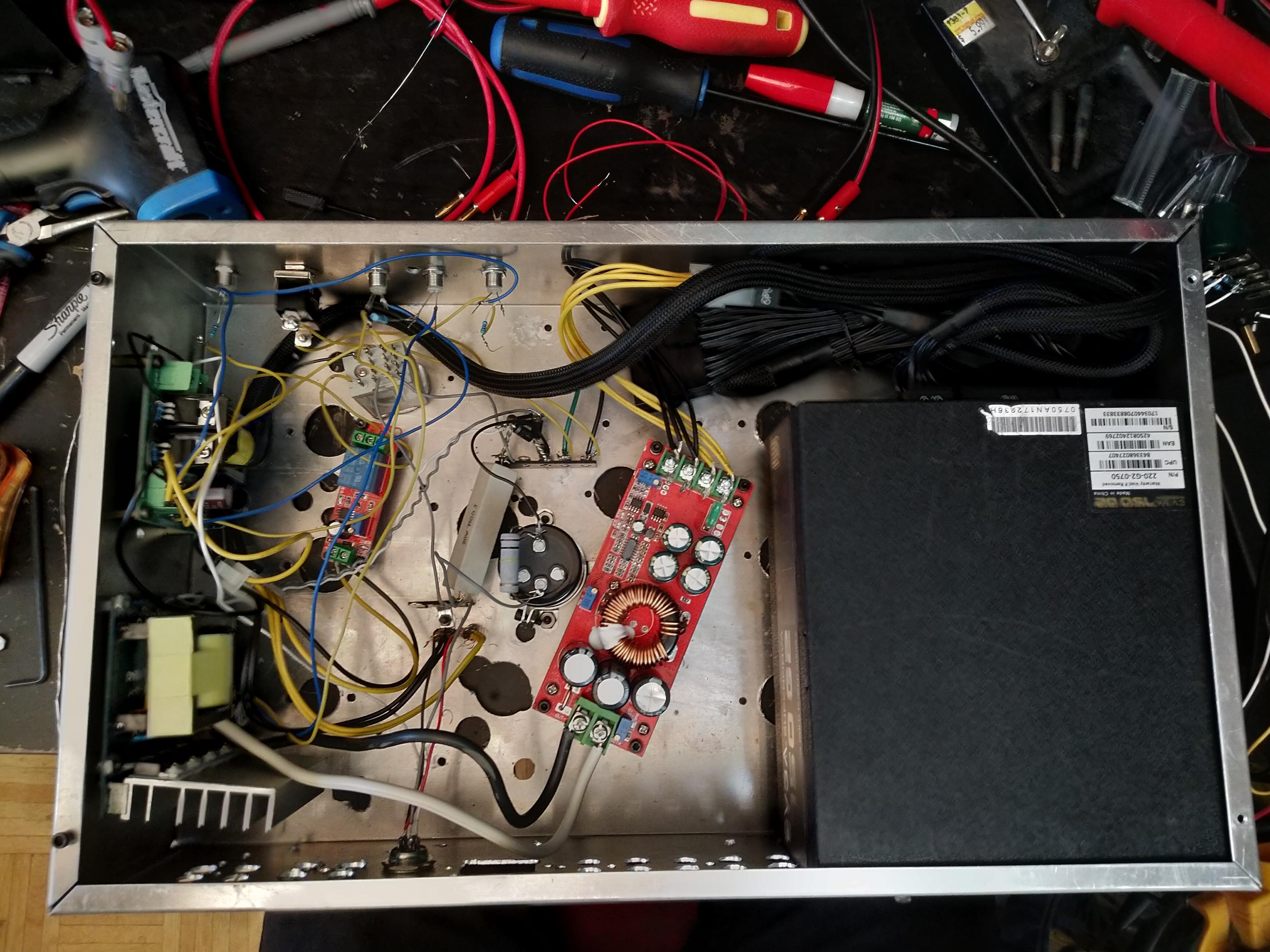

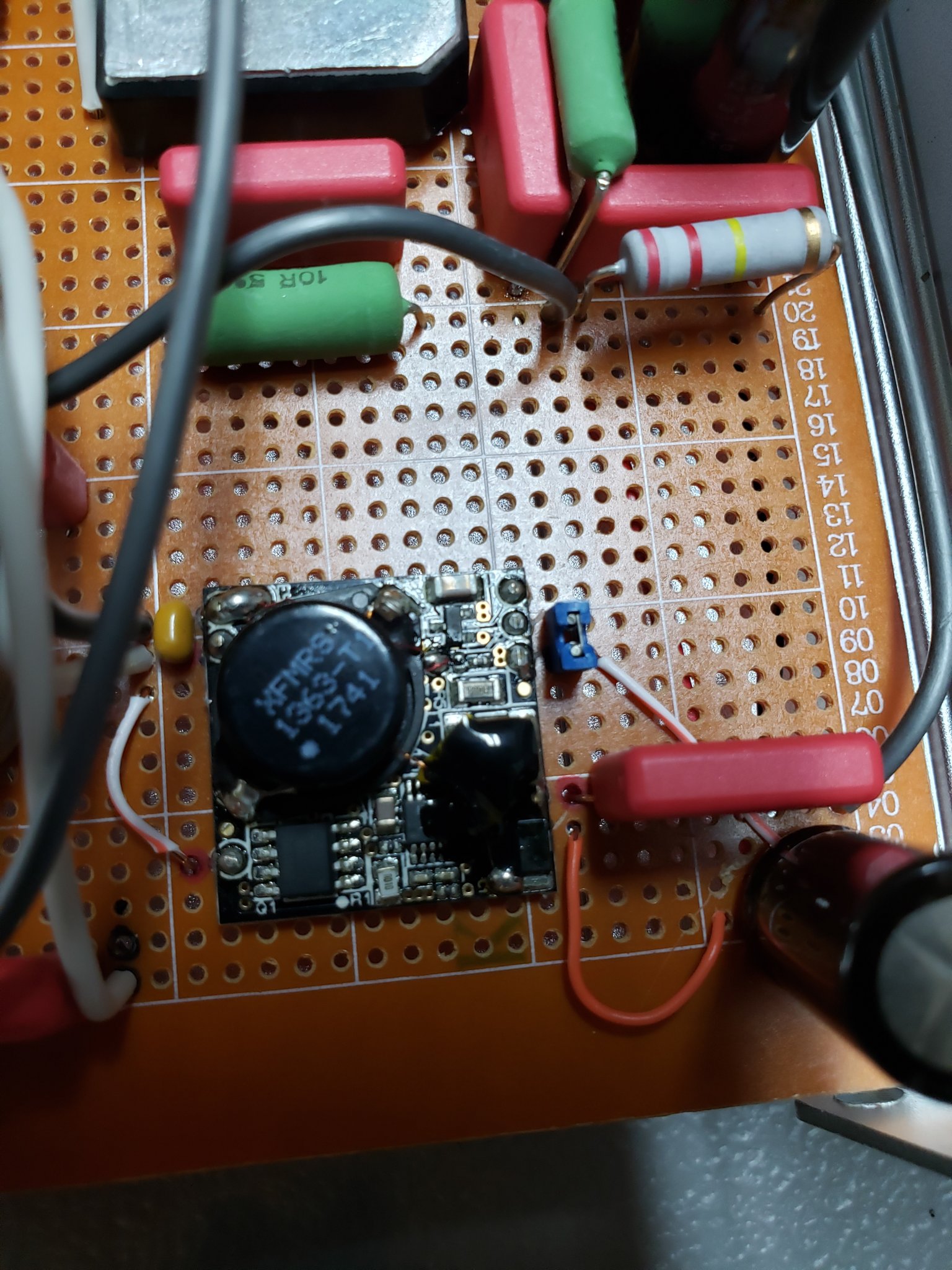

Here's a pic of a power supply using an ATX for 12V, a 12V-280V boost for preamps, a 12V-14.5V boost into a 12V-380V booster to give 440V.
See this thread for more details.
Ganged switching power supply for a tube amp.

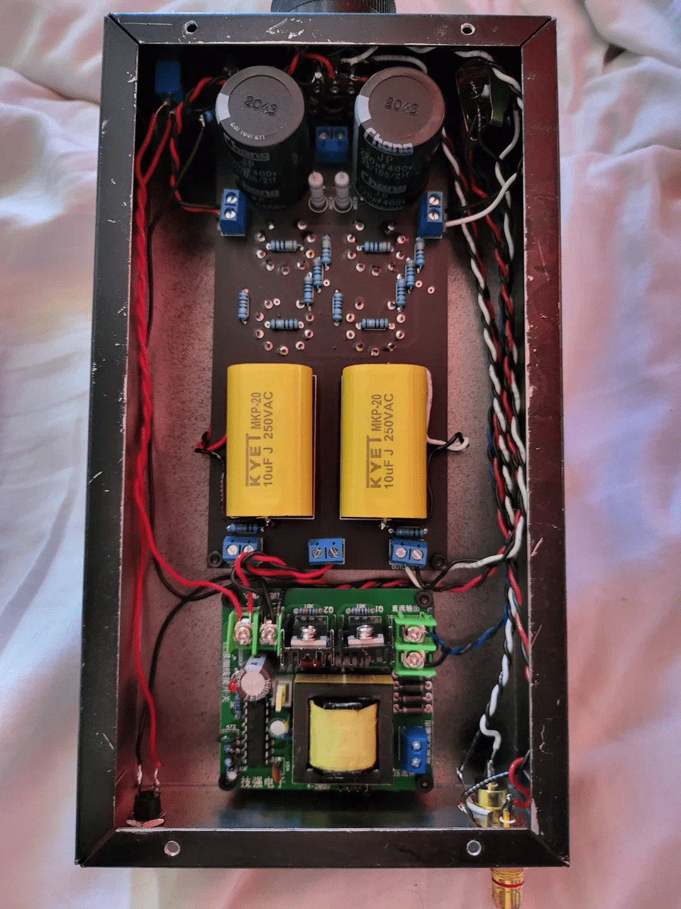

Here's a pic of a tube line/headphine amp built using one of the modules I linked, and a 12V 10A LED supply like this: https://www.aliexpress.com/item/1005002629988121.html

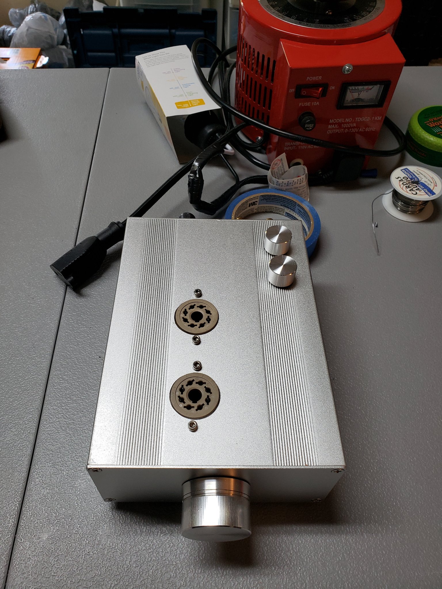

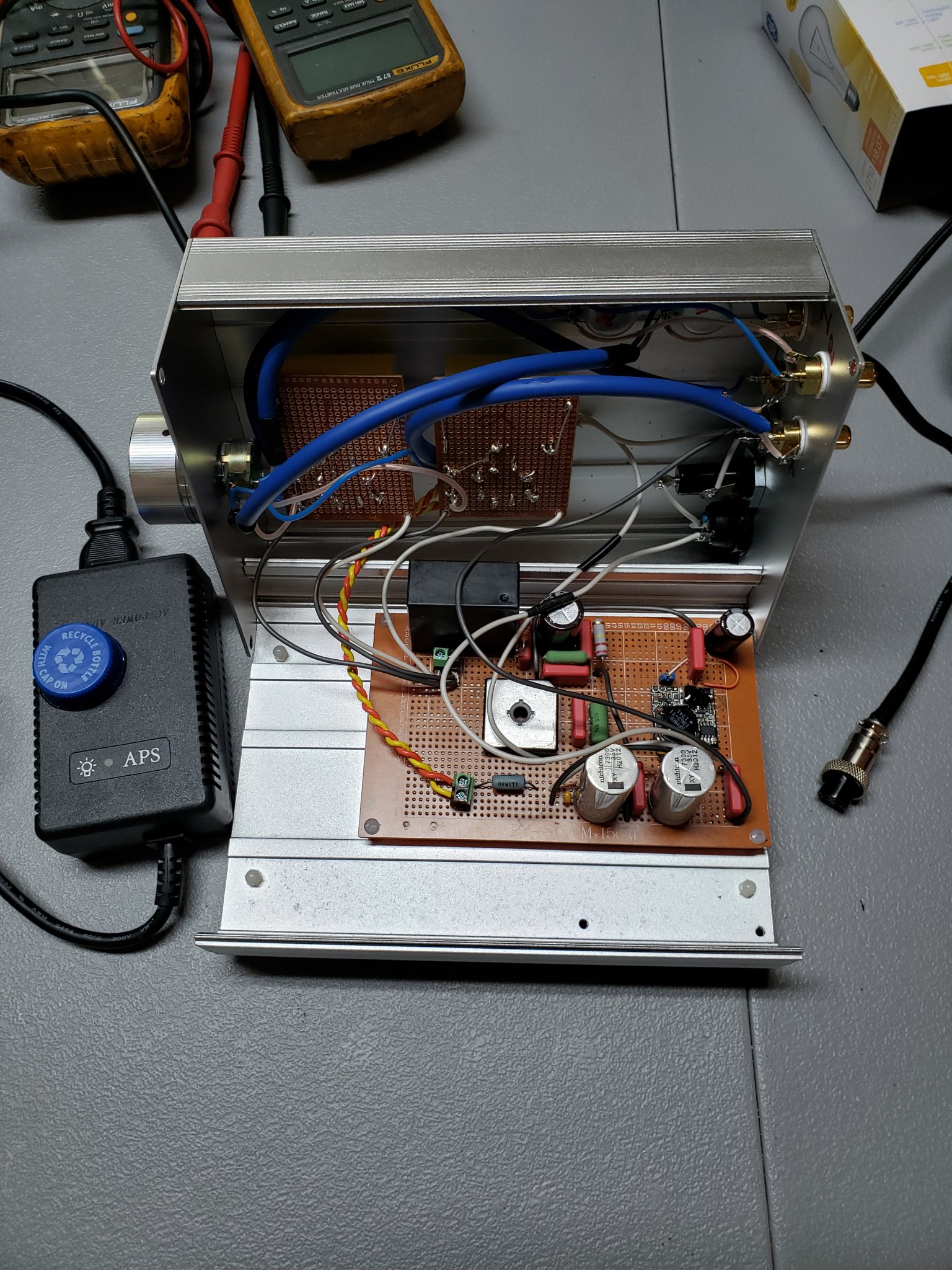

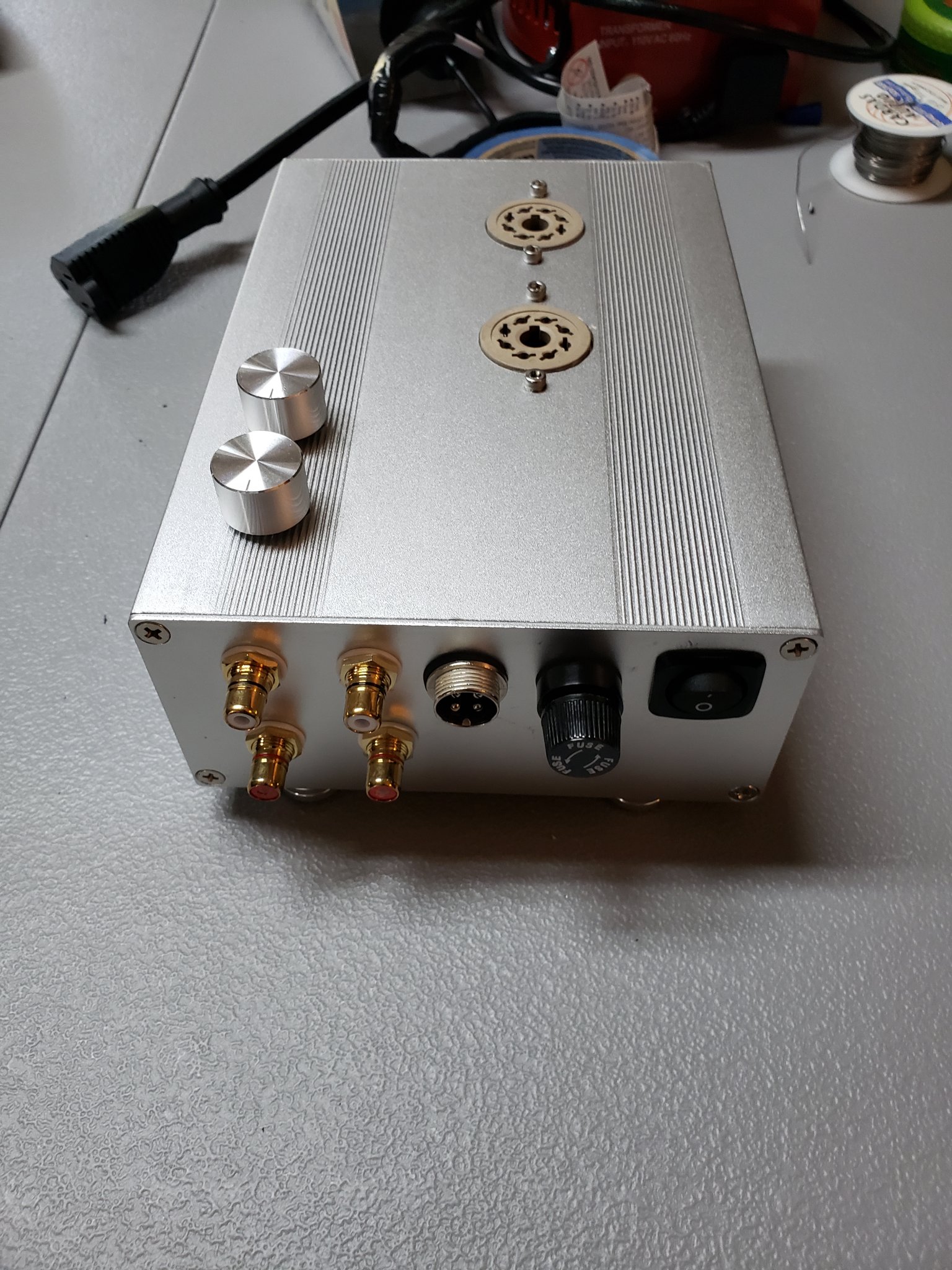

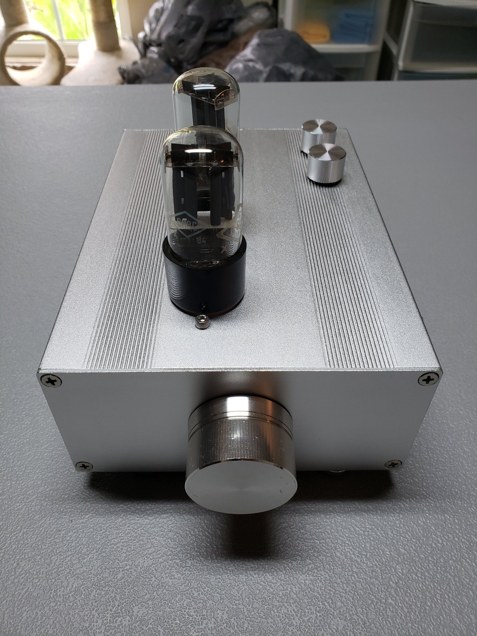

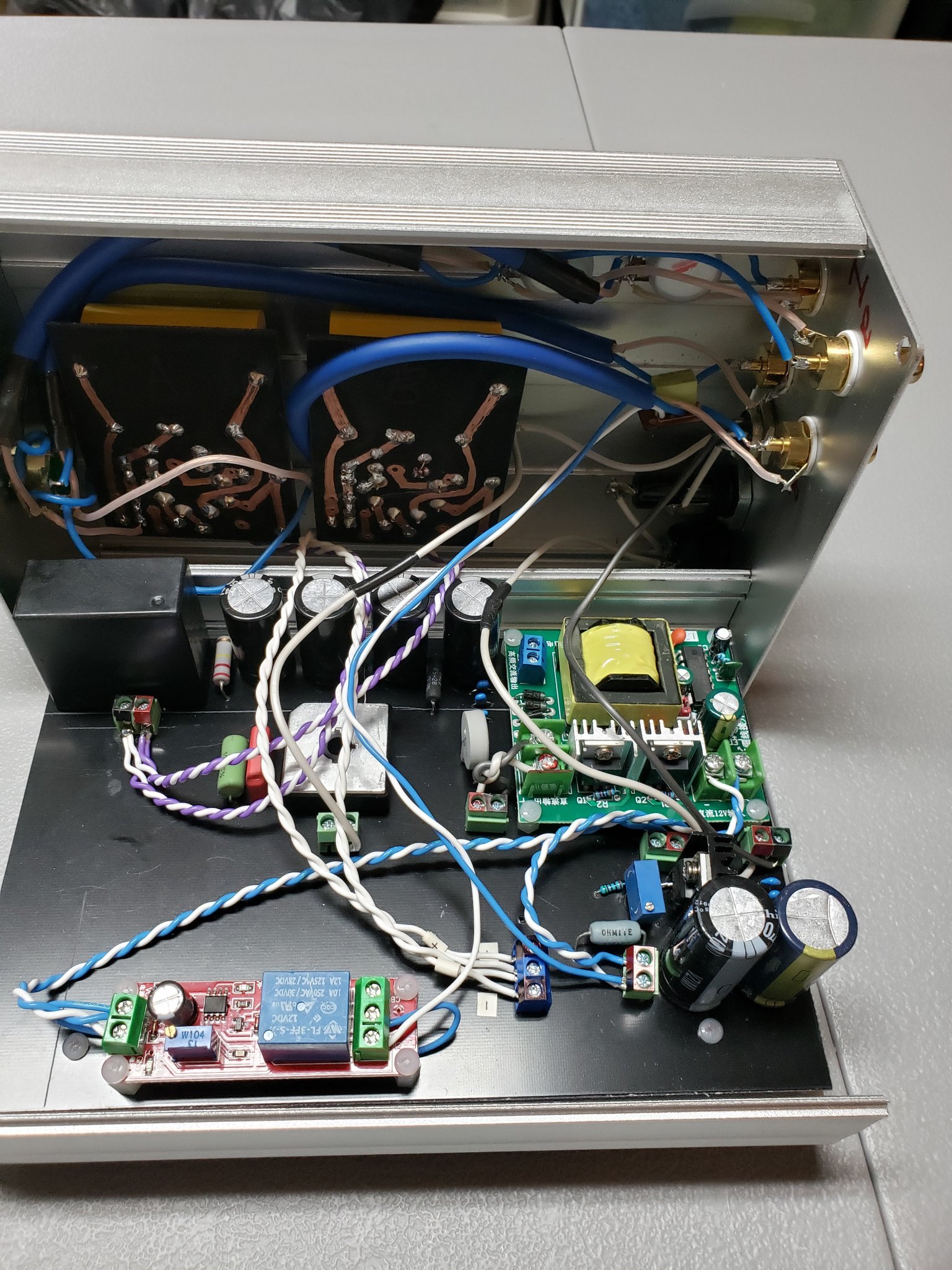

Kodabmx,
Just wanted to touch base with you.
I appreciate all your help!
Finally got done tweaking this past weekend on the power supply.
Thanks again!!
.......Robert
