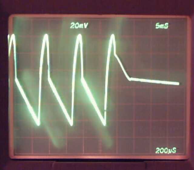

Till,
I am not so sure you should expect to see the difference with
a scope. John Curl wrote about this on audioasylum once and
said that although they suspected a difference they couldn't
measure one, until somebody with access to RF spectrum
analyzers tried it. The oscillations you get can be of very high
frequency and are usually of very small amplitude compared
to the supply voltage, so it is very difficult to detect on a scope.
I have tried to simulate this in Spice some time ago and the
oscillation effect shows up, but that is only because one can
zoom into the signal in a way not possible with a scope.

Can you do FFT with your scope? Fundamental will be 120Hz, see how far down the harmonics and noise are.
If not, my scope can do FFT so I can post results from HEXFRED rectifiers. After the holidays, I suspect.
My spectrum analyzer only goes down to 9KHz which might not be low enough(?).
christer, please say me the freyency resultution i need and the amplitude to expect. My fastest timebase i have here down to 10ns/cm without magnifier(manualsays good for 400MHz).
Amplitude may be the bigger problem because i have no better Y amp for less than 5mV /cm.
The scope can´t FFT, If anybody could say me the expected frequency, My PC does FFT but only up to 48kHz or so.

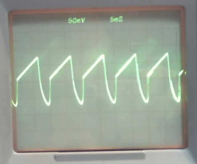

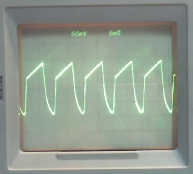

icceman said:The measurements were taken from the - & + of the bridge rectifier (without load) and the scope was set to AC coupled. I didn't record down the time base (I'm using the AUTO function of the scope) as I'm not really interested in measuring anything (just wanted to see the difference between standard and schottky rectifier).
Load a rectifier bridge with only a probe has no meaning even if the curves are different. Of course you will get different curves. Think about the leakage of the diodes!

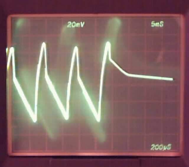

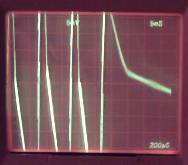

the first waves shown are with 5mS / cm. At the last its shown with 200uS / cm. You see at the beginning of this falling part of curve a little "undershoot" "antipeak", however it should be called in english.
With 50mV/cm its a little bit better to see, more isn´t possible because i have only a cheap X10 probe, and with a normal wire X1 i see nothing good anymore. (need better probes)

with 300VA + transformer, 12/16V, bridge, 10000yF and a real load (bulb)
The transformer is a very heavy EI, i estimate for more than 300VA, maybe 500VA with nominal 12V. The cap was an old 10000uF, Load a car lightbulb.
The scope is TEK7904 with 7A16A, 225Mhz bandwith amplifier, and 7B53A dual timebase.
It was best seen with using the dual mode of timebase and cheap diode bridge.

Well, I don't have a very fancy scope, just a plain old 15MHz
dual trace from the late 70's.
Anyway, I tried with a passive HP filter with a pole around 16kHz
which rejects the ripple fundamental about 46dB (both calculated
and measured). Then I am at least able to detect a clear
undershoot on the load voltage (AC coupling the scope, of course).
There is also a slight trace of ringing on the order of a few 100uV,
but that seems to be some kind of background noise, not related
to the circuit. So, undershoot detected, but no ringing detected.
I also tried a two-pole filter, but still no ringing and it took away
a lot of the undershoot too.
The filter was only used for measuring the load voltage, the load
was still resistive.
