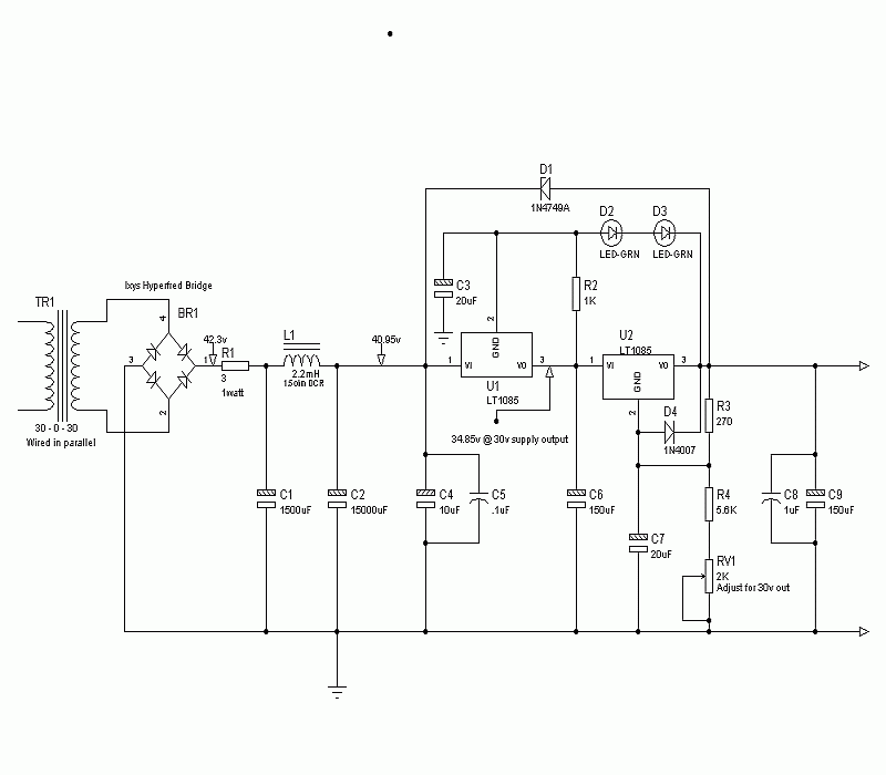

Hi Guys,
Not to butt in but I finally cobbled together this single rail supply with a lot of help. It utilizes a small power choke thats good for 800 mA. Which should be enough for any preamp circuit. The choke in the power supply is made by API Delevan and is available at Digikey (Part#DN2440-ND). Granted it's only 2.2mH. Another place to look for chokes is here:
http://cgi6.ebay.com/aw-cgi/eBayISA...ed=0&sort=2&since=-1&include=0&page=1&rows=25
Hope this helps.
Hope this helps.
