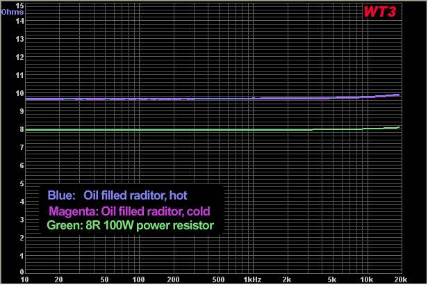

How's the inductance?
On a storage heater I have no idea, never measured it.
For those of you who like to worry about such things, below you will find impedance plots of a sand filled, aluminum heatsink 100W power resistor and a 1550W little oil filled radiator heater. Plotted both hot and cold.
