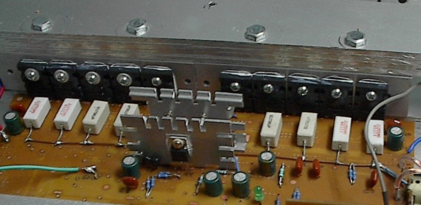

5pair of MJ21193/4 should be capable of 450W into 4ohms. 250W into 8ohms is peanuts for them. I had to push the 250W Tc to 130degC to get the 1second SOAR to just touch the 8ohm 60degree phase angle load line. Talk about boiling water!!
8pair of 200W plastic packaged anything cannot get close to those 5pair power outputs, reliably or otherwise.

I actually used 2sa1943/c5200 adjusted up from 150W to 200W since these are supposedly the Toshiba version of the obsolete 2sa301/281 and Onsemi's version is a high power version of the same transistor.8pair of 200W plastic packaged anything cannot get close to those 5pair power outputs
If you study the SOAR vs loadline of the 5pair MJ21193/4 (Tc<=200degC) compared to 8pair of 200W plastic packaged (Tc<=150cegC) you will find that the 200degC always outperforms the plastic package at elevated operating temperatures.
Note that I refer to power not speed since the thread started that way. It's not often I manage to stay on topic so long.
a bit of an understatement.I agree, the metal can products can probably handle more power at higher temperatures because the thermal performance it probably a bit better, althuogh I have not checked it.
The To3 packaged 21193/4 are far more resistant to mistreatment than the To247/264 devices.
It isn't uncommon for the junctions in the outputs to be running at 100*C, while the heatsink is running less than 50*C.
With a 100*C junction temperature it looks like the metal device will have twice the power handling capacity of the plastic type, due to the difference in maximum junction temperature (150* vs 200*).
