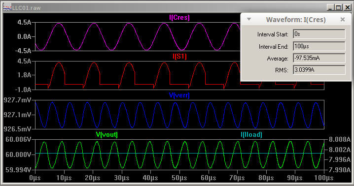

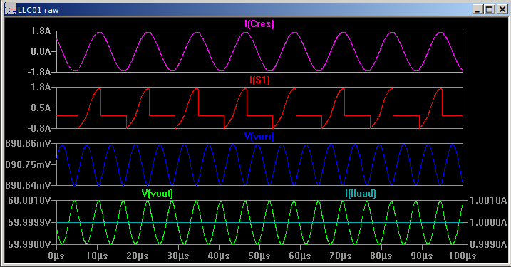

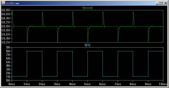

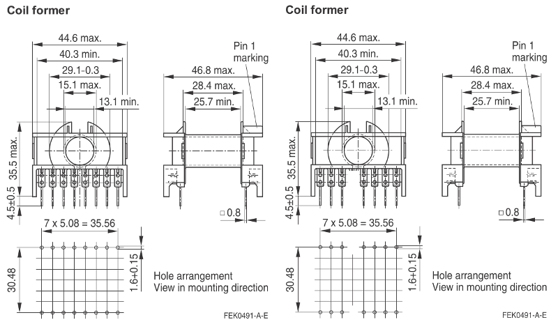

Hi. Thank you for the long answer. I really appreciate it.
My findings so far: With the ATX-core, a 3mm seperator in the middle of the bobbin and a 1-2mm gap in the center-leg the inductance-ratio between becomes approx 1:2.
The app-notes and design-calculators I looked at suggest that the primary-inductance shall be lower for higher output. This puzzled me in the beginning, but now I'm thinking that the inductance needs to be low in order for the primary-current to rise enough?
The calculators suggest that the primary-windings shall be calculated like for an un-gapped Xformer based on the voltage the windings will see. This gives approx 50-60 windings for a core with 1cm2 cross-section. But that drives the inductance way up.
So I tried with fewer windings and a gap of 1,5mm. 30 windings appears to e good compromise. -iddle heat is low. Heat at 60W output is luke-warm and it will do peaks of 500W without sagging in output voltage.
Inductance is approx:
I have not calculated or simulated the entire feedback-loop. From what I have seen it looks very complicated, so I just copied the feedback-loop from a similar design.
So far it handles all, load-changes I tested with.
Kind regards TroelsM

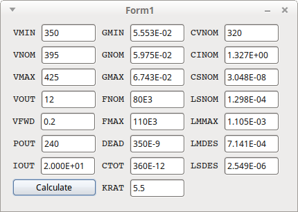

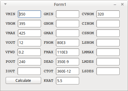

Data is a good thing to have. One of the best in respect of ferrites would be,
https://en.tdk.eu/download/519704/0...2ba503/ferrites-and-accessories-db-130501.pdf
Siemens -> Epcos -> TDK
Rather than using a Junk core think about buying one that fits your requirements.

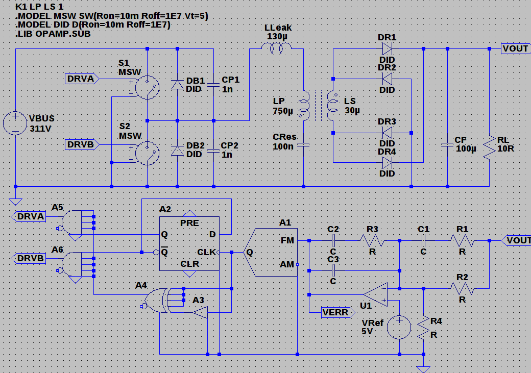

I have already mentioned I do not know enough but I have looked at LLC converters in the past using LTSpice. If I try to recreate it, this for the moment is incomplete...
Code:

Copy the text and save it as an .asc file. LTSpice should open it.
Might look like the attached picture and I think you will be able to guess as to what is going on.

Going back to your OnSemi App Note,
I have had a go at putting the equations into a FreePascal/Lazarus application. It's not pretty but... Attached.
The results do not exactly agree with the App Note but, assuming its equations are right, look at EQ27-29. Their calculations are wrong.
Also have a look at Page 15)
The difference between the LLC design with external
resonant inductance and the design that uses a transformer
with high leakage inductance can be determined with
simulations. The integrated resonant tank gain differs from
the inversed transformer turns ratio when operated in series
resonant frequency. This phenomenon is related to the fact
that the leakage inductance is physically not located in series with the primary winding like in the external resonant coil solution.
I think that might be fairly telling. Look back at my previous post and the Notes by Lloyd Dixon where he explains how to position/associate the Leakage Inductance with a particular winding and also estimate its value.
Also notice that some of the equations in the OnSemi App Note include the number 8. I am used to dealing with voltage fed square wave converters whereby minimum primary turns kind of work out to be,

OK... So I mess about with my LTSpice model.
Code:

Again copy and save as an .asc file then open with LTSpice. I have transferred the values from my, broken, program, into it.
Right click on bits. In particular the MODULATOR, A1, is set for
Mark=160K Space=220K
B1 turns its output into digital things
V=7.5+7.5*SGN(V(PMOD))
The DFLOP, A2, does a divide by two to give FMIN/FMAX as 80K and 110K.
BUFFER, A3, in association with XOR, A4, gives the dead time
VHigh=15V Vlow=0V Td=350n
U1 is the 'error amplifier'. It's output is clamped by ZID. The compensation is 'rubbish'.
Two pictures. 1A Load and 8A Load. Yes... it appears to work but you might like to make its life harder and it will fall to pieces.
The 8A Load includes the Resonant Capacitor current. 3A RMS. The program based on the APP Note sums suggested 2.8A RMS. The sums are 'approximate' but as a check for rationality it seems things are close enough.

Thanks a lot for taking the time to do this!
I tried to load the file in LTSPice and it works. You have great skills in simulating.

Thanks. My model still has mistakes. In particular the range I have set for the Modulator. Fmin can probably go lower. Check the OnSemi APP Note. Fnom, 395V, might be 80K but to get regulation down to 350V you have to set a lower value for the Modulator. Try their linear model to see how far down you can go before you hit Non-ZVS... drop of the left side of the peak. Again my compensation scheme is rubbish.
I should say Thank You for pointing me at that particular application note. I have looked at these things in the past and got nowhere.
In respect of Spice, for me, KISS works, especially for SMPS. Use the simplest bits to approximate what you have so you can have a chance to see what might be going on without hitting non-convergence errors in A when the problem was in Z. Sometimes you still have to tweak A a bit.

The OnSemi APP Note gives you a sum to estimate your minimum primary turns. I went off in a box elsewhere but it assumes a sinusoidal voltage drive and that would appear to be valid.
Flux excursion is integral of volt-seconds. Typical ferrites can be operated up to 300mT. Look at the Siemens/EPCOS data sheets. In this sort of converter, other than under transient conditions, the flux excursion is symmetrical about 0 so your base figure, dB, might be 600mT, +/-300mT.
It's reduced because you run into Core Loss Limitations. Again the Siemens/EPCOS data sheets give you graphs... of Pv/m^3 for various operating frequencies and, half, flux excursions. You also get tables for various cores giving thermal impedance for passive cooling fully wound.

Just for the fun of it I went overboard. LCC resonant. 350 in 60V out. 1A/8A transient. You will not get to know. Meh.

I have attached a picture of an ETD39 bobbin, as used in the TI example. Left is Original and Right is Modified. Pin spacing is 5.08mm. By chopping out two of the pins I have achieved in excess of the required 6mm creepage/clearance distances.
Basically you aim to terminate/wind/terminate from one side of the bobbin to the other side with no returns and connect on the board. Two Primaries, 4 pins. One Primary Auxiliary, 2 pins. Two Secondaries, 4 pins. Two Secondary Auxiliaries, 4 pins.
TEX-E for the primaries and auxiliaries. As you have previously noted you might wish to associate the auxiliaries with the secondaries for the purpose of regulation. The TEX-E lets you do that, in particular for the primary one, without having to worry too much about isolation requirements.
Other logistics may or may not apply. The trick is to consider the possibilities based on what you have available and work to keep things neat... otherwise place the lumps where they have less impact.

Hi.
As for the 6mm spacing: I have disassembled a lot of ATX-transformers (NOT LLC) and quite a lot of "winding-volume" is wasted in these due to the "spacing-tape" that is used in the end of each winding to get the creepage/clearance.
On the other hand when I see pictures of commercially available LLC smps for audio there is no sign of this spacing-tape, the windings are often side-by-side, and apparently they get the creepage/clearance just with the transformer-bobbin having the spacing and grooves placed strategically.
This is one of the things that attracted me about LLC: the option for huge creepage/clearance with relatively simple and diy-friendly things.
99% of all ATX-transformers have vertical center-leg and the ETD39 you show have the centerleg horizontally. The latter option are probably preferable as the terminations of pri and sec goes to opposite sides of the bobbin.
As for why to this for diy: certainly not for the money. The complete 500W LLC units are pretty cheap, and compared to the time/cost of making just a simple working LLC-prototype the diy-rute is ONLY for the fun (and the challenge :) )
