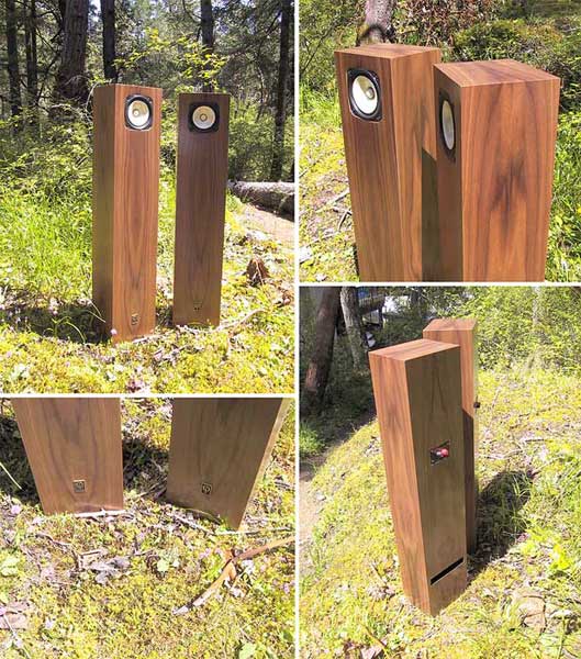

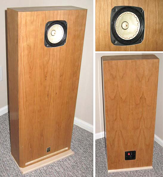

too much fonken around, and not enough building - there are several other enclosures in this particular size range that also work quite well with the FE127E - Tom Z's PAWO, and the Mileva - the latter of these the easiest build of the group.
Dave - I tried to attach one of the composite photos of the walnut towers from earlier this week - file size is too large.
Maybe you could perform some presto changeo to post either of these.
With the addition of a sub, I'd wager these would sound excellent indeed - certainly much bigger than their physical size would suggest. Visually they are certainly the opposite of any of the HGH-enhanced double mouth BVRs/horns or BIB, and granted may lack some of the scale of the big boys.
OTOH, there is the considerable advantage of easier installation - no corners or stands required, and they certainly don't take up much floor space. In my own domestic situation, the interior decorator aspect in the AV room is of primary importance.
