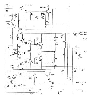

Was the load impedance and delivered power spec defined anywhere in or outside of this blog? IMHO it seems to me that the starting point of any amplifier design is the load interface specification which defines the output stage, which defines the drivers, etc. The need to deliver constant Voltage to sub 1 ohm loads at significant power leads to more serious driver problems. The idea that 8 ohms is some kind of load spec is not on the table at all. Amplifiers used in active systems without crossovers between the output and load can have significant simplification when compared to those which do battle with ugly crossover problems. WRT the TIP147, the internal resistive arrangement becomes critical and semiconductor production tolerances are amazing. These generic Darlingtons started life as motor drivers. My vote is to build any Darlington out of discretes and get full control of the resistors and full control of (not limited to 3 terminal) discharge circuit configurations. Lambda did have some very interesting Darlingtons years ago, not sure if they are still available.
global feedback and then an EF output stage.
reduces the time delay through the extra stage and reduces the effect of feedback coming in through the output terminal.
That schematic is the first time I've noticed a thyristor wrapped around the IV protection transistor.
Does the thyristor auto turn off when the signal crosses zero volts or does it stay latched on until the cap time constant expires?
Seems to be a way to avoid oscillation during the overload condition.

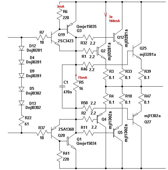

Dalington emitter folloer outputs
Have found in testing that a darlington output can actually have a real problem. The drive transistor can be turned off before the output transistor can be turned off for some reason. Only have seen this with darlington connected stage.
Perhaps one of these bright guys with a simulator can explain the exact reason for this. Darlington has lead to lots of class B crossover distortion and other stability problems. Use the same amp with drivers and outputs where the drivers are just connected to the base of the output transistors and the problems vanish. Has something to do with the darlington configuration.
in my view the integrated darlington was produced to reduce assembly costs and for no other reason.Have found in testing that a darlington output can actually have a real problem. .......... Has something to do with the darlington configuration.
It is a bad implementation of two transistors.
that's actually very well documented...the miller capacitance of the output devices is the culprit. since in a darlington the beta is beta(Q1)*beta(Q2), the miller capacitance is much larger. that's why "darlington" output stages have low resistances and speed-up capacitors between the emitters of the driver transistors in most modern amps.

I tried to compare the Bryston OPS and a double EF with spice, and got consistently lower THD with the Bryston (10 to 40%) I will admit that it wasnt easy keeping every variable accounted for so it would be nice to hear from anyone else who has tried this. I think the advantage of the bryston OPS is that your not switching from NPN to PNP devices and their different characteristics but a pair of each sharing the output current. Dont know how much that matters or if modern devices null that advantage. The disadvantage seems to be stability. The sims showed better phase margin with the EF.
Another caveat is that the Bryston stage has a diffrent distortion pattern, odd harmonics are higher than with a EF.
Lazycat a member here uses the Bryston stage but uses a mosfet as the the driver, clais very good sonics, you may want to read up a little on that topic if you interested in this bryston outputstage.
Ive tried tried it as well as the standard and still prefer the Locanthi triple stage which gives better performance than either the Bryston or the EF and has a nicer distortion pattern too.
