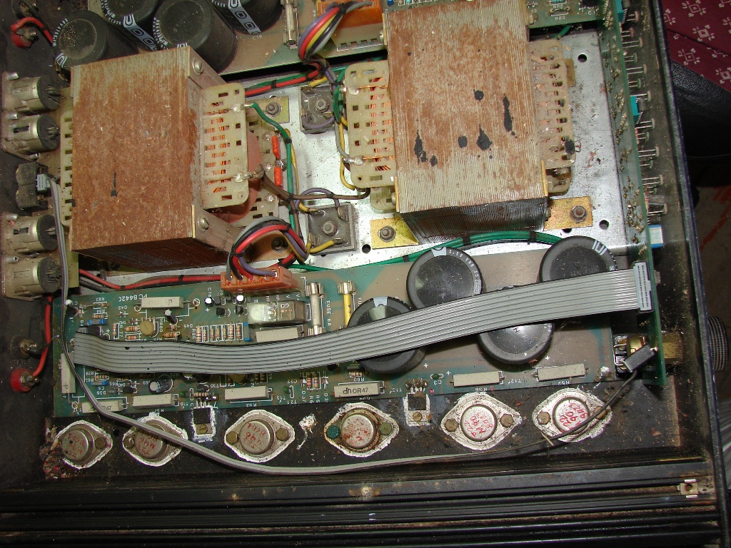

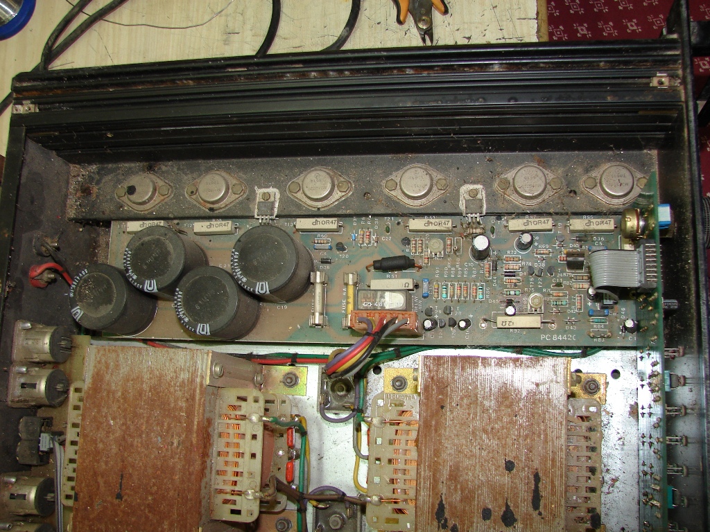

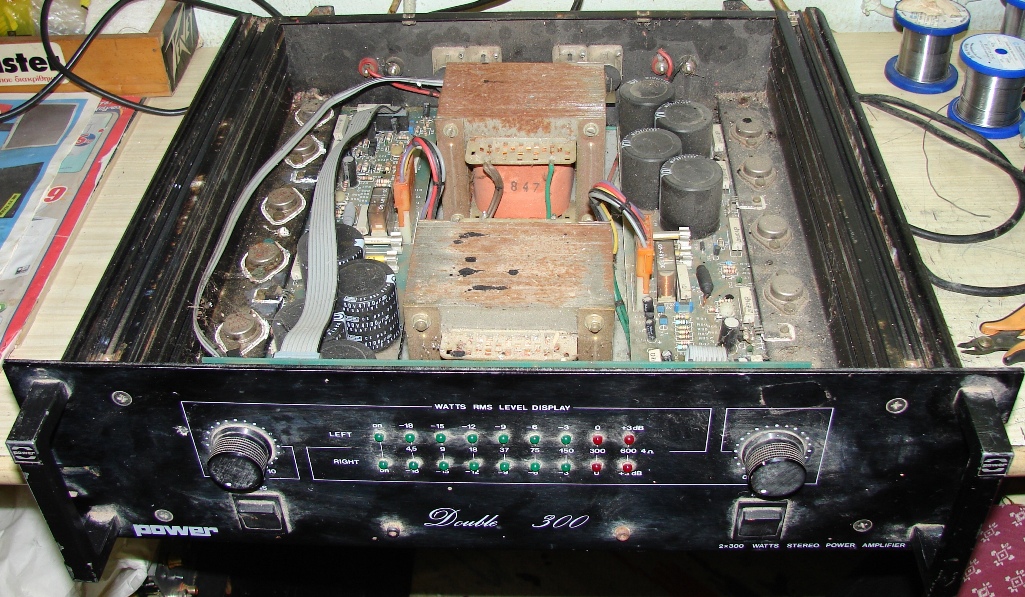

Here some pictures from an old Power Double 300
Thank you for the pics.
Such an amp in defective condition is first choise for users with the aim of evaluation, because there is much space for testing various different caps for the power supply. Also various topologies in the front end are quickly realized for testing. Ideal it would be 5-10 devices of the same amp modell in this assembly kind.
