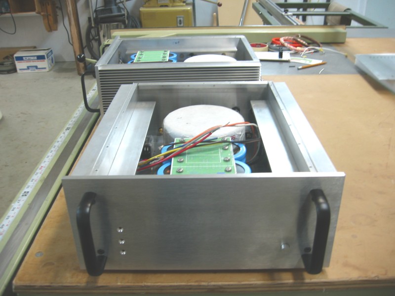

Pair of Monoblocks Under Construction
The attached photo shows a pair of monoblocks under construction. Right now only the power supply components are mounted. For this project I had the power transformers custom made by Plitron. These consist of 92VCT 625 VA devices which have been potted in a metal case. The potting serves to substantially reduce the acoustic signature the transformers. With no load, I had to press my ear against the case to hear any noise. Also, a metal case just looks nicer than a naked toroid. The transformers are rated at 625 VA at 50 or 60 Hz, which really means that at 60 Hz they should be capable of something closer to 700 VA. I'll test them once I get a large enough load resistor.
The filter cap bank consists of four 39,000 uF, 80V electrolytics. The green board on top of the caps is a mock-up made by gluing a 1x print of the PCB layout onto 1mm plywood. This method has proved very useful in ensuring that everything fits together mechanically before committing to build the PC boards.
In addition providing a convenient way of connecting the elec caps together, the board also contains ten 0.5 uf film caps across V+/Gnd and V-/Gnd. These caps should take care of any high frequency peaks the electrolytics may exhibit. High current connections are made either with ring terminals or via screw-down clamp terminal blocks. The PCB is a 2-sided design with PTH, allowing a doubling of the amount of copper in high current paths.
The aluminum angles provide a mounting surface for the ten TO3 devices per channel and also provide a mounting location for the output PCBs. The main PCB will mount vertically on the front panel, and a small PCB that controls turn-on relays, LED drive, etc. mounts on the rear panel.
Once the PC boards come back, I will finish drilling all the holes for the power devices, etc. Then all of the metal amp parts will be black anodized to match the aluminum handles.
The amplifier simulates at ~125W into 8 ohms, ~250W into 4 ohms, ~500W into 2 ohms. The amp will shut down if more than 50A peak is ever encountered, which could happen if full power were suddenly applied to a 1.25 ohm load, or if the outputs were shorted.
I'll post more information as it becomes available.

Very impressive
Hi Analog_guy,
That is a very impressive setup indeed. Am I reading correctly, you are going to use a board with TO3 outputs? If so can we have a look?
My calcs using a 92v CT transformer indicate a power output of around 175 watts into 8 ohms (losses included).

Power Amplifier Under Development
Andrew,
If the amp goes into overload, it will certainly be audible, since the overload circuit acts as a circuit breaker and turns off drive to the output stage until the amp is power cycled. I chose this method to safeguard the two hundred dollars plus per channel in output devices. BTW, most switching power supplies rely upon a similar scheme.
Transients exceeding 50 amps could be accommodated either by increasing the number of output devices or by designing the overload sense circuit to more accurately take into account the transient overload tolerance of the output transistors. Adding more output devices is certainly a possibility, but incurs a capacitance penalty. I plan on using the BUZ901D/906D devices. They are rated at 16 amps per device continuous. (The output stage consists of four paralleled devices plus one BUZ901/906 acting as a predriver source follower.) Why 50 amps instead of 4x16=64? Because the overcurrent circuit has some built in tolerance, and I am a conservative designer by nature. If I could get transient overcurrent data from the manufacturer then I could tailor the overcurrent circuit to permit short term overcurrents exceeding the continuous current limit.
Regards.
Jeff
Yes, PC boards can actually carry a good deal of current based on the cross sectional area of the copper foil. For example, PC motherboards have on-board power regulators that deliver over 100A continuous at 1.5V to the CPU, and they use 1.0 Oz. copper. These boards are 2.0 Oz. copper, which is equivalent to approx 3 mils in thickness. Remember also that the continuous current is limited by the transformer to approx 7 amps.
By virtue of their fixed mechanical geometry, PC boards have the advantage of providing predictable values for such parameters as gate-drain coupling. For MOSFETs this is a key parameter bacause it affects high frequency stability. This is not the case for point-point wiring unless coax is used.
Once I get the boards designed, I'll post a layout.
Regarding the power output numbers, you are correct in your calculations regarding the max output power. However the power numbers I quoted are for distortion values at least 110 dB below the output level (20 Hz - 20 KHz). The last 20 percent of the supply voltage is where amplifiers start to see distortion increase.
Jeff
